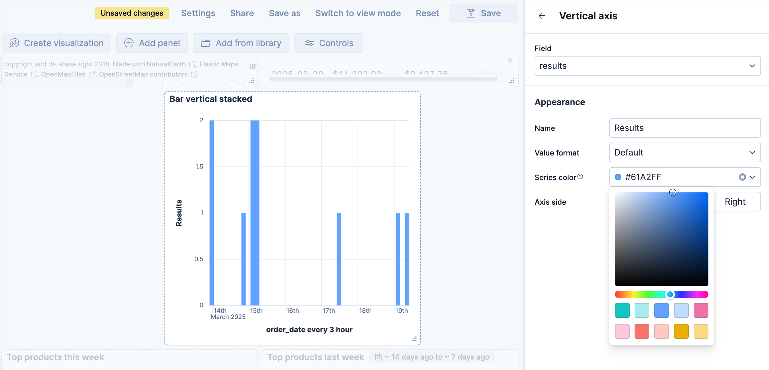

When editing an ES|QL visualization, you can customize the appearance of the chart. To do that:
  1. Click one of the fields representing an axis of the chart to open its details.
    Click on the axis field to open its details
  2. Define the appearance of your choice from the available options.
    Appearance customization options for ESQL charts
  3. Return to the previous menu, then Apply and close the configuration to save your changes.
