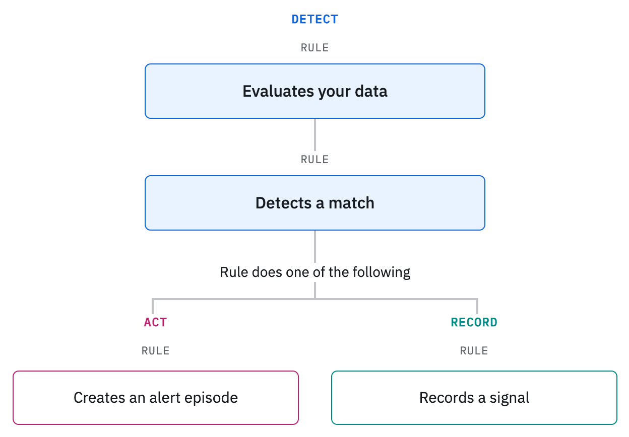

A rule defines what to watch for in your data and how often to check. Every rule runs in one of two modes: alert or signal.
  • Alert - Opens an alert episode when the rule finds a match and closes it when the condition clears, notifying your team at each episode state change. Helpful when you want to follow a problem from first detection to resolution.
  • Signal - Records rule query results over time without opening episodes or sending notifications. Helps you build a baseline, spot trends, or collect evidence before deciding whether something is worth alerting on.

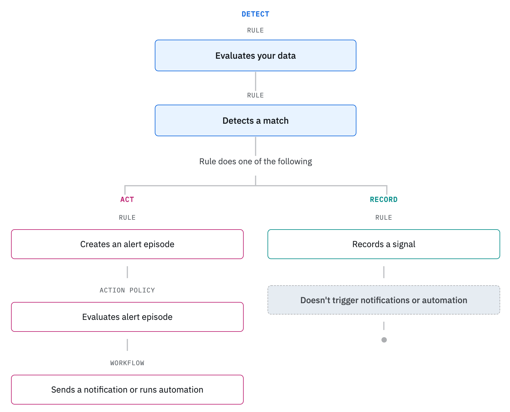

At the simplest level:
  1. A rule checks your data on a schedule.
  2. The rule's query returns results when data matching its conditions is found.
  3. The rule's mode determines what happens next:
    • Alert - The rule opens an alert episode to track the problem. An action policy can route it to a workflow to perform an action or send a notification.
    • Signal - Each result is recorded for querying later. Nothing else happens.
