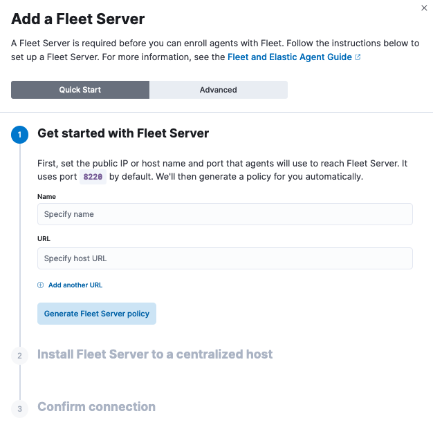

Click the Agents tab and follow the in-product instructions to add a Fleet server:
Notes:
- Make sure you download an x64 architecture installation package.
- For the agent policy, choose one with a Fleet Server integration, or click Create policy to create one now. Alternatively you can create a Fleet Server policy without using the UI, then select the policy here.
- If you choose Production deployment mode, learn how to generate certs in Configure SSL/TLS for self-managed Fleet Servers.

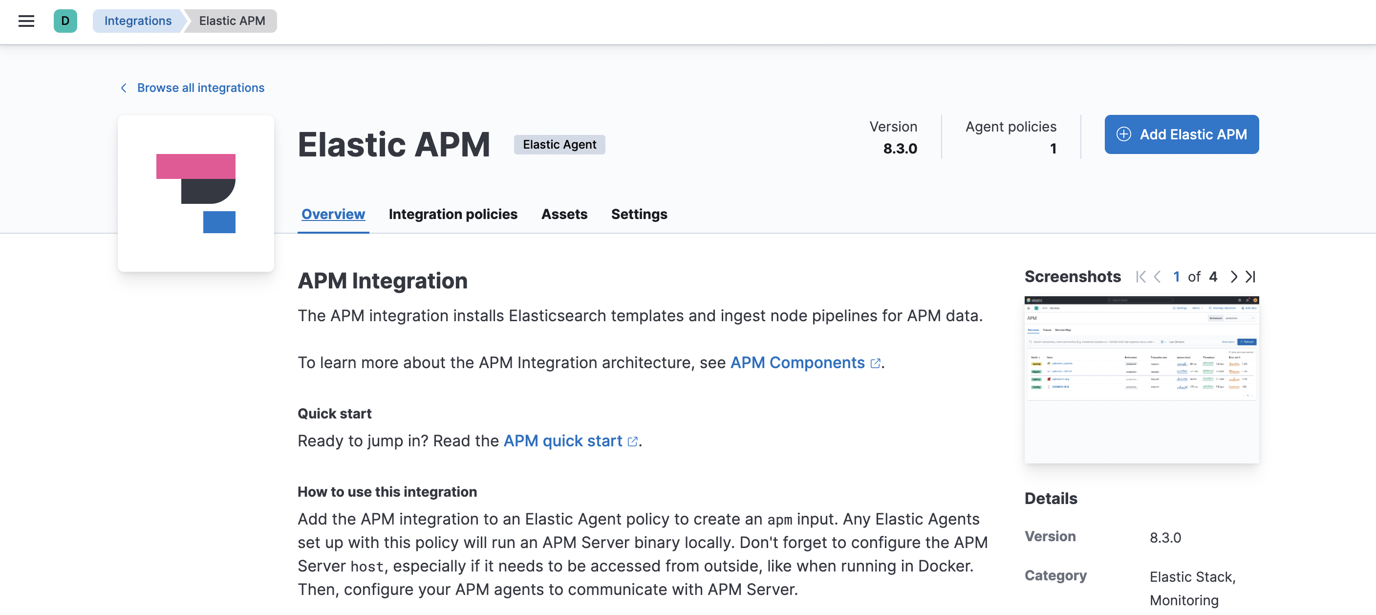

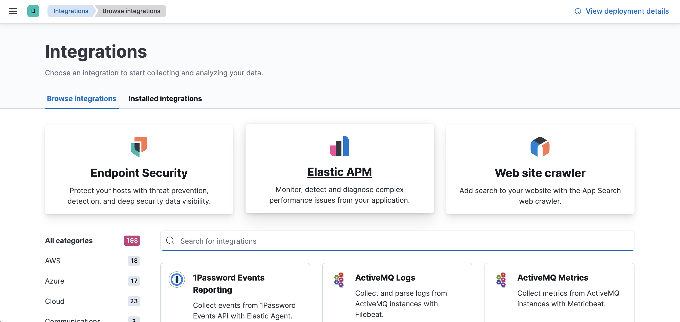

In Kibana, select Add integrations > Elastic APM.
Click Manage APM integration in Fleet.
On the Elastic APM page, select the Elastic Cloud agent policy.
As you can see, the APM integration has been added to the Elastic Cloud agent policy. This is the default policy for Elastic Agents hosted on Elastic Cloud. In the Elastic APM row of the table, in the Actions column, select Edit integration to configure the APM integration.
- Make a note of the predefined Host and URL that the APM Server is listening on—you’ll need these in the next step. If you made any changes to your configuration, click save and continue.
Click Add Elastic APM.

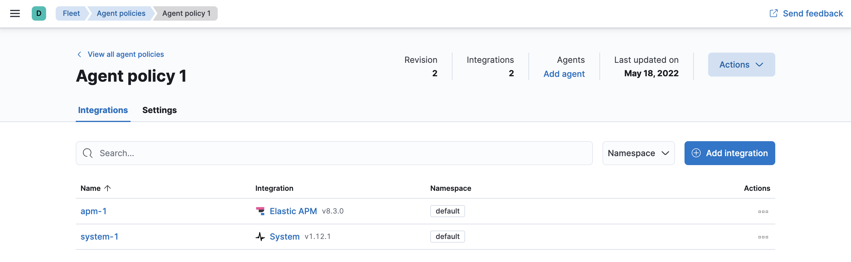

To see the updated policy, click the Default policy link.
The newly added APM integration should appear under Fleet > Agent policies > Default policy, along with the default System integration.
All Elastic Agents that use this policy will collect APM data from your instrumented services.
