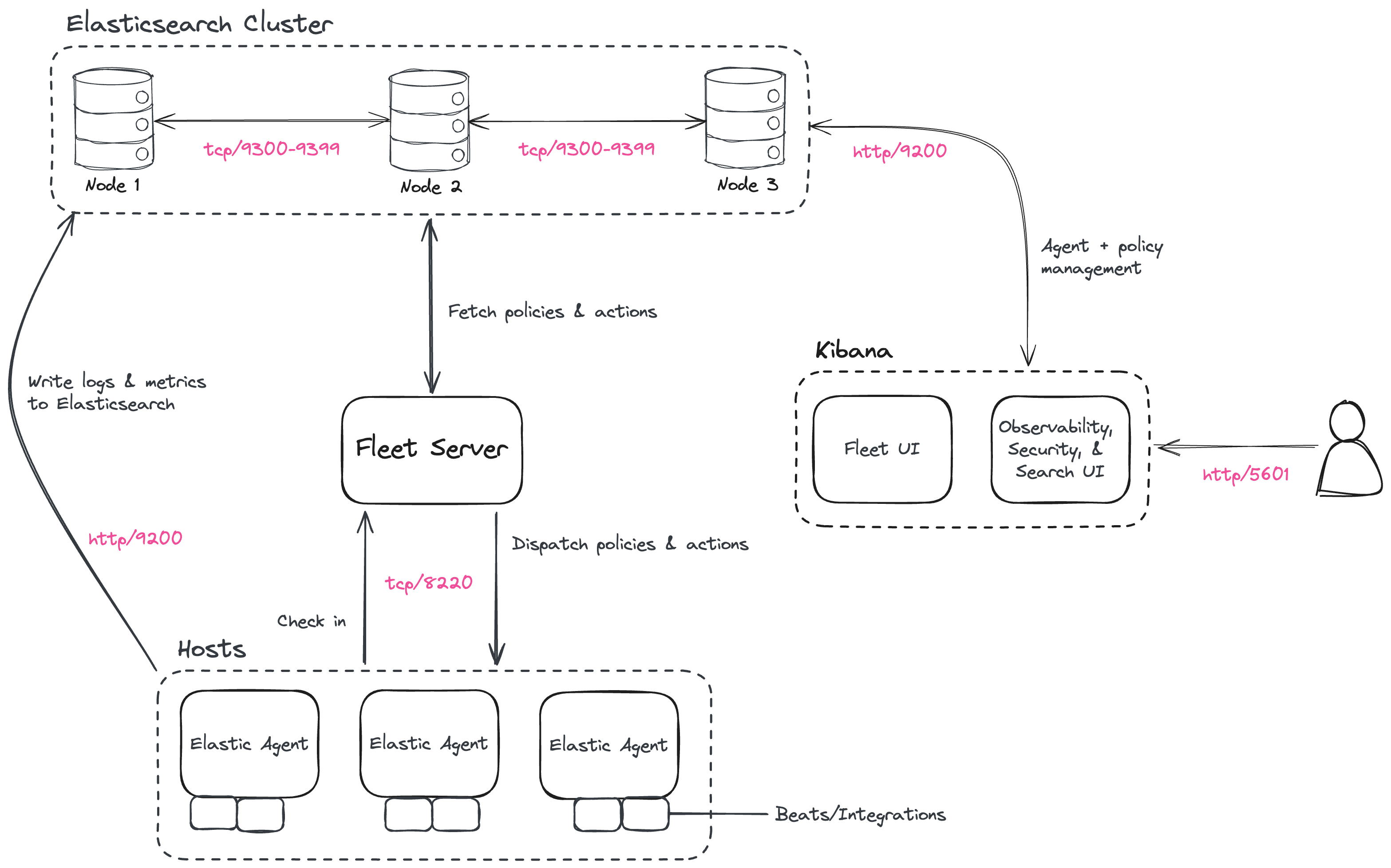

For the basic ports and protocols required for the installation to work, refer to the following overview section.

The examples in this tutorial use the following host addresses:
Component Example host name Example IP address
Elasticsearch node 1 es-node1 203.0.113.21
Elasticsearch node 2 es-node2 203.0.113.22
Elasticsearch node 3 es-node3 203.0.113.23
Kibana kibana-host 203.0.113.31
Fleet Server fleet-server-host 203.0.113.41
These are documentation-only example addresses. Replace them with the values from your environment.

You've successfully set up a three-node Elasticsearch cluster, with Kibana, Fleet Server, and Elastic Agent.
Now that you've successfully configured an on-premises Elastic Stack, you can learn how to customize the certificate configuration for the Elastic Stack in a production environment using trusted CA-signed certificates. Refer to Customize TLS certificates for a self-managed Elastic Stack to learn more.
You can also start using your newly set up Elastic Stack right away:
  • Do you have data ready to ingest? Learn how to bring your data to Elastic.
