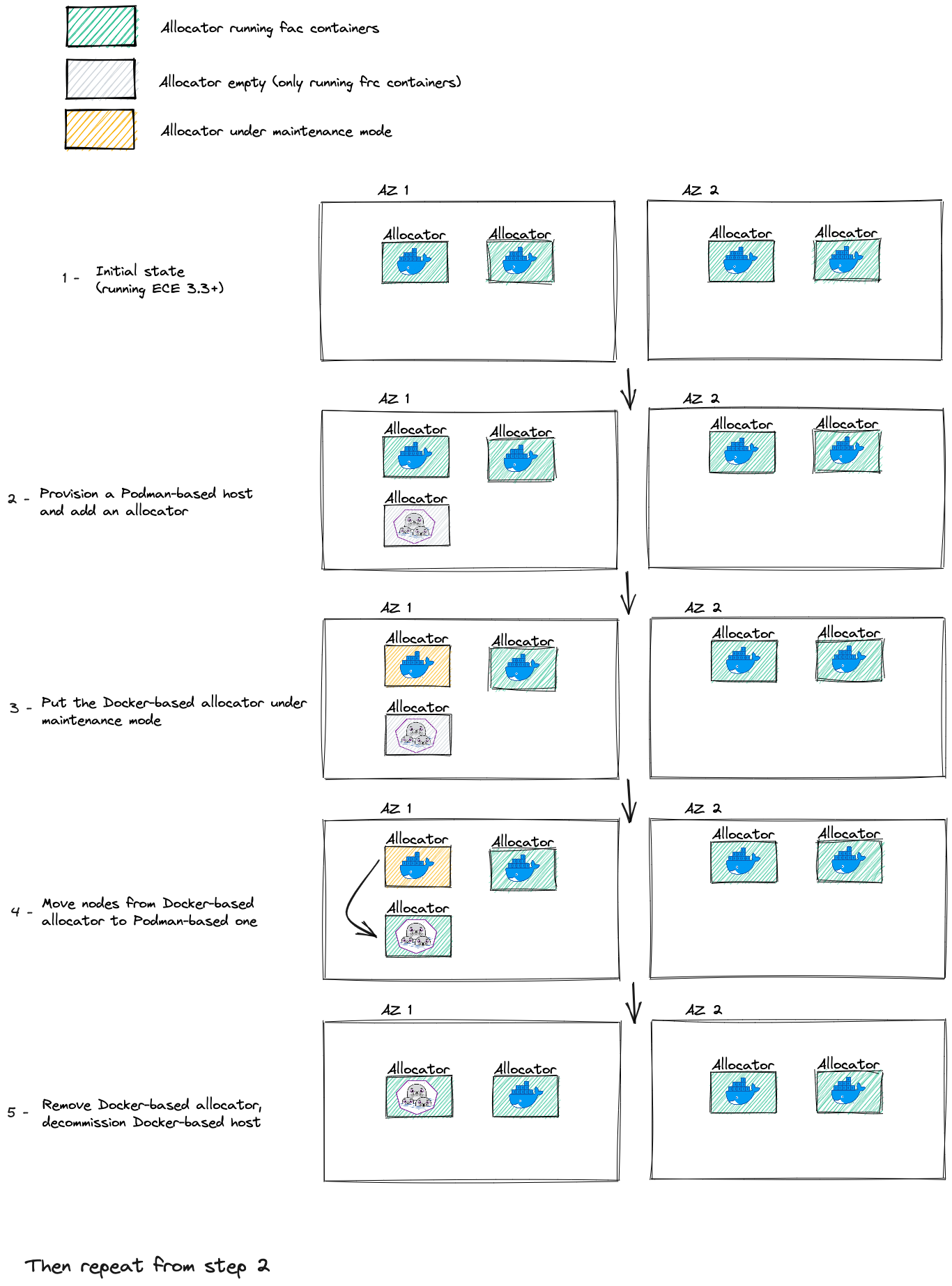

This section provides guidelines and recommendations for migrating an existing platform to a Podman-based environment. You have an existing ECE installation version >=3.0 and want to migrate all hosts to use Podman as a container runtime. The recommended approach consists of three (3) high-level steps.
Step 1: Upgrade ECE to version >= 3.3.0 following the Upgrade your installation guidelines. Skip this step if your ECE installation is already running a version >= 3.3.0.
Step 2: Prepare an additional RHEL or Rocky Linux VM. We recommend using one additional VM to perform a rolling grow-and-shrink upgrade.
Step 3: Migrate each host one by one from Docker to Podman. This allows you to move workloads from Docker-based hosts to Podman-based ones without downtime. We highly recommend to allocate the additional Podman allocator to the same zone as the Docker allocator you want to replace. Assuming there is sufficient capacity, you may use existing docker-based hosts as the "new" Podman-based hosts. To reuse a host, you will first follow the steps to delete a host from the ECE deployment followed by the steps to remove ECE software from the host. The following diagram shows the conceptual steps.

  1. Make sure you are running a healthy x-node ECE environment ready to be upgraded. All nodes use the Docker container runtime.
  2. Upgrade to ECE 3.3.0+ following the Upgrade your installation guideline. Skip this step if your existing ECE installation already runs ECE >= 3.3.0.
  3. Follow your internal guidelines to add an additional vanilla RHEL (Note that the version must be >= 8.5, but <9), or Rocky Linux 8 or 9 VM to your environment.
  4. Verify that required traffic from the host added in step 3 is allowed to the primary ECE VM(s). Check the Networking prerequisites and Google Cloud Platform (GCP) guidelines for a list of ports that need to be open. The technical configuration highly depends on the underlying infrastructure.
    Example For AWS, allowing traffic between hosts is implemented using security groups.

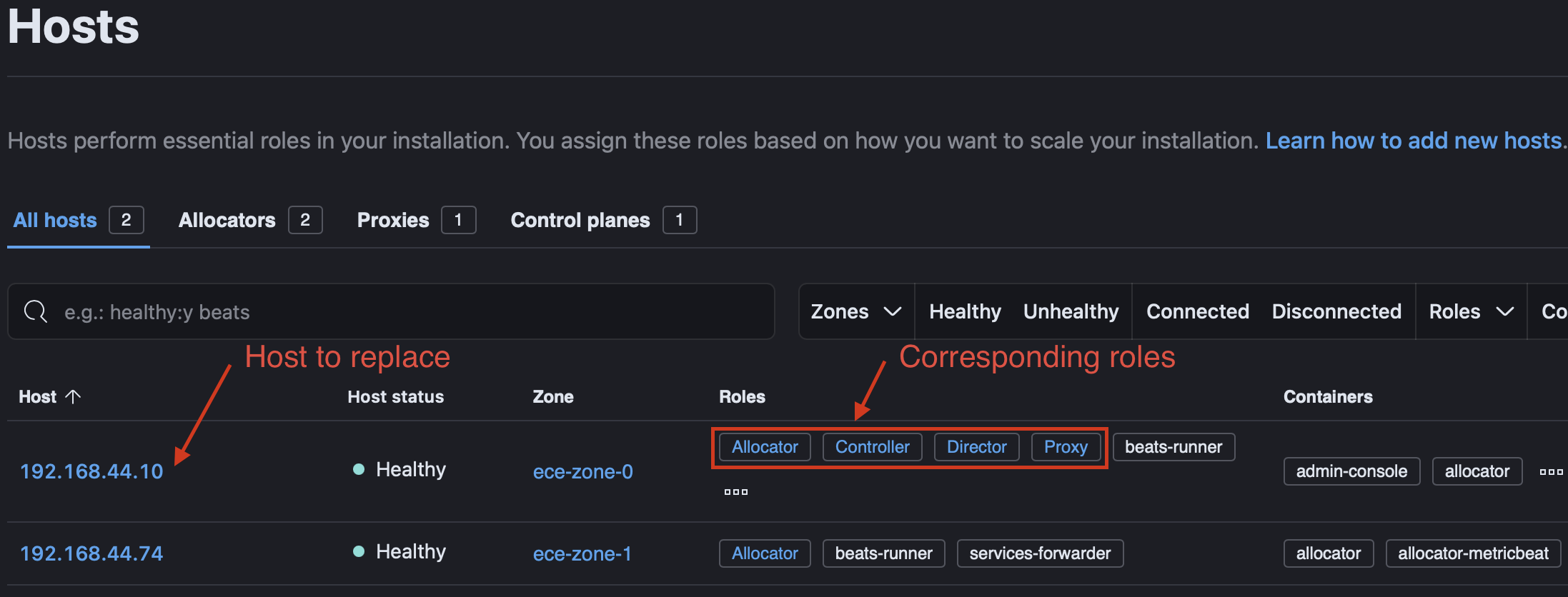

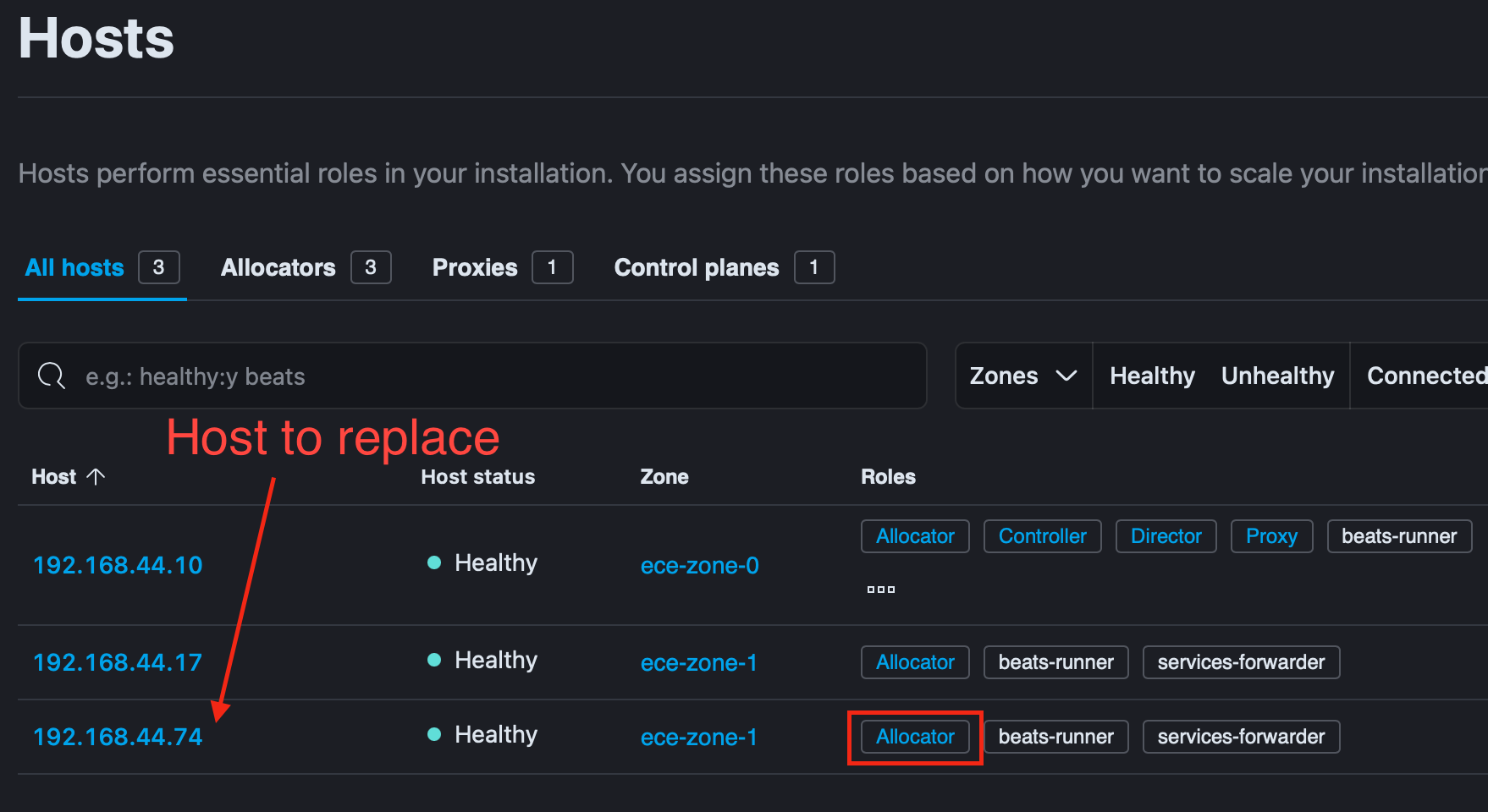

  5. Identify the host you want to replace with a podman-based host and copy the associated roles.
    Example 1 You want to migrate the Docker host 192.168.44.74 with the role Allocator to a podman host. Copy the role allocator.
    Migrate Allocator
    Example 2 You want to migrate the Docker host 192.168.44.10 with the roles Allocator, Controller, Director, and Proxy to a podman host. Copy the roles allocator, coordinator, director, proxy.
    Migrate Allocator
    Important
    The role Controller in the admin console is called coordinator for the elastic-cloud-enterprise.sh script

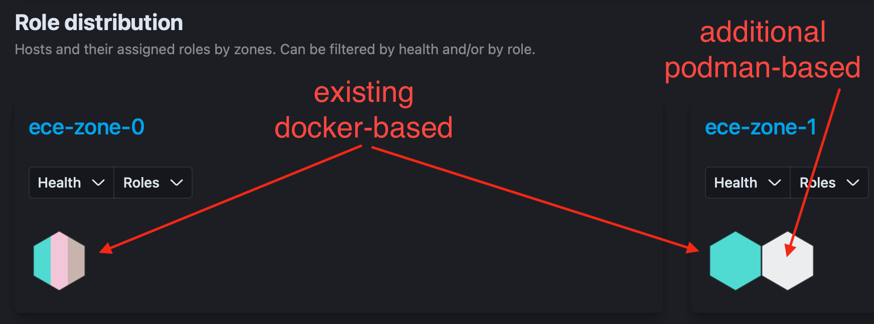

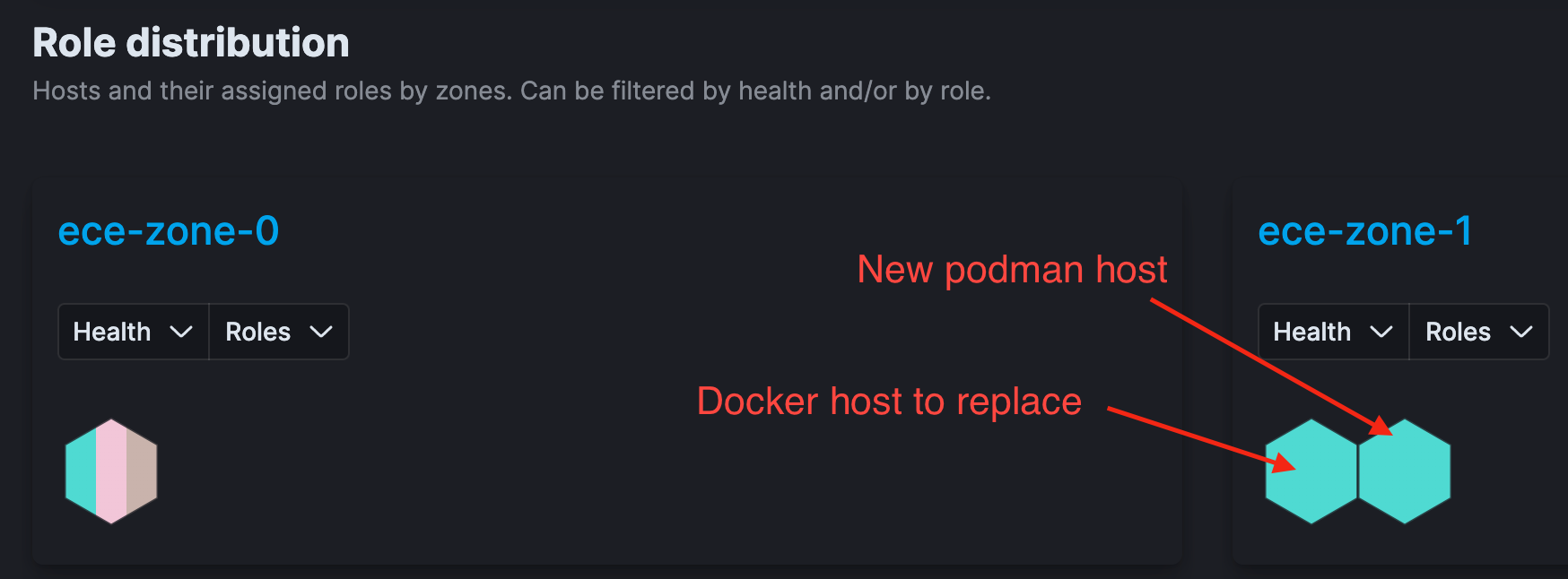

    1. Use the ECE installer script together with the --podman flag to add the additional host as a podman-based host.
      Refer to the official Install Elastic Cloud Enterprise on an additional host and Install ECE online documentation to adapt the command line parameters to your environment including fetching the role token.
      JVM heap sizes describes recommended JVM options.
      Important while running ./elastic-cloud-enterprise.sh
      • Make sure you use --podman on the podman host.
      • Make sure you use --selinux on the Podman host if SELinux runs in enforcing mode.
      • To fetch a role token following the Generate Roles Tokens guidelines, you need to send a JSON token to the admin console. Double check the correct format of the roles. Roles are a list of individual strings in quotes, NOT a single string.
        For example 1, the JSON object is as follows:
        '{ "persistent": true, "roles": [ "allocator" ] }'
        For example 2, the JSON object is as follows:
        '{ "persistent": true, "roles": [ "allocator","coordinator","director","proxy" ] }'
      • The ECE version of the additional host must be the same as the version used in step 2. Use --cloud-enterprise-version VERSION_NAME to specify the correct version.
      • To easily identify the podman allocator, apply a tag to the additional host, for example containerengine:podman. The podman allocator is needed as the “target allocator” when you later move instances from the Docker allocator to the podman allocator. For example, use --allocator-tags containerengine:podman.
      • Make sure to apply the roles as copied in step 5 to the additional host. The value for the --roles flag is a single string.
        For example 1 in step 4, use --roles "allocator"
        For example 2 in step 4, use --roles "allocator,coordinator,director,proxy"
      • Add the new host to the same availability zone as the Docker host you want to replace. Use the --availability-zone <zone> flag.
    2. Login to admin console
      Verify that the new podman host has the same roles (same coloring of the hexagon) as the Docker host you want to replace.
      The following screenshot shows the state where the correct roles have been applied. Both hosts in ece-zone-1 have the same color.
      Correct role
      The following screenshot shows the state where incorrect roles have been applied. The hosts in ece-zone-1 do not have the same coloring.

    3. Put the docker-based allocator you want to replace with a podman allocator in maintenance mode by following the Enable Maintenance Mode documentation.
      As an alternative, use the Start maintenance mode API.

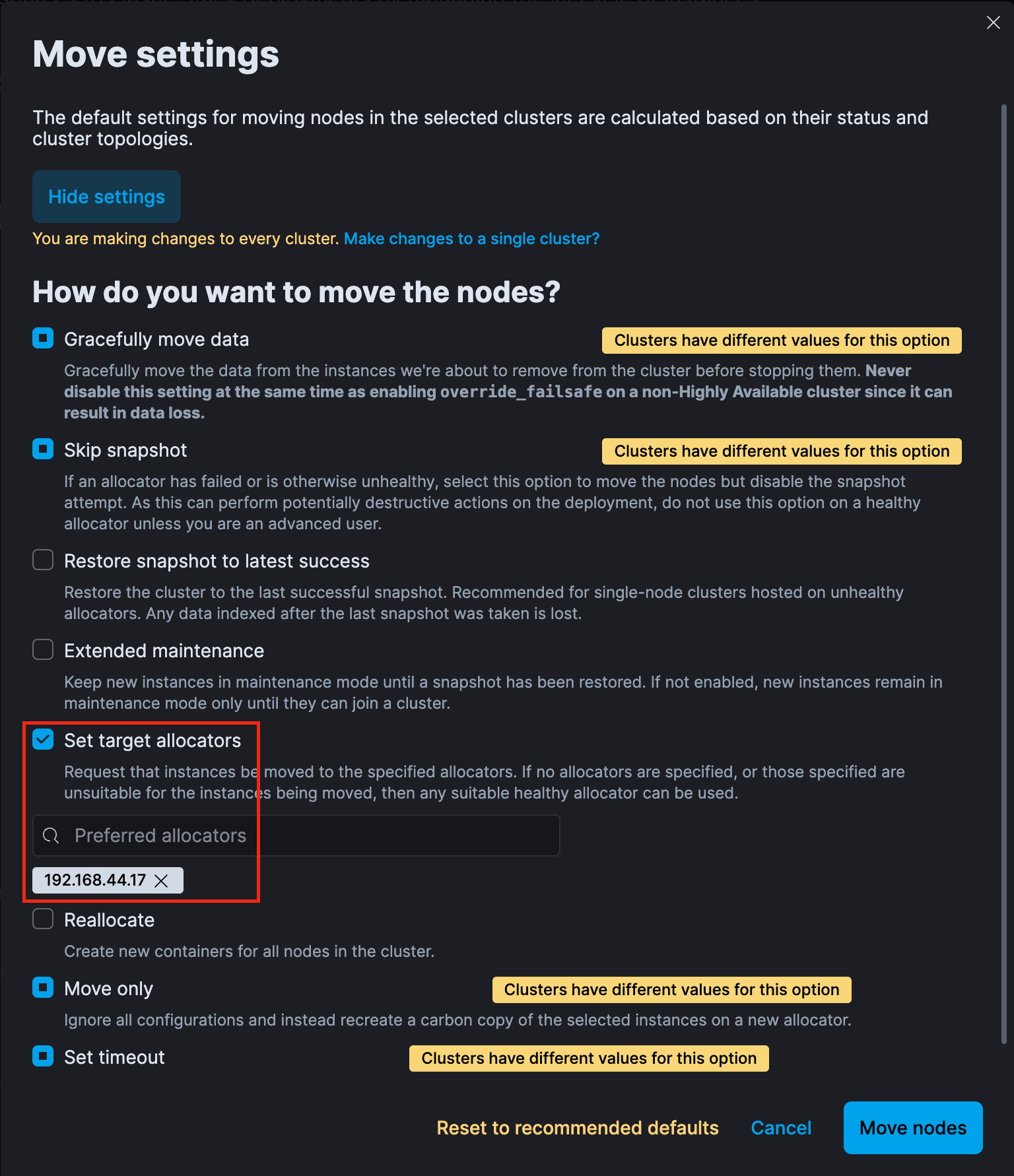

    4. Move all instances from the Docker allocator to the podman allocator by following the Move Nodes From Allocators documentation.
      Important
      Make sure to specify the target podman allocator using the option “Set target allocators”.
      Important
      If you move admin console instances, you might update the URL in the browser before continuing with step 11.
      Move instances
      As an alternative, use the Move clusters API.

    5. Remove the Docker allocator by following the Delete Hosts guidelines.
    As an alternative, use the Delete Runner API.
