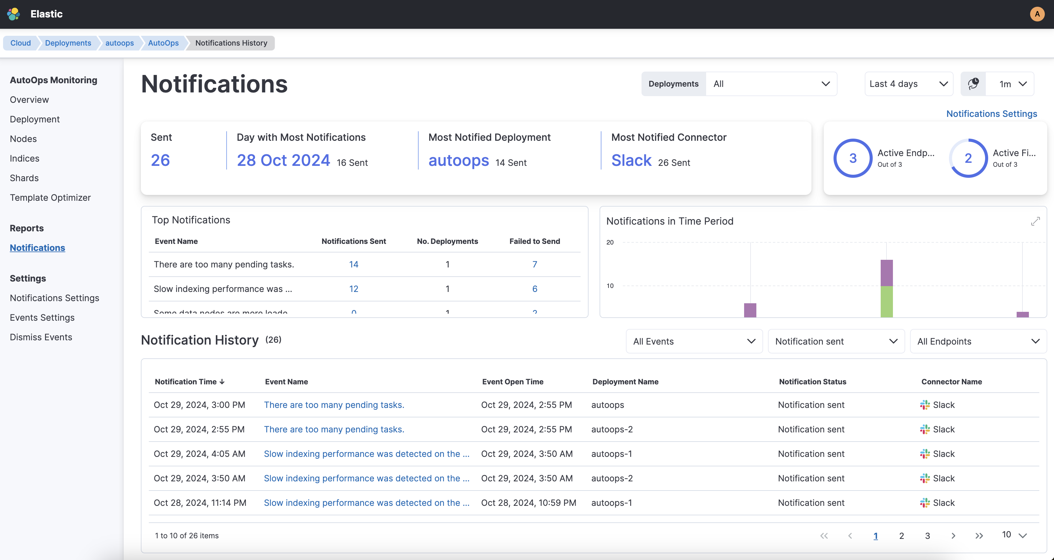

From the Notifications report, you can review all of the notifications that have been sent by AutoOps. The report lists all the events that were set up in the notification filters and their status.
The notification can have one of the following statuses:
- Notification sent
- Connector not defined
- Notification muted
- Sending notification
- Notification failed to send
- Event closed before notification sent

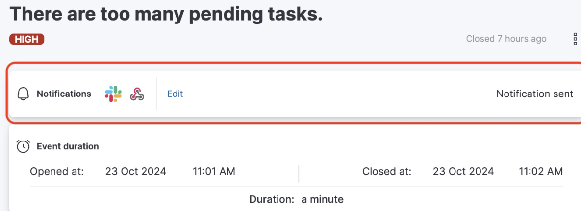

The notification status for each event is also shown in the flyout when you select an event on the Deployment or Cluster page.
