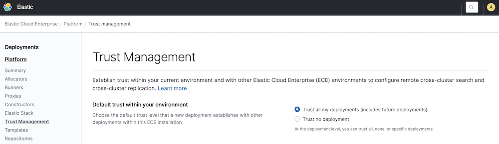

By default, any deployment that you or your users create trusts all other deployments in the same Elastic Cloud Enterprise environment. You can change this behavior in the Cloud UI under Platform → Trust Management, so that when a new deployment is created it does not automatically trust any other deployment. You can choose one of the following options:
- Trust all my deployments - All of your organization’s deployments created while this option is selected already trust each other. If you keep this option, that includes any deployments you’ll create in the future. You can directly jump to Connect to the remote cluster to finalize the CCS or CCR configuration.
- Trust no deployment - New deployments won’t trust any other deployment when they are created. You can instead configure trust individually for each of them in their security settings, as described in the next section.
- The level of trust of existing deployments is not modified when you change this setting. You must instead update the trust settings individually for each deployment you wish to change.
- Deployments created before Elastic Cloud Enterprise version
2.9.0trust only themselves. You have to update the trust setting for each deployment that you want to either use as a remote cluster or configure to work with a remote cluster.

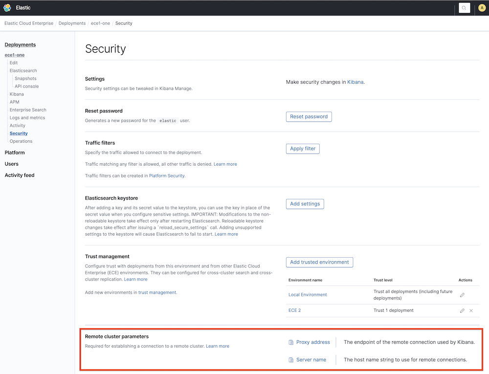

In Add connection information, fill in the following fields:
Remote cluster name: This cluster alias is a unique identifier that represents the connection to the remote cluster and is used to distinguish local and remote indices.
When using API key authentication, this alias must match the Remote cluster name you configured when adding the API key in the Cloud UI.
Remote address: This value can be found on the Security page of the Elastic Cloud Enterprise deployment you want to use as a remote. Copy the Proxy address from the Remote cluster parameters section.
NoteIf you’re using API keys as security model, change the port to
9443.Configure advanced options (optional): Expand this section if you need to customize additional settings.
TLS server name: Specify a value if the certificate presented by the remote cluster is signed for a different name than the remote address.
This value can be found on the Security page of the Elastic Cloud Enterprise deployment you want to use as a remote. Copy the Server name from the Remote cluster parameters section.

proxyproxy_address: This value can be found on the Security page of the Elastic Cloud Enterprise deployment you want to use as a remote. Copy the Proxy address from the Remote cluster parameters section.
Using the API, this value can be obtained from the Elasticsearch resource info, concatenating the field
metadata.endpointand port9400using a semicolon.NoteIf you’re using API keys as security model, change the port to
9443.server_name: This value can be found on the Security page of the Elastic Cloud Enterprise deployment you want to use as a remote. Copy the Server name from the Remote cluster parameters section.
Using the API, this can be obtained from the Elasticsearch resource info field
metadata.endpoint.
