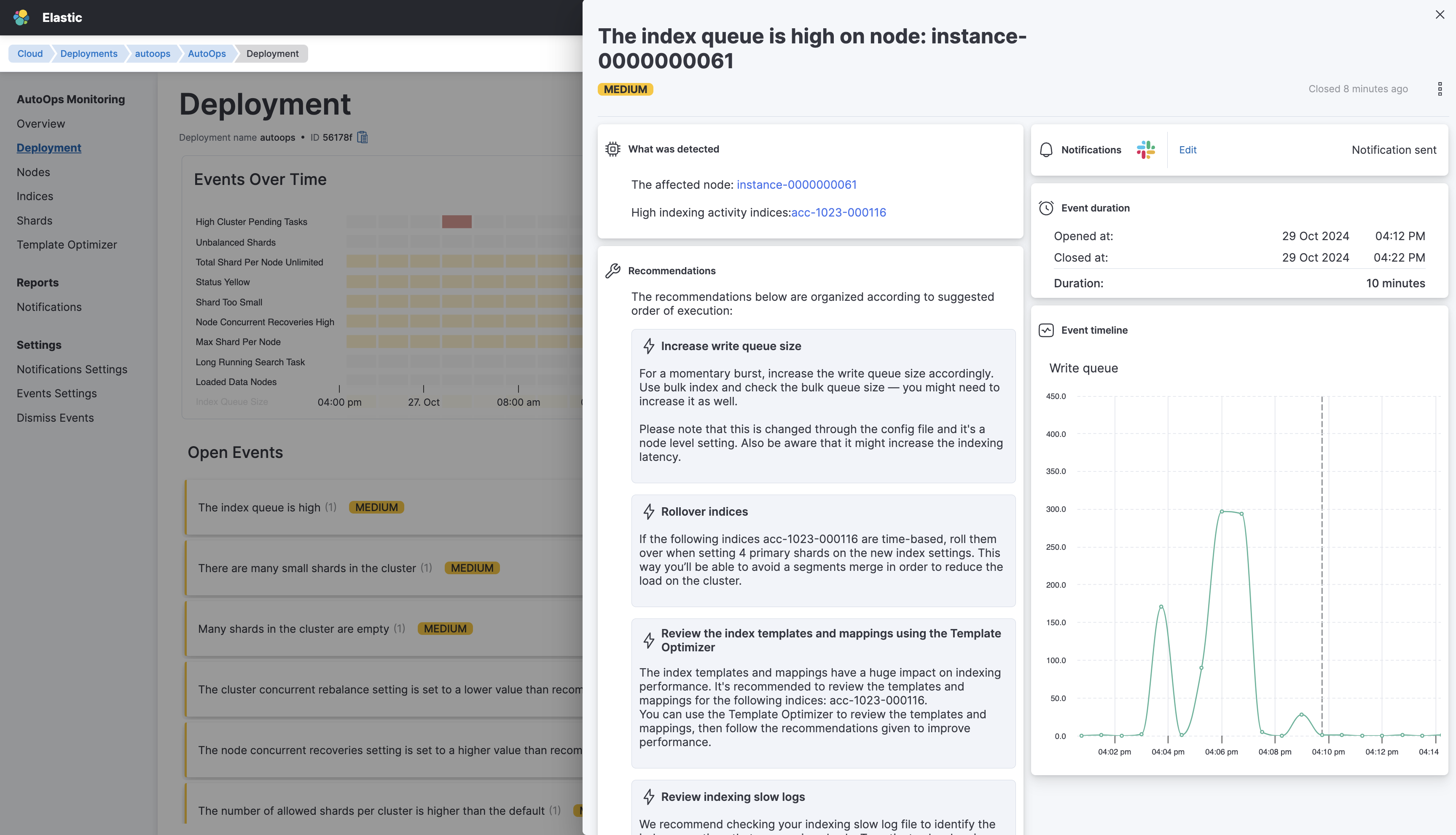

When you select an event, a flyout displays details about the detected issue and actions you can take.
Screenshot showing an AutoOps event flyout
The following table describes the information presented in this flyout:
Section Description
Event severity Categorizes the event into one of four severity levels based on its potential impact on the cluster:
Critical: Immediate threat to cluster functionality. Urgent intervention is required to restore or maintain core operations.
High: Immediate, significant degradation to usability, performance, or stability.
Medium: Potential risk to the cluster. Won't cause immediate disruption but can escalate into severe problems if left unaddressed.
Low: Minor anomalies with minimal operational impact and no threat to cluster stability.
Notification status Indicates whether a notification was sent for the event. Click on the badge to view active connectors or edit notification settings.
Event timestamps Show when the event was opened (when AutoOps detected the issue), and if applicable, when the event was closed (when AutoOps identified that the issue no longer exists). A closed event doesn't necessarily mean that the issue is resolved, rather that AutoOps no longer detects it.
What was detected Describes why the event was created and provides links to drill down into the detected issue.
Event timeline Visually presents metrics related to the issue in the last 15 minutes. This chart appears only for events with dynamic metrics. For example, load issues will have this section, but settings-related issues will not.
Recommendations Lists recommendations to address the issue and improve your cluster's overall performance. The recommendations are organized according to the suggested order of execution.
Background and impact Provides background and context about why the event is important and its potential impact on cluster performance and stability.
