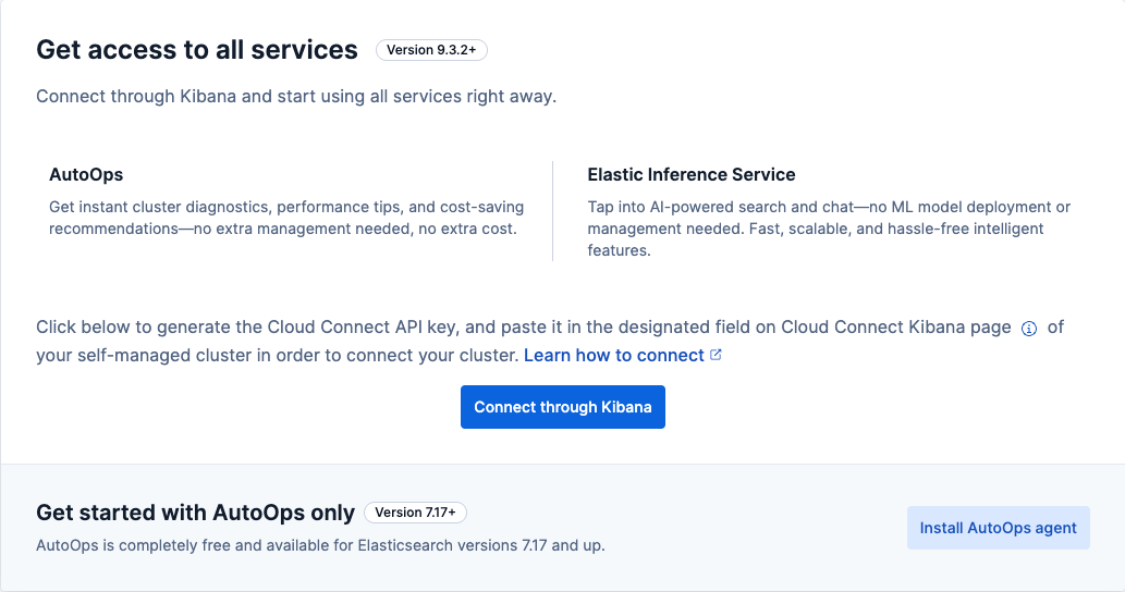

The following steps describe how to connect your cluster to AutoOps.
If you already have an Elastic Cloud account:
  1. Log in to Elastic Cloud.
    • The link provided should take you directly to the Connect your self-managed cluster page
  2. On your home page, in the Connected clusters section, select Connect self-managed cluster.
  3. On the Connect your self-managed cluster page, in the AutoOps section, select Connect.
  4. Go through the installation wizard as detailed in the following sections.

This is the first step of the installation wizard. Your cluster ships metrics to AutoOps with the help of Elastic Agent.
Select one of the following methods to install Elastic Agent:
