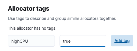

  3. Select one of the hosts, and under the Allocator tab locate the Allocator tags section.
    Narrow the list by name, ID, or choose from several other filters. To further define the list, use a combination of filters.
  4. Enter values into the Key and Value fields, and then select Add tag. For example: You could add SSD: true and highCPU: true tags from our example tags if your allocator meets these criteria.
    Adding key-value pairs as an allocator tags
  5. Repeat the previous step until you have added all of the tags that you want to use to characterize the hardware of this allocator.
