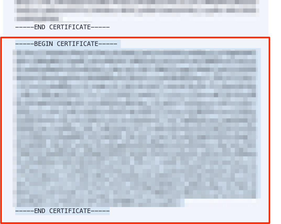

Before configuring the local deployment, retrieve the CA certificate of the remote ECE proxy. To find this certificate:
In the remote ECE environment, go to Platform → Settings → TLS certificates.
Select Show certificate chain under Proxy.
Click Copy root certificate and paste it into a new file. The root certificate is the last certificate shown in the chain.
Save the file as
.crt.
