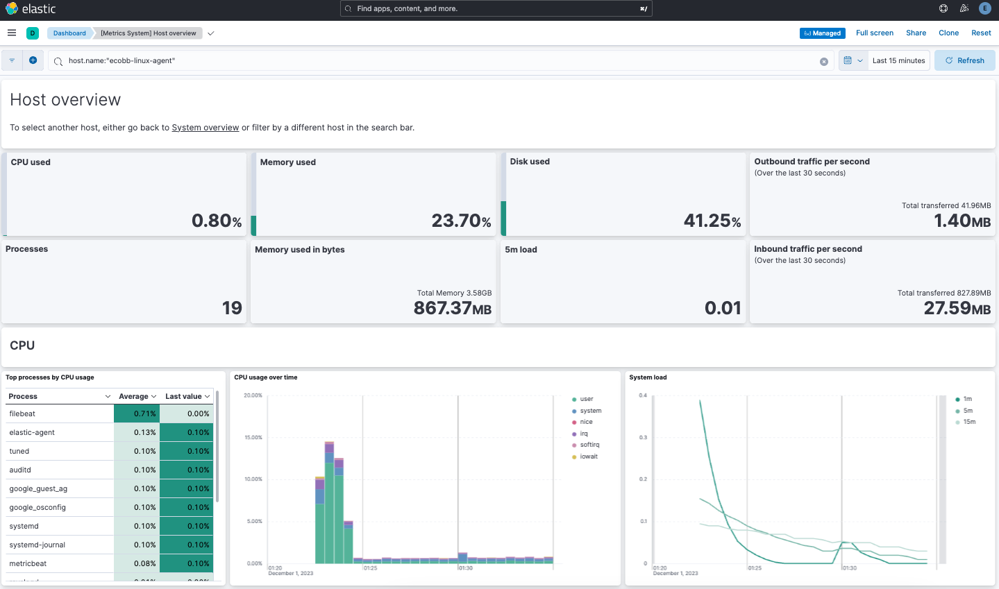

View your system metrics data:
  1. Open the Kibana menu and return to Analytics -> Dashboard.
  2. In the query field, search for Metrics System.
  3. Select the [Metrics System] Host overview link. The Kibana Dashboard opens with visualizations of host metrics including CPU usage, memory usage, running processes, and others.
Sample Kibana dashboard
Congratulations! You've successfully configured security for Elasticsearch, Kibana, Fleet, and Elastic Agent using your own trusted CA-signed certificates.
