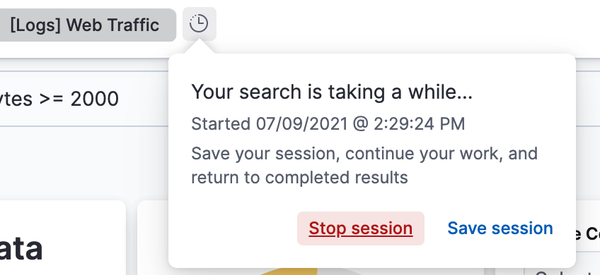

Load your dashboard.
Your search session begins automatically. The icon after the dashboard title displays the current state of the search session. A clock icon indicates the search session is in progress. A checkmark indicates that the search session is complete.
To continue a search in the background, click the clock icon, and then click Save session.
Once you save a search session, you can start a new search, navigate to a different application, or close the browser.

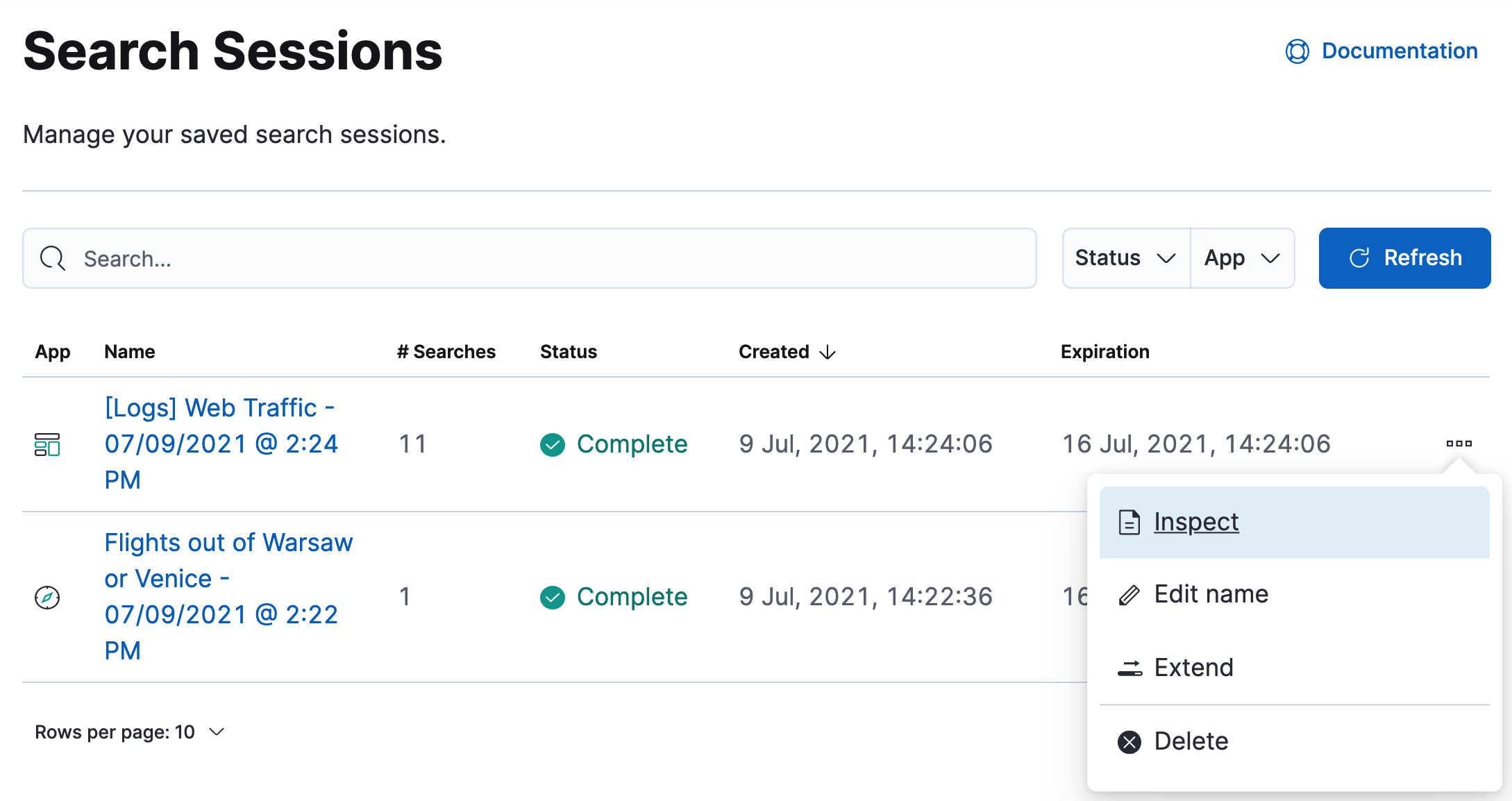

To view your saved searches, open the main menu, and then click Stack Management > Search Sessions. For a saved or completed session, you can also open this view from the search sessions popup.
Use the edit menu in Search Sessions to:
- Inspect the queries and filters that makeup the session.
- Edit the name of a session.
- Extend the expiration of a completed session.
- Delete a session.
To restore a search session, click its name in the Search Sessions view.
