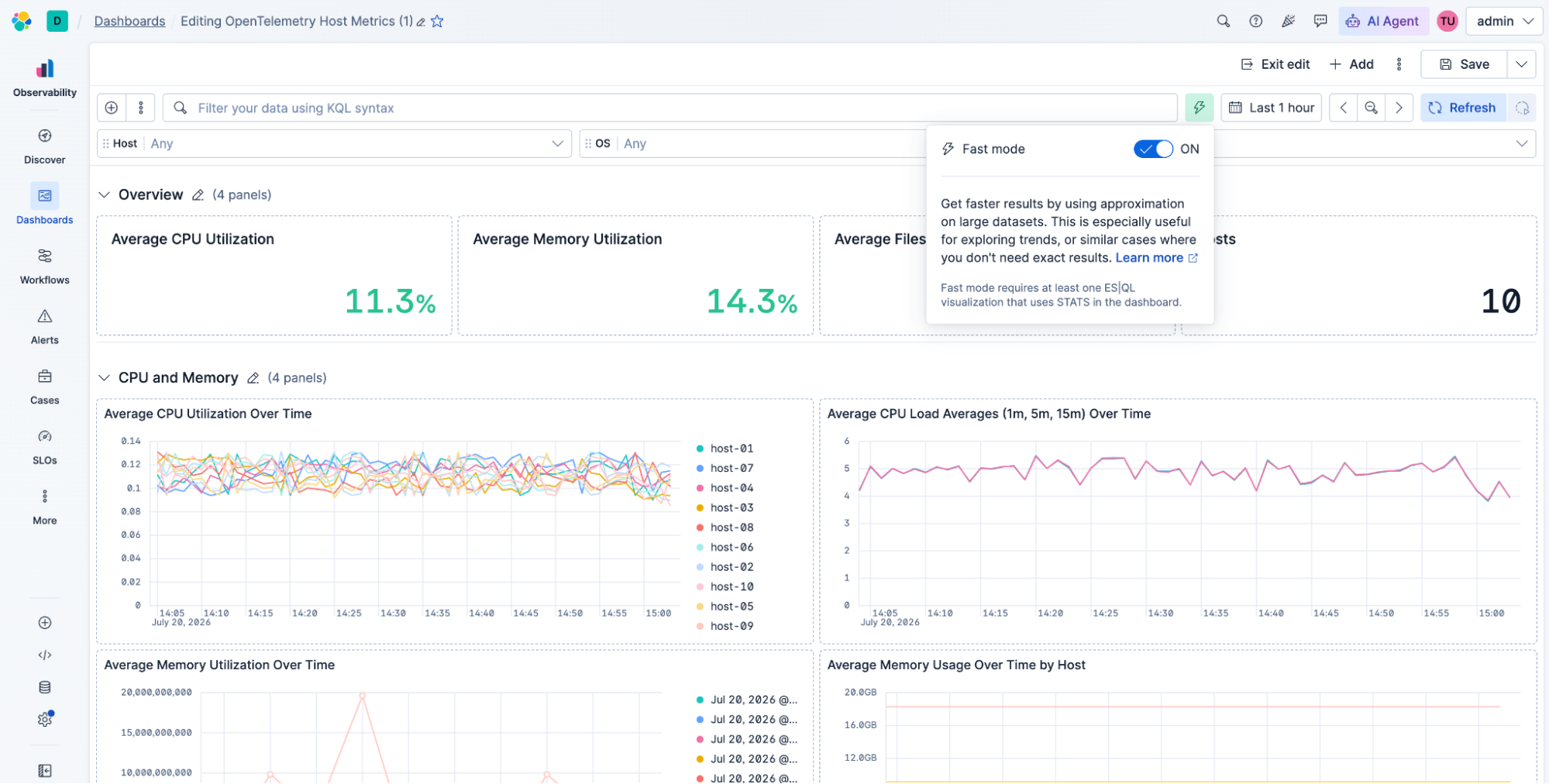

Elastic Search 9.4 introduced approximate ES|QL queries as a syntax-only command in technical preview. Now, 9.5 makes approximation GA and adds Fast mode, a UI toggle in Dashboards and Discover that enables approximate ES|QL STATS queries without writing any query syntax. This makes Kibana one of the first tools to offer smart sampling with automatic extrapolation as a simple switch.
Fast mode is an Enterprise-only feature and is off by default. Dashboard authors can save their preferred state with the dashboard, and individual queries can override the toggle with SET approximation=true or false inline.
When switched on, ES|QL STATS queries target a fixed sample size (defaulting to 1,000,000 rows for grouped aggregations and 100,000 rows otherwise) rather than scanning the full dataset. Benchmarks show heavy aggregations running up to 100x faster on large datasets, with results that are typically highly accurate, defaulting to a 90% confidence interval. Approximation only applies to STATS commands where results can remain accurate. When accuracy cannot be ensured (such as with small datasets or aggregations like MAX, MIN, or COUNT_DISTINCT), Kibana automatically falls back to exact execution, even with Fast mode enabled.

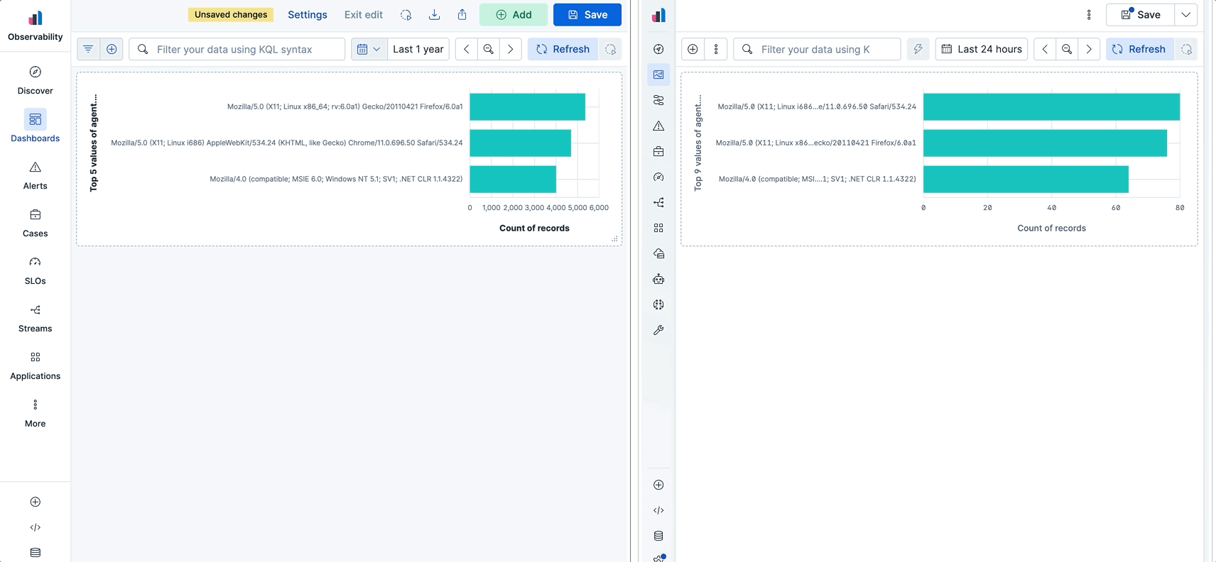

  • Discover drilldowns now work on ES|QL panels. When a user clicks a data point or uses Explore in Discover, filters are translated to ES|QL WHERE clauses and Kibana Query Language (KQL) queries are carried over automatically.
  • Click-to-filter also works for renamed fields: if your query renames a column (STATS BY node = k8s.node.name), Kibana now resolves the alias back to the indexed field, so the filter applies correctly.
  • Tooltips: When filtering genuinely can't work (for example, because the field was computed entirely within the query and doesn't exist in the index), Kibana now shows a tooltip explaining why, so users know that it's a query limitation.Beyond interactivity, ES|QL layers now have the same Use global filters toggle (gear icon on the layer header) as data-view-backed visualizations. When you turn it off, the layer's query runs independently of dashboard-level filters, just like form-based layers already do. This is useful for reference lines, thresholds, or baselines that shouldn't change when you filter the dashboard. And ES|QL metric charts now support a background chart, matching the styling option already available for data view metrics.

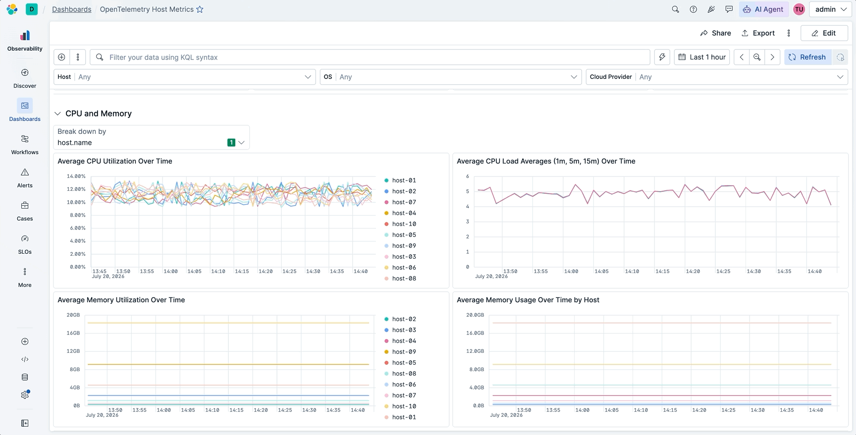

Identify which Kibana panels use an ES|QL variable
Variable controls are among the most popular ES|QL-only features, since they let you parameterize chart queries to switch between fields, time intervals, or groupings without duplicating panels. On a dashboard with many panels and controls, though, it can be hard to tell which visualizations a variable actually affects. In edit mode, you can now click an ES|QL variable control's label to identify all related panels that consume the variable. Variables with no related panels display a warning to make it easier to audit wiring before saving.

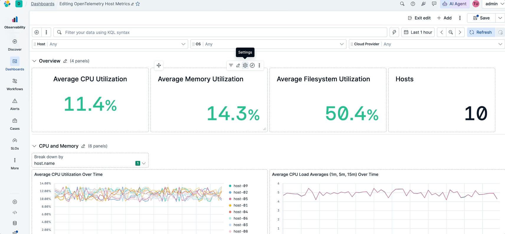

Kibana metric and bar chart layout defaults
Metric chart preset layouts and density options
The metric chart appearance panel now offers preset layouts: Top, Middle, Bottom, and Custom. When you pick a template, the layout snaps into place. If you need fine-grained control, switch to Custom.
Metrics used to pack values tightly, which is great for data-dense dashboards but hard to scan when a metric stands alone. Elastic Cloud 9.5 adds a Density style option under Style > Details > Other, with two presets: Compact (the previous layout) and Default (more padding, larger typography). Newly created metrics use Default, and existing saved charts keep Compact until you change them.

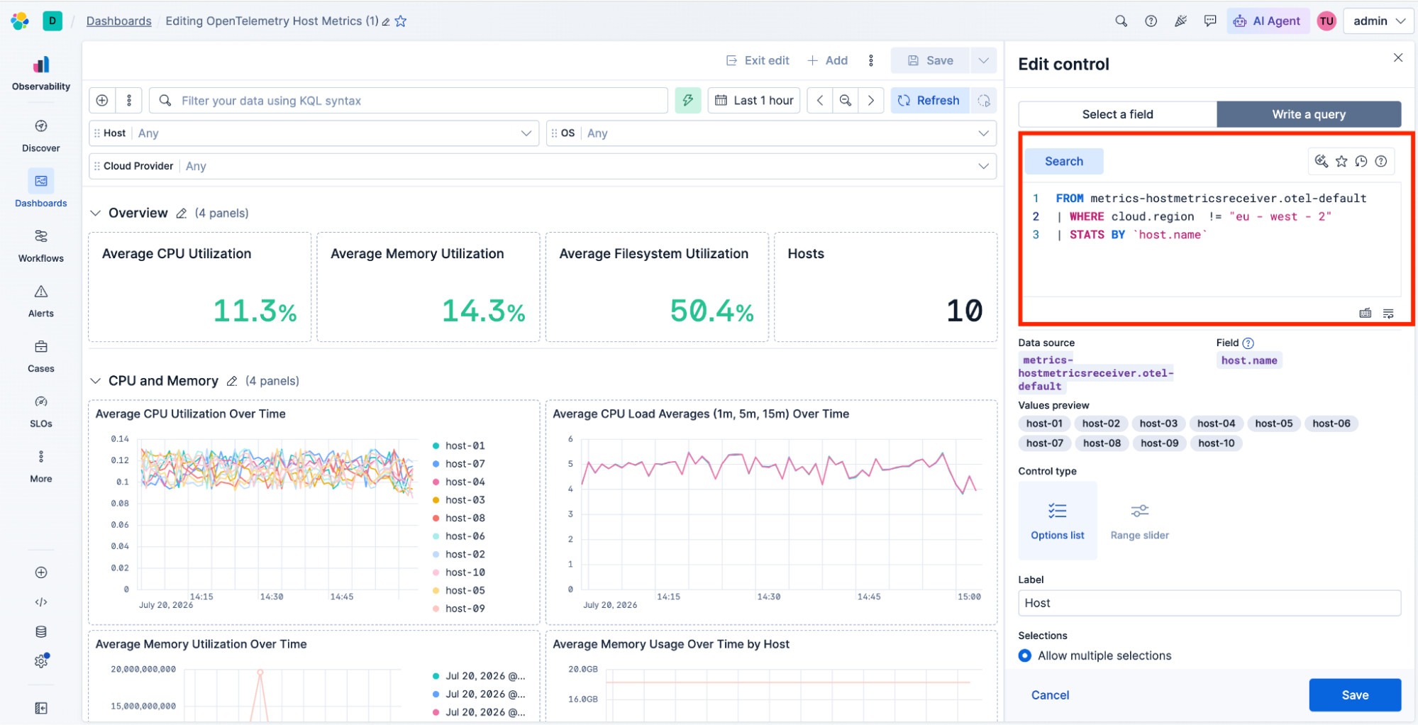

Kibana dashboard controls populated by ES|QL queries
Controls are the most user-friendly way to filter a dashboard, and most dashboards use them. One of the longest-standing requests from users has been the ability to prefilter the values that a control shows. ES|QL queries make that possible and open a much wider set of possibilities, like chaining controls in new ways using variables. Regardless of how the values are populated, controls filter every panel on the dashboard, including ES|QL and data view visualizations.
Controls can now be populated from an ES|QL query instead of selecting a data view field directly. The Create control flyout adds a Select a field / Write a query toggle. You can write an ES|QL query that returns a single column and run it, and then the control derives its options from the result. Queries can reference dashboard variables through the ?variable syntax, enabling flexible chaining between controls.
