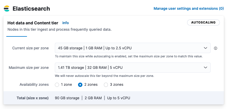

View and adjust autoscaling settings on data tiers:
Open the Edit page for your deployment to get the current and maximum size per zone of each Elasticsearch data tier. In this example, the hot data and content tier has the following settings:
Current size per zone
Maximum size per zone
45GB storage
1.41TB storage
1GB RAM
32GB RAM
Up to 2.5 vCPU
5 vCPU
The fault tolerance for the data tier is set to 2 availability zones.
- Use the dropdown boxes to adjust the current and/or the maximum size of the data tier. Capacity will be added to the hot content and data tier when required, based on its past and present storage usage, until it reaches the maximum size per zone. Any scaling events are applied simultaneously across availability zones. In this example, the tier has plenty of room to scale relative to its current size, and it will not scale above the maximum size setting. There is no minimum size setting since downward scaling is currently not supported on data tiers.

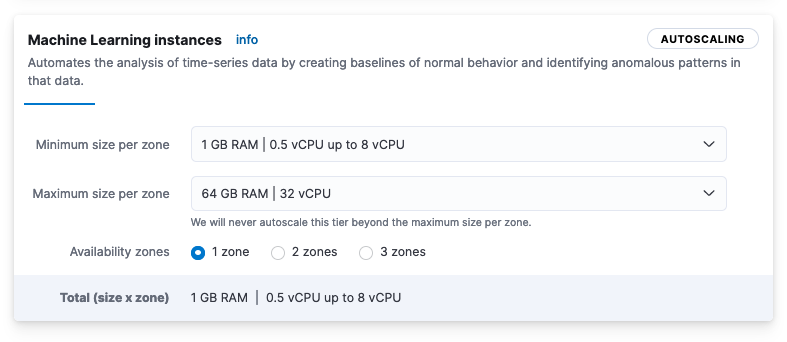

View and adjust autoscaling settings on a machine learning instance:
From the deployment Edit page you can check the minimum and maximum size of your deployment’s machine learning instances. In this example, the machine learning instance has the following settings:
Minimum size per zone
1GB RAM
64GB RAM
0.5 vCPU up to 8 vCPU
32 vCPU
The fault tolerance for the machine learning instance is set to 1 availability zone.
- Use the dropdown boxes to adjust the minimum and/or the maximum size of the data tier. Capacity will be added to or removed from the machine learning instances as needed. The need for a scaling event is determined by the expected memory and vCPU requirements for the currently configured machine learning job. Any scaling events are applied simultaneously across availability zones. Note that unlike data tiers, machine learning nodes do not have a Current size per zone setting. That setting is not needed since machine learning nodes support both upward and downward scaling.
