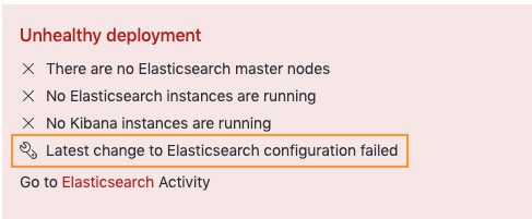

When you attempt to apply a configuration change to a deployment, the attempt may fail with an error indicating that the change could not be applied, and deployment resources may be unable to restart. In some cases, bootlooping may result, where the deployment resources cycle through a continual reboot process.
A screen capture of the deployment page showing an error:Latest change to Elasticsearch configuration failed.
To confirm if your Elasticsearch cluster is bootlooping, you can check the most recent plan under your Deployment Activity page for the error:
Plan change failed: Some instances were unable to start properly.
