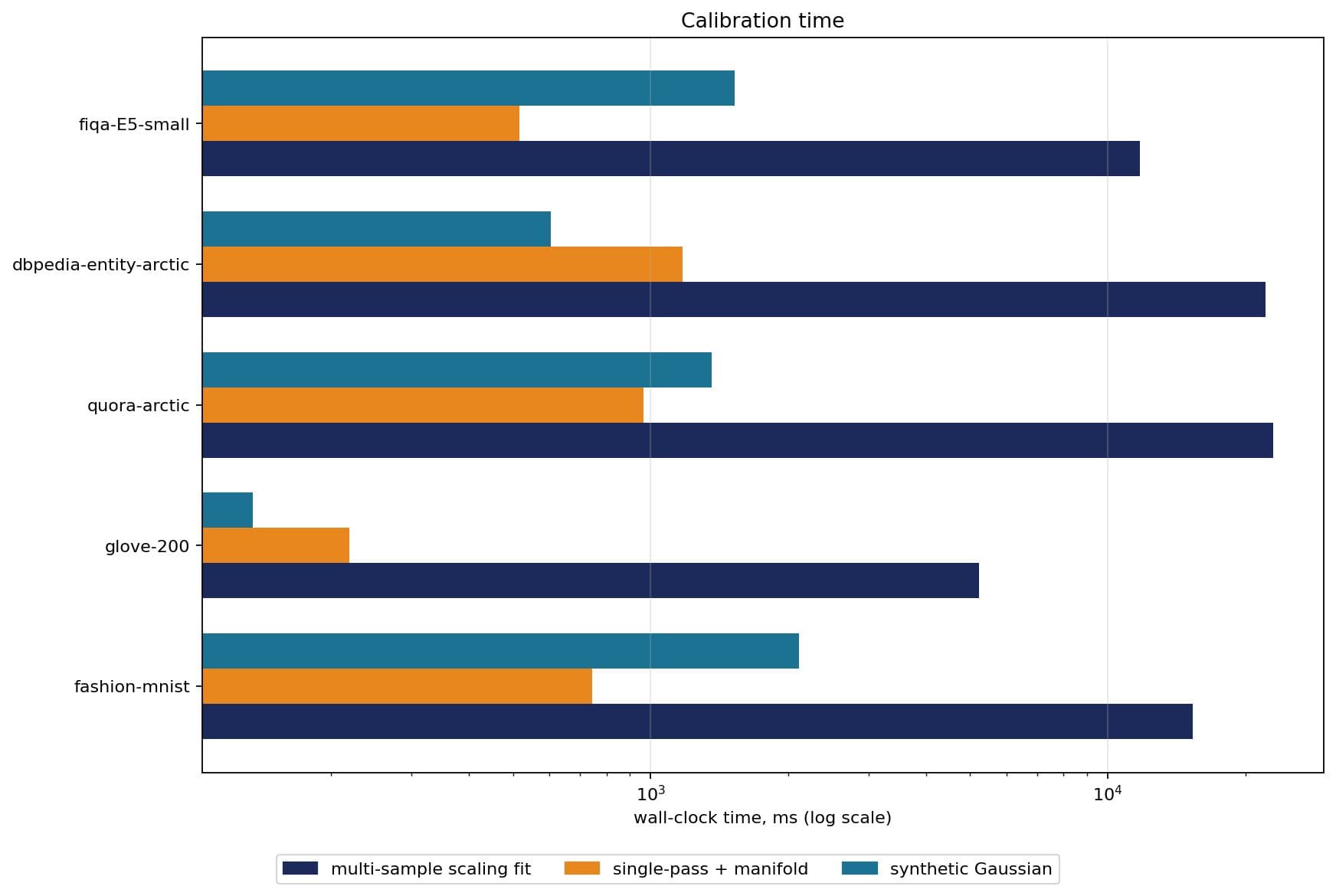

Clustering the corpus at several sample sizes and fitting how the error scales with cluster size requires re-clustering a real sample of the corpus at several different sizes and fitting a regression model to see how the error shrinks as the effective cluster size grows. We also add a conservative +3σ margin on top of the fitted estimate to guard against noise in the fit itself. This is accurate and appropriately cautious; however, while benchmarking on common dense retrieval datasets, we found that performing several hierarchical k-means passes per candidate was expensive.
To speed things up, we tried approximating residuals with a synthetic isotropic-Gaussian formula. Instead of clustering increasing-size samples, this approach generated synthetic residuals from the manifold model's local density estimate. It was fast and fit for background merges, with the full repeated clustering approach reserved for force-merges only. However, it turned out to inflate error when embeddings (residuals) are anisotropic (some directions carry a lot more variance than others). As a result, the estimated error could grow significantly on strongly anisotropic data (e.g., Fashion-MNIST-style image embeddings).
So instead we looked for a still fast but more accurate way of calculating residuals. We opted for using a single clustering pass over a smaller sample (2,048 vectors). The clustering runs once per merge and is then warm-started for every candidate encoding evaluated afterward, instead of re-clustering from scratch each time. To get the error's dependence on corpus size, which the baseline learns by re-clustering at multiple sizes, this approach instead reuses the manifold model's invDim as a plug-in for that dependence, extrapolating from the single real measurement rather than fitting the size relationship separately.
We also trimmed the query sample used during calibration from 1,024 to 256 vectors, on the reasoning that a smaller sample is enough once the error is being measured from real data rather than synthesized (and validated by benchmarks). The net effect was comparable wall-clock cost to the synthetic residual formula it replaced, but grounded in real per-cluster residuals, accurate enough that force-merge and background merge could be unified onto one path.

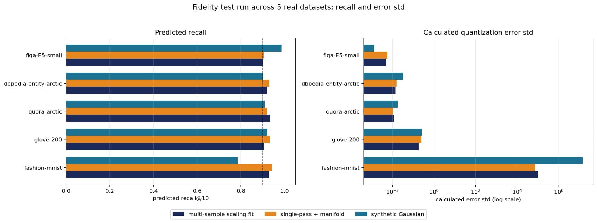

As an example, we take five different benchmark datasets and calculate the quantization error standard deviation (SD) by directly measuring the gap between exact and quantized dot products on a sample of real (or, for the synthetic residual formula, fabricated) residuals, then extrapolating that measurement to the full corpus size. They differ only in how much sampling and regression goes into that extrapolation: the multi-sample scaling fit sweeps fifteen sample sizes and fits how error scales with cluster size, the single-pass real residual measurement takes one larger real residual sample and reuses the manifold's intrinsic dimension to estimate the size dependency, and the synthetic residual formula skips real residuals altogether and samples from a synthetic Gaussian from the manifold's expected rank distance. We treat the multi-sample scaling fit as ground truth in this comparison because it's the most sample rich of the three, not because it's a zero variance measurement of the "true" corpus-wide error (it has its own sampling noise too). The table below summarises the methods and findings.
Method
How it works
Speed
Accuracy
When used
Multi-sample scaling fit
Clusters at 15 sample sizes, fits regression
Slow
Gold standard
Ground truth baseline
Single-pass real residual
One clustering pass + manifold invDim plugin
Fast
Near gold standard
Background + force merge
Synthetic residual formula
Gaussian from manifold density estimate
Fast
Inflated on anisotropic data
Deprecated
In order to exchange methods, we only need to be confident that they agree. This question can be answered independently of the correctness of the actual estimates, which we verified in our previous post for the multi-sample scaling fit. The figures below report the predicted quantization SD and the predicted recall@10, which is influenced by how we estimate the error. We report the analytical recall the manifold model predicts as a function of the quantization parameters, given the estimated error distribution perturbing the true distance ordering. This way, we isolate the quantization error's effect on ranking from any separate recall loss the IVF index itself might introduce, which is a distinct error.
The single-pass real residual measurement's calculated error SD is closer to the multi-sample scaling fit (our gold standard), with respect to the synthetic Gaussian residuals. Consequently, the predicted recall is closer when using the single-pass + manifold plugin method. Indeed, we found the models to be essentially interchangeable regarding the indexing decisions they lead to. Critically, we lower the calibration overhead by an order of magnitude.

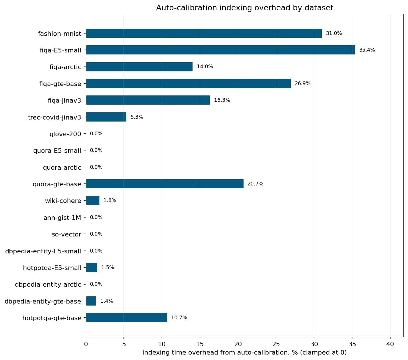

Auto calibration overhead on indexing performance
We compared the cost of auto calibration on indexing, when compared with ES defaults, over 18 public benchmarks. We noticed that more than 50% of the datasets report an auto calibration overhead below 2%. Three datasets report 16-27% overhead, while two datasets sit in the 31-35% overhead.
The merge overhead is larger for smaller datasets (Fashion-MNIST, FiQA) that get indexed in a few seconds; that is expected as the size of the vector samples being used for calibration is fixed and therefore more noticeable with tiny datasets. In fact, for larger datasets like DBPedia-Entity and HotpotQA (\approx5M doc vectors) the overhead is sometimes not noticeable and within 11% in the worst case.

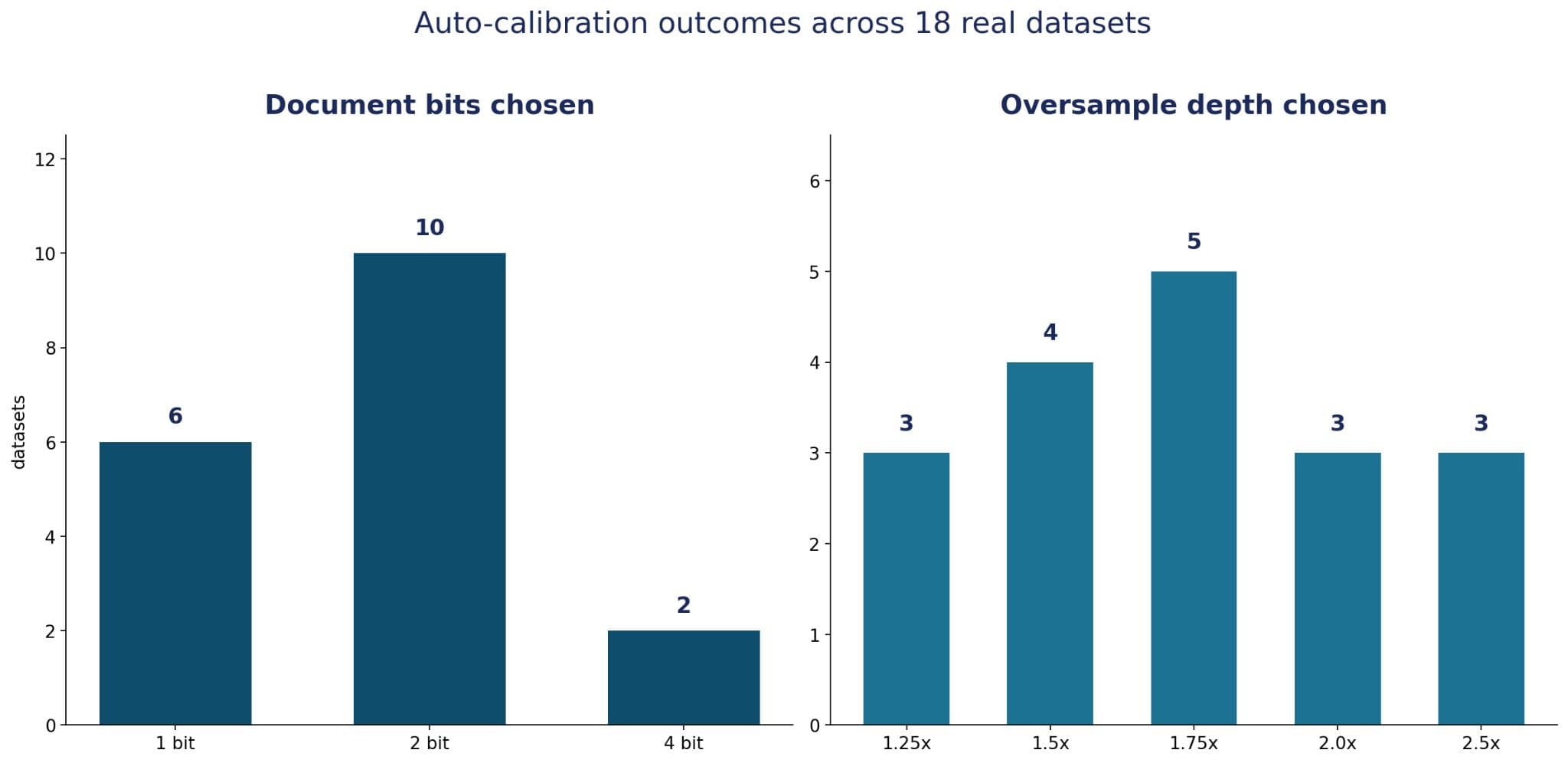

What quantization parameters does auto calibration choose?
Looking at the encoding auto-calibration landed on for each of the real datasets:
Query bits were 4 in every dataset. While query bits aren't priced into the cost formula, we still iterate through lower query bits first (e.g., at 1 bit doc vectors, we first evaluate recall for 1 bit query vectors, then for 4 bit query vectors); so it’s possible for some datasets to even choose symmetric 1-bit quantization. The center of mass is a 2-bit document encoding with somewhere between 1.5x and 1.75x oversampling; 4-bit only shows up for two genuinely harder datasets (Fashion-MNIST's image embeddings, GIST-1M), and 1-bit only for a handful of the text-embedding models that are most robust to quantization. In fact, our own models are among those that quantize best: we selected 1 bit documents for all three corpuses we tested with Jina v3.

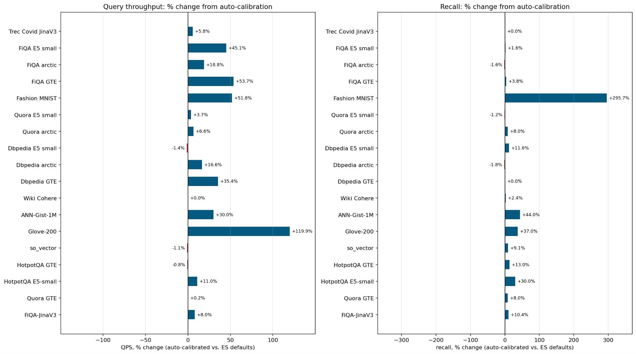

Recall and QPS improvements from automatic calibration
Auto-calibration is a broad win across the eighteen datasets: QPS improves in 15 of 18 cases (often substantially, double digits on about ten, and over +50% on FiQA GTE, Fashion MNIST, and Glove-200), and recall improves in 15 of 18 cases too, including a dramatic +295.7% rescue on Fashion MNIST. Most datasets see gains on both metrics simultaneously, and even the more modest cases still land solidly positive, recall improvements are commonly in the high single digits to double digits, QPS gains follow a similar pattern. Where either metric does dip, the drops are small and contained: the three QPS regressions all stay under 1.5%, and the three recall regressions all stay under 2%.
