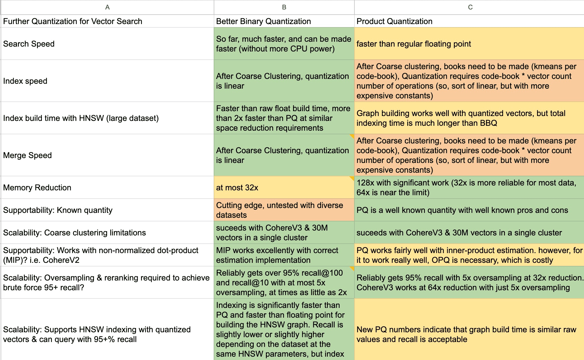

Recently, a paper, which we’ve discussed before, proposed an approach called RaBitQ that is able to achieve good recall using only 1 bit per component. This is exciting because 32×\times compression is competitive with Product Quantization (PQ), which was the previous state-of-the-art approach when compression was paramount. A key advantage of RaBitQ is that it’s relatively straightforward to accelerate distance calculations with SIMD operations. Certainly, when it is compared to PQ that uses lookups to compute distance, for which it is much harder to exploit hardware parallelism. The authors performed extensive experiments and showed they were able to achieve consistently higher recall as a function of query latency than PQ using the same compression ratio with an IVF index.
Although the RaBitQ approach is conceptually rather different to scalar quantization, we were inspired to re-evaluate whether similar performance could be unlocked for scalar quantization. In our companion piece we will discuss the result of integrating OSQ with HNSW and specifically how it compares to the baseline BBQ quantization scheme, which is inspired by RaBitQ. As an incentive to keep reading this blog we note that we were able to achieve systematically higher recall in this setting, sometimes by as much as 30%. Another advantage of OSQ is it immediately generalizes to using nn bits per component. For example, we show below that we’re able to achieve excellent recall in all cases we tested using minimal or even no reranking with only a few bits per component.

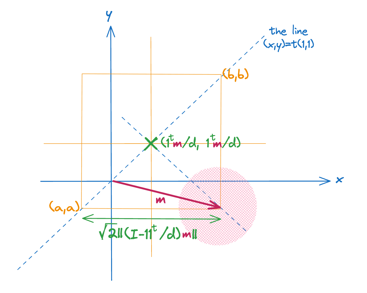

The geometry of scalar quantization
To build a bit more intuition about OSQ we digress to understand more about how scalar quantization represents a vector. Observe that the set of all possible quantized vectors lie inside a cube centered on the point a+b21\frac{a+b}{2}1 with side length b−ab−a. If only 1 bit is being used then the possible vectors lie at the 2d2^d corners of the cube. Otherwise, the possible vectors lie on a regular grid with 2nd2^{nd} points.
By changing aa and bb, we are only able to expand or contract the cube or slide it along the line spanned by the 11 vector. In particular, suppose the vectors in the corpus are centered around some point mm. We can decompose this into a component parallel to the 11 vector and a component perpendicular to it as follows
m=11tdm+(I−11td)mm = \frac{1 1^t}{d} m + \left(I - \frac{1 1^t}{d}\right) m
If we center the cube on the point at 1tmd1\frac{1^t m}{d}1 then it must still expand it to encompass the offset m−1tmd1m-\frac{1^t m}{d}1 before it covers even the center of the data distribution. This is illustrated in the figure below for 2 dimensions.
Since the quantization errors will be proportional on average to the side length of the cube, this suggests that we want to minimize ∥m−1tmd1∥\| m-\frac{1^t m}{d}1 \|. An easy way to do this is to center the query and document vectors before quantizing. We show below that if we do this we can still recover the dot product between the original vectors.
Note that
ytx=(y−m+m)t(x−m+m)=(y−m)t(x−m)+mty+mtx−mtm\begin{align*} y^t x &= (y - m + m)^t (x - m + m) \\ &= (y - m)^t (x - m) + m^t y + m^t x - m^t m \end{align*}
The values mtym^t y and mtxm^t x, which are the inner product between the query and document vector and the centroid of the vectors in the corpus, can be precomputed and in the case of the document vector cached with its quantized representation. The quantity mtmm^t m is a global constant.
This means we only need to estimate (y−m)t(x−m)(y−m)^t(x−m) when comparing a query and document vector. In other words, we can quantize the centered vectors and recover an estimate of the actual dot product.

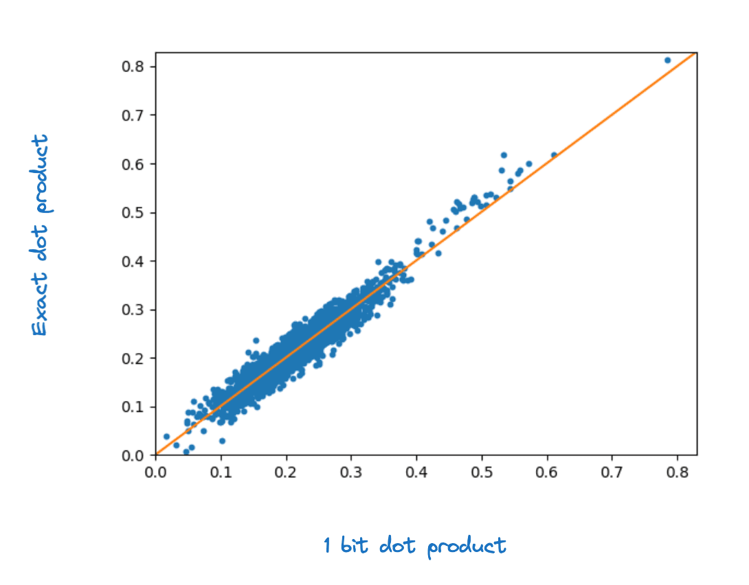

The figure below shows the floating point dot product values versus the corresponding 1 bit quantized dot product values for a sample of 2000 gte-base-en-v1.5 embeddings. Visually the correlation is high.
We can quantify this by computing the R2R^2 between the floating point and quantized dot products. For each dataset and model combination we computed the average R2R^2 for every query against the full corpus. We see small but systematic improvement in R2R^2 comparing OSQ to the baseline. The table below shows the R2R^2 values broken down by the dataset and model combinations we tested.
