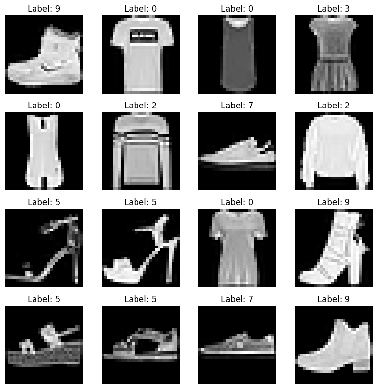

But there are lots of real-world vectors that aren’t like this. Consider a 784-dimension vector representing a grayscale image, like in the Fashion-MNIST dataset. Some pixels near the center of the image, where the clothing actually appears, vary a lot across the dataset. However, other pixels, such as those near the corners, are mostly one color and barely vary at all. When BBQ quantizes these vectors, the high-variance dimensions lose precision because a single bit can't capture their range, while the low-variance dimensions become useless. The resulting quantized vectors are poor approximations of the originals, and recall suffers.
Picture of a representation of Fashion-MNIST images. (credit: geeksforgeeks.org)
