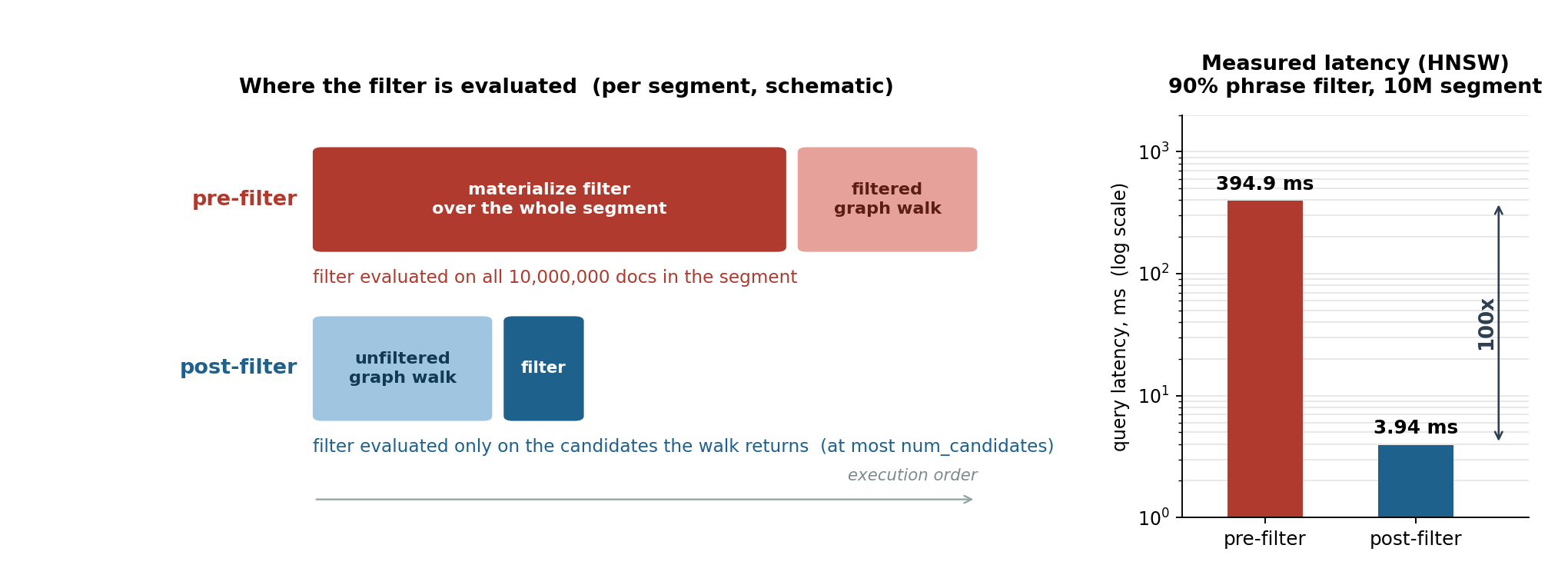

That is the asymmetry the rest of this post is about. The filter's cost is tied to how many documents it is evaluated over, and evaluating it after the vector search instead of before changes that number by orders of magnitude:
Pre-filtering evaluates the filter over every document in the segment before the vector search; post-filtering evaluates it only over the candidates the vector search returns.

The problem with using post-filters in kNN is that the filter is being applied after we have gathered the top k results. This means that we can end up with less than k results, as we need to remove the elements that don't pass the filter from the top k results that we've already retrieved from the HNSW graph.
Ask for 10, get back 6. Or 2. Or 0. The vector search does not know the filter exists, so nothing guarantees that 10 of its results survive it. The only remedy available to you is to over-collect by hand: ask for k: 50 and hope 10 survive. That puts you in an awkward position:

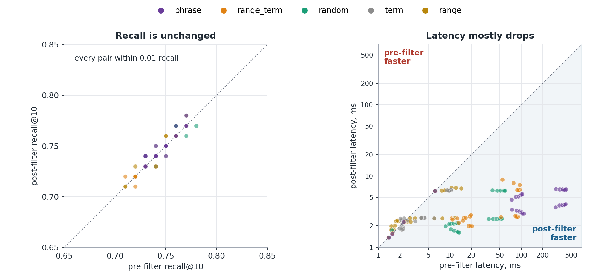

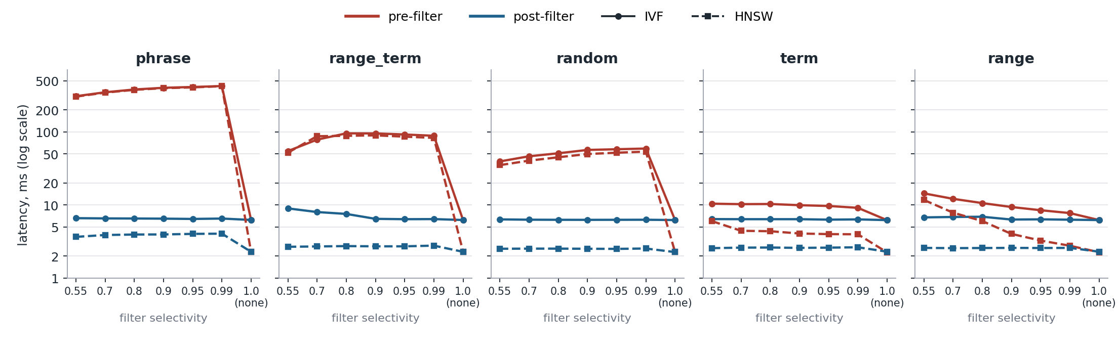

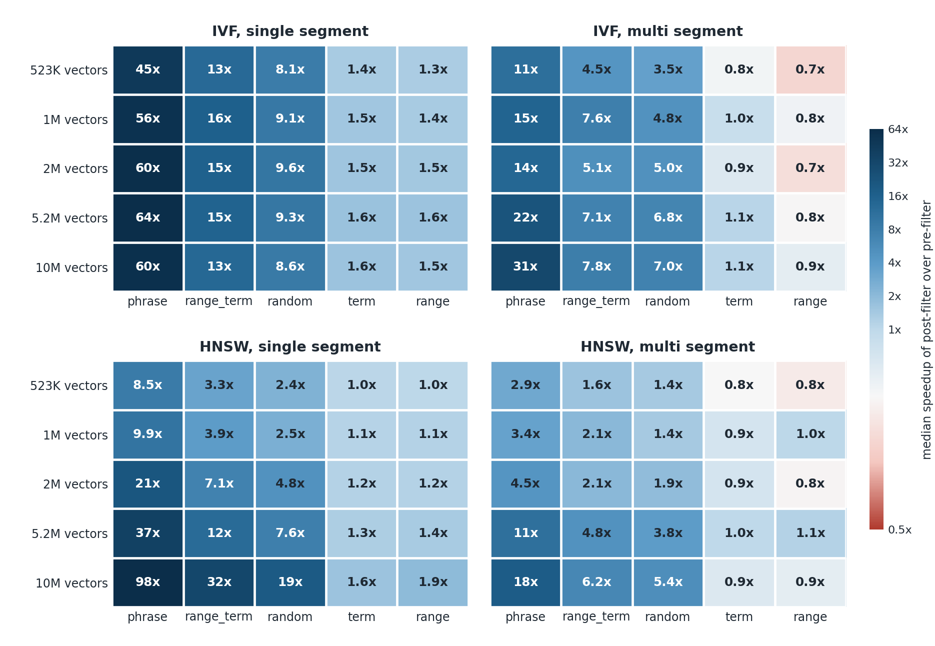

But we can do better
The insight is that the choice between these two does not have to be the user's, and it does not have to be made once for the whole index. Elasticsearch is holding the filter's Weight at rewrite time. It can estimate how selective the filter is, decide whether post-filtering is a good bet for this query on this shard, size the over-collection from that estimate rather than from a guess, and keep a correctness net underneath so that a bad estimate costs latency instead of results.
This is what automatic post-filtering adds, for both HNSW and IVF (bbq_disk). Importantly, none of it changes the query you write: you keep expressing a pre-filter, you keep getting pre-filter semantics, and how that gets satisfied becomes an engine decision.

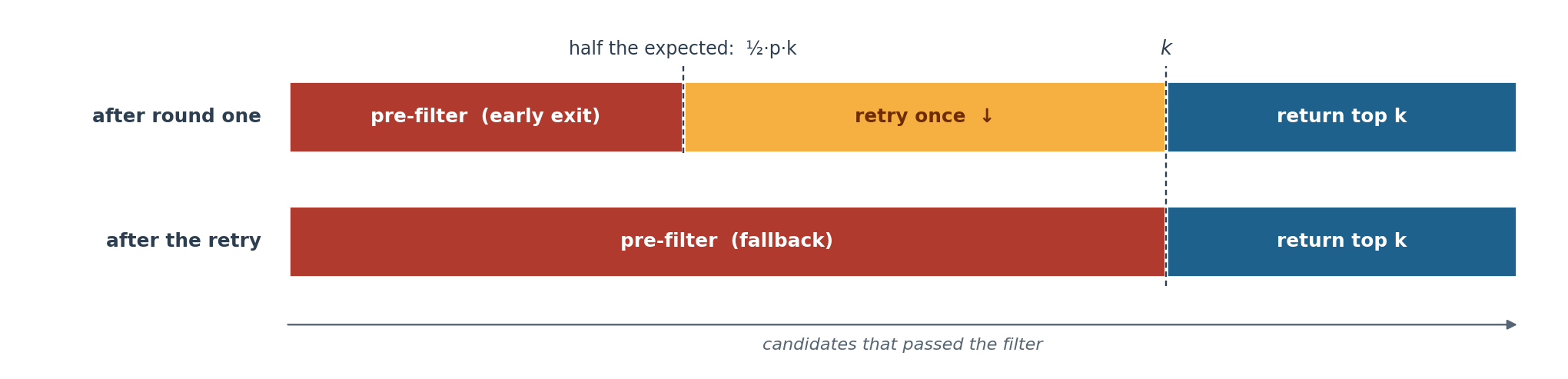

Four ideas, in order:
  1. Estimate the filter's selectivity.
  2. Use it to size an over-collection.
  3. Retry once if that comes up short.
  4. Fall back to the original query if it still does.

- If at least kk candidates passed the filter, return the nearest kk .
- If fewer than half the expected number passed (0.5⋅p⋅k0.5 \cdot p \cdot k), exit early to the pre-filtered query.
- Otherwise, retry once. If at least kk have passed by then, return the nearest kk; if not, fall back to the pre-filtered query.
The same two checks, one row per round. Every pre-filter outcome returns exactly what pre-filtering alone would.

4. Search unfiltered. The delegate runs across all segments with no accept-docs bitset: no filter materialization and no extra exploration. Each segment keeps every candidate its own search collected, so the orchestrator does not have to re-derive them. On HNSW that is the segment's whole beam, up to 100 candidates; on IVF it is a small multiple of the 15 requested, since IVF over-collects to absorb documents that appear in more than one posting list.
5. Apply the filter to the candidates, not to 10 million documents. applyFilter walks each segment's candidates in doc-ID order and tests them through Lucene#asSequentialAccessBits. For a filter exposing a TwoPhaseIterator, that is one approximation advance per candidate, plus a matches() call whenever the approximation lands on it. This is the whole point: the filter is evaluated once per candidate rather than once per document in the segment.
It also means the filter no longer needs to be cached to be fast. With pre-filtering, the usual way to avoid paying for materialization on every query is the filter cache, which stores the filter's per-segment bitset for reuse. That only helps once a filter has been seen often enough to get cached, and every new segment starts cold. Post-filtering has nothing worth caching: applyFilter tells the filter how few candidates it will be checked against, and Lucene's query cache declines to build a bitset for a filter that matches millions of documents when only a tiny fraction of them will be looked at. The filter is just as fast on its first use as on its hundredth.
6. Check against the target. The target is the 10 results the user asked for. With a filter that passes 90% of documents, roughly nine in ten candidates pass, far more than 10 across the segments. We deduplicate and keep the 10 nearest.
Suppose instead that only 7 distinct candidates had passed, as can happen when the filter is correlated with the query, like the Spanish-language query from earlier. 7 is above the hostile-filter threshold (10×0.9×0.5=4.510 \times 0.9 \times 0.5 = 4.5), so a retry fires: exclude every candidate already seen, whether it passed or not, seed from up to 4 of the nearest passing candidates per segment, and ask for computeScaledK(3, 0.9) = 5 more to cover the shortfall of 3. If that still leaves us short of 10, the pre-filtered query runs and post-filtering has cost nothing but the candidate collection.
7. Finalize. Select the top k by score via introselect and wrap the result in a KnnScoreDocQuery.
The filter was evaluated only on the candidates the vector search returned, instead of on ten million documents. The vector search was unconstrained, and the returned documents are the same 10 that pre-filtering would have found, with a guarantee that if they were not, you would have gotten the pre-filtered answer instead.

Results across corpus sizes and filter types
For filtering, the property of a dataset that matters most is its size, since materializing a filter costs time in proportion to the number of documents in each segment. We use the five datasets to show how the two strategies compare as the corpus grows, and take the detailed numbers below from the largest, cohere-msmarco-10M (10M vectors, 1024 dimensions, float32).
Median post-filter speedup over pre-filter across selectivities below 1.0, by corpus size. Blue means post-filtering is faster, red means pre-filtering is faster.
Post-filtering comes out ahead almost everywhere: at every corpus size, with both index types, and in both layouts. How far ahead depends on how expensive the filter is to materialize, and in most layouts the gap widens as the corpus grows. The 16 cells out of 100 below 1.0x are all cheap term or range filters on multi-segment layouts, and the lowest is 0.68x.
On the cohere-msmarco-10M dataset, 104 of the 120 filtered pairs are faster with post-filtering, including all 60 on a single segment, and 2 more are ties (within 2%). The remaining 14 are cheap range and term filters on multi-segment layouts, where pre-filtering is ahead by at most 1.33x (1.76 ms against 2.34 ms).
The latency-versus-selectivity curves show the mechanism directly:
Latency vs filter selectivity on cohere-msmarco-10M, single segment. Red is pre-filter, blue is post-filter; solid lines are IVF, dashed are HNSW.
The blue post-filter lines are nearly flat. With post-filtering, latency is driven mainly by the kNN search itself, which runs unfiltered and therefore costs the same no matter how much the filter matches. Applying the filter to the candidates adds little on top, and the over-collection stays small even as the filter narrows. For a given filter type, latency is almost indifferent to selectivity: in the median configuration it varies by about 10% across the whole 0.55-0.99 range, against about 50% for pre-filtering. The red pre-filter lines sit above them by roughly the cost of materializing the filter, meaning the gap is as large as the filter is expensive, and everything converges at 1.0, where there is no filter to evaluate.
Recall is essentially strategy-independent: every one of the 140 pairs is within 0.01 recall, so the trade-off really is pure latency.
Each point is one of the 140 pre/post pairs on cohere-msmarco-10M. Left: recall. Right: latency on a log scale; points below the diagonal are faster with post-filtering.
Limitations: Correlated filters and multi-segment layouts
Two caveats are worth stating plainly.
These filters are largely uncorrelated with the vectors. A filter built on random content passes documents independently of where they sit in vector space, which is exactly the assumption the binomial model makes. It shows in the results: within any one configuration, recall differs by at most 0.04 across the five filter types, and median recall is 0.74-0.75 at every selectivity. Correlated filters, like the language example earlier, are handled by the retry, early exit, and fallback rounds, which keep results correct even when the selectivity estimate is off. Measuring how much of the speedup carries over to strongly correlated filters is a natural next benchmark.
Multi-segment layouts shrink post-filtering's edge. Compare the single- and multi-segment panels of the heatmap. Fixed per-segment costs are paid more times, and pre-filtering amortizes its bitset across a smaller maxDoc per segment. Post-filtering still wins on the expensive filters; it just wins by less.
