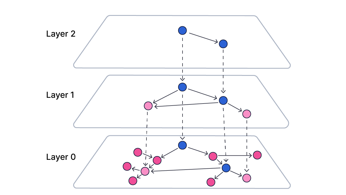

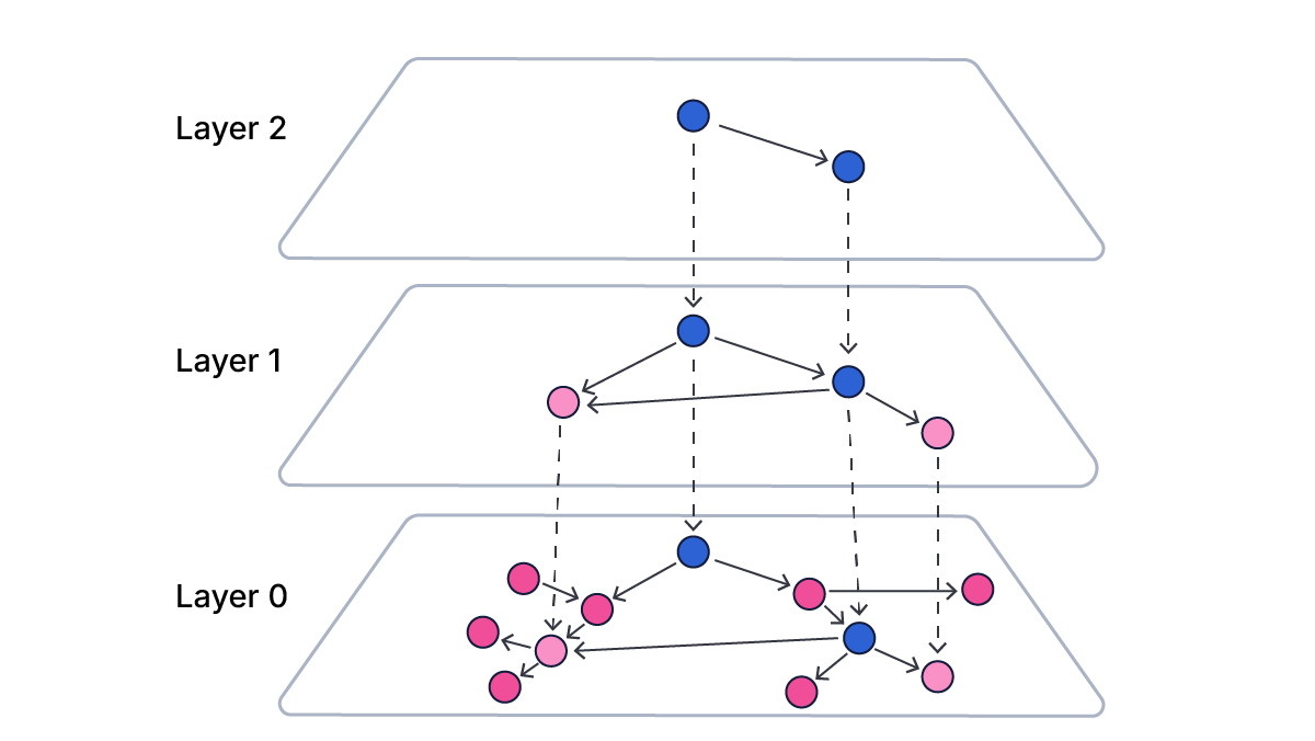

To start with, a brief recap of how HNSW graphs work. An HNSW graph is a layered data structure, with the following rules:
  • All vectors are present in the bottom layer (layer 0); each vector is represented by a graph node in that layer.
  • The probability of a vector appearing in each layer decreases logarithmically as you go up the layers, so each layer will have fewer vectors than the layer below it.
  • Each vector present in a layer is represented by a node in that layer. All the nodes for the same vector are associated with that vector.
  • If a vector is present in a layer, it will also be present in all lower layers, down to layer 0
  • Each node on each layer has references to a certain number of other nodes on the same layer, generally the closest nodes (as determined by the vector similarity, see below).
  • References are one-directional, so if node A references node B, node B does not necessarily reference node A.

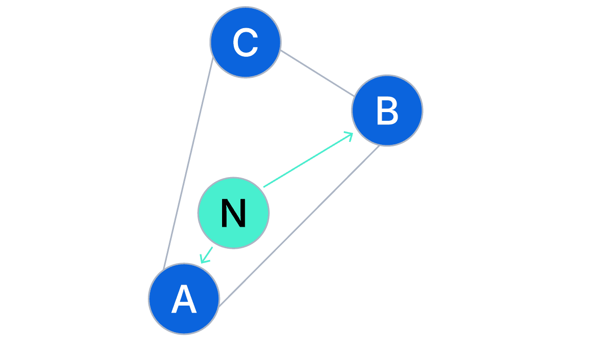

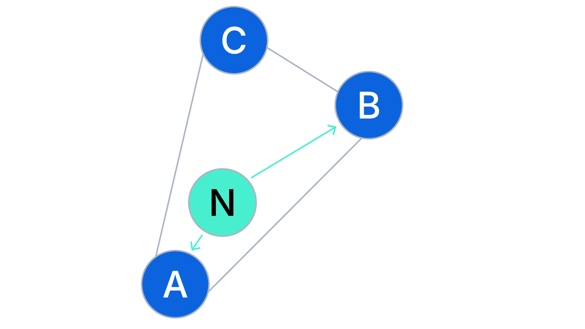

The key question is - which nodes do you connect to the new node? Naively, you would use the M closest nodes. But that can lead to problems if you’ve got several vectors close to each other in the same layer. Those can form a clique, with very few connections to other nodes. Once a graph traversal gets into that clique, it may be difficult to get out of, leading to suboptimal results.
To achieve this, the creation algorithm only adds new connections to nodes that are closer to the new node than any other node that is also a neighbour of the new node. As an example:
Node N is being added to the graph. New connections will be made from N to A and B, as the closest nodes, but not to C, as C is closer to B than it is to N. Then incoming connections to N are also made, from N’s newly connected neighbours back to N. These also take into account diversity, relative to the existing node, removing existing connections if that node’s connection limit has been reached to maintain diversity. These ensure that nodes are connected to a diverse selection of other nodes, maximising their reachability from elsewhere in the graph, and minimising the formation of fully-connected cliques.
But this does have a downside - because each node is not necessarily directly connected to all the nodes around it, a search for that node’s linked neighbours will not return complete results. This is one of the reasons approximate kNN search may miss some nodes that would be returned in an exhaustive search, and so reduce search recall compared with an exhaustive search, (see an example here).

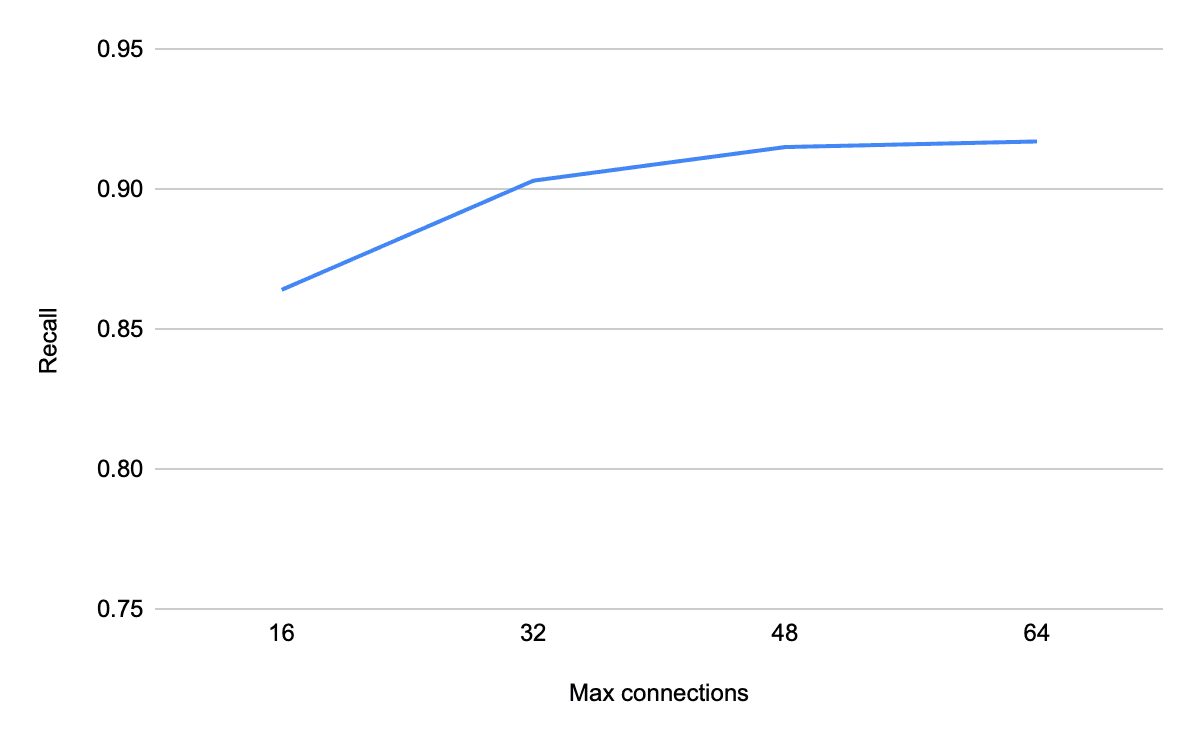

  • Increasing M makes searches more accurate by increasing the number of linked neighbours and the number of layers, but increases the disk and memory usage of the graph, the insertion latency, and the search latency.

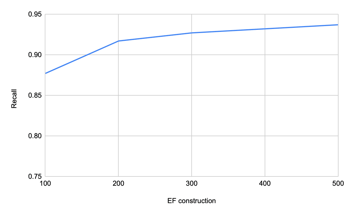

  • Increasing ef_construction does a more exhaustive search to find neighbours for each new vector, but increases the insertion latency.
