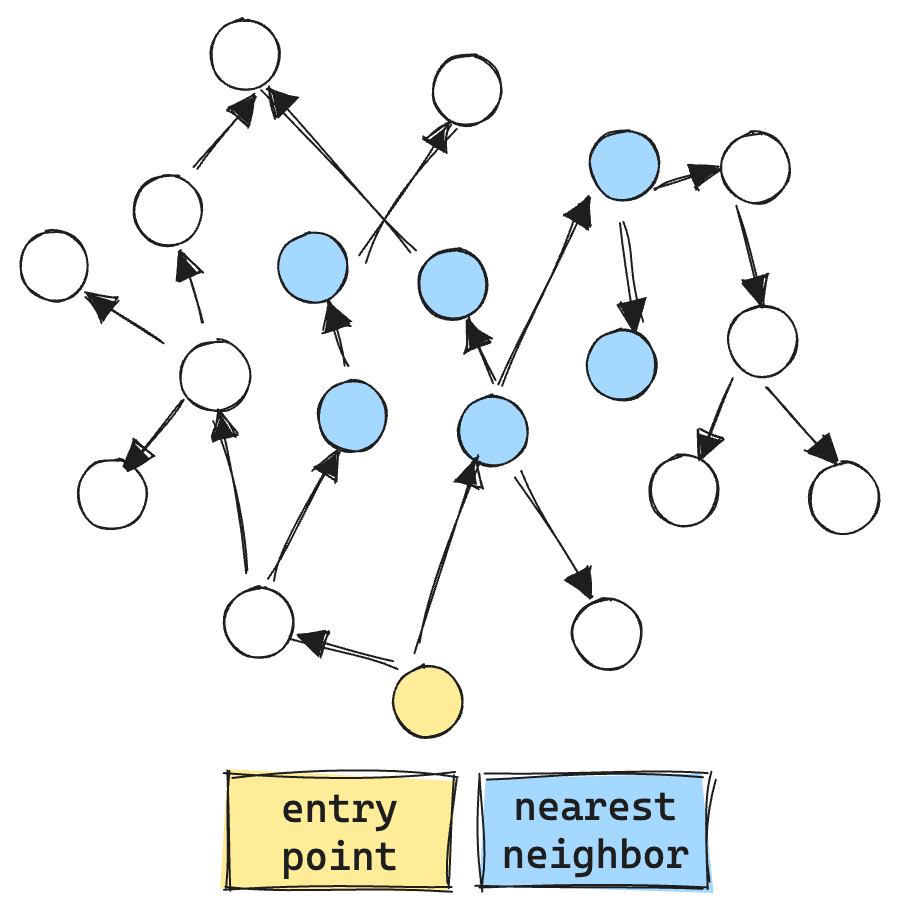

Here is an example of unfiltered graph search. Note there are about 6 vector operations.

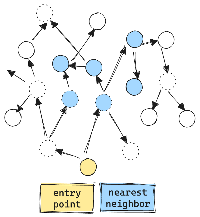

Because the HNSW graph in Apache Lucene has no knowledge of filtering criteria when built, it constructs purely based on vector similarity. When applying a filter to retrieve the k nearest neighbors, the search process traverses more of the graph. This happens because the natural nearest neighbors within a local graph neighborhood may be filtered out, requiring deeper exploration and increasing the number of vector comparisons.
Here is an example of the current filtered graph search. The “dashed circles” are vectors that do not match the filter. We even make vector comparisons against the filtered out vectors, resulting in more vector ops, about 9 total.
You may ask, why perform vector comparisons against nodes that don’t match the filter at all? Well, HNSW graphs are already sparsely connected. If we were to consider only matching nodes during exploration, the search process could easily get stuck, unable to traverse the graph efficiently.
Note the filtered “gulf” between the entry point and the first valid filtered set. In a typical graph, it's possible for such a gap to exist, causing exploration to end prematurely and resulting in poor recall.

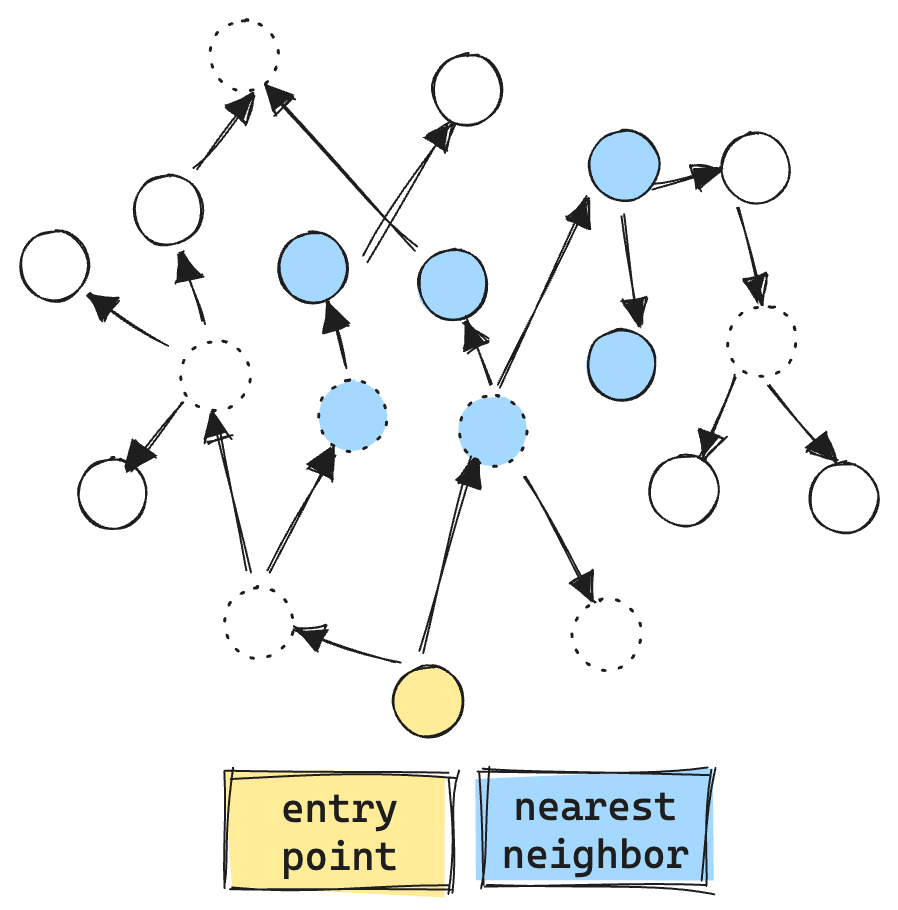

While the paper discusses multiple graph techniques, the specific algorithm we care about with Apache Lucene is their ACORN-1 algorithm. The main idea is that you only explore nodes that satisfy your filter. To compensate for the increased sparsity, ACORN-1 extends the exploration beyond the immediate neighborhood. Now, instead of exploring just the immediate neighbors, each neighbor’s neighbor is also explored. This means that for a graph with 32 connections, instead of only looking at the nearest 32 neighbors, exploration will attempt to find matching neighbors in 32*32=1024 extended neighborhood.
Here you can see the ACORN algorithm in action. Only doing vector comparisons and exploration for valid matching vectors, quickly expanding from the immediate neighborhood. Resulting in much fewer vector ops, about 6 in total.

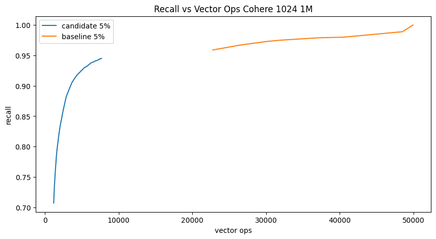

Across multiple real-world datasets, this new filtering approach has delivered significant speed improvements. Here is randomly filtering at 0.05% 1M Cohere vectors:
Up and to the left is “winning”, which shows that the candidate is significantly better. Though, to achieve the same recall, search parameters (e.g. num_candidates) need to be adjusted.

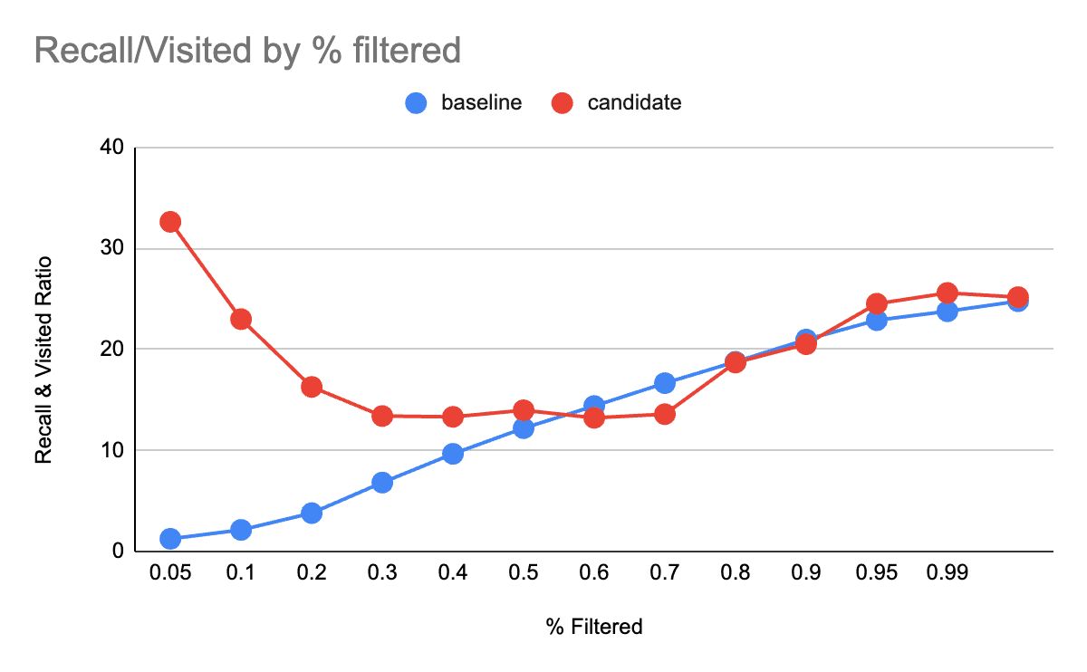

To further investigate this reduction in improvement as more vectors pass the filter, we did another test over an 8M Cohere Wiki document data set. Generally, no matter the number of vectors filtered, you want higher recall, with fewer visited vectors. A simple way to quantify this is by examining the recall-to-visited ratio.
Here we see how the new filtered search methodology achieves much better recall vs. visited ratio.
It's clear that near 60%, the improvements level off or disappear. Consequently, in Lucene, this new algorithm will only be utilized when 40% or more of the vectors are filtered out.

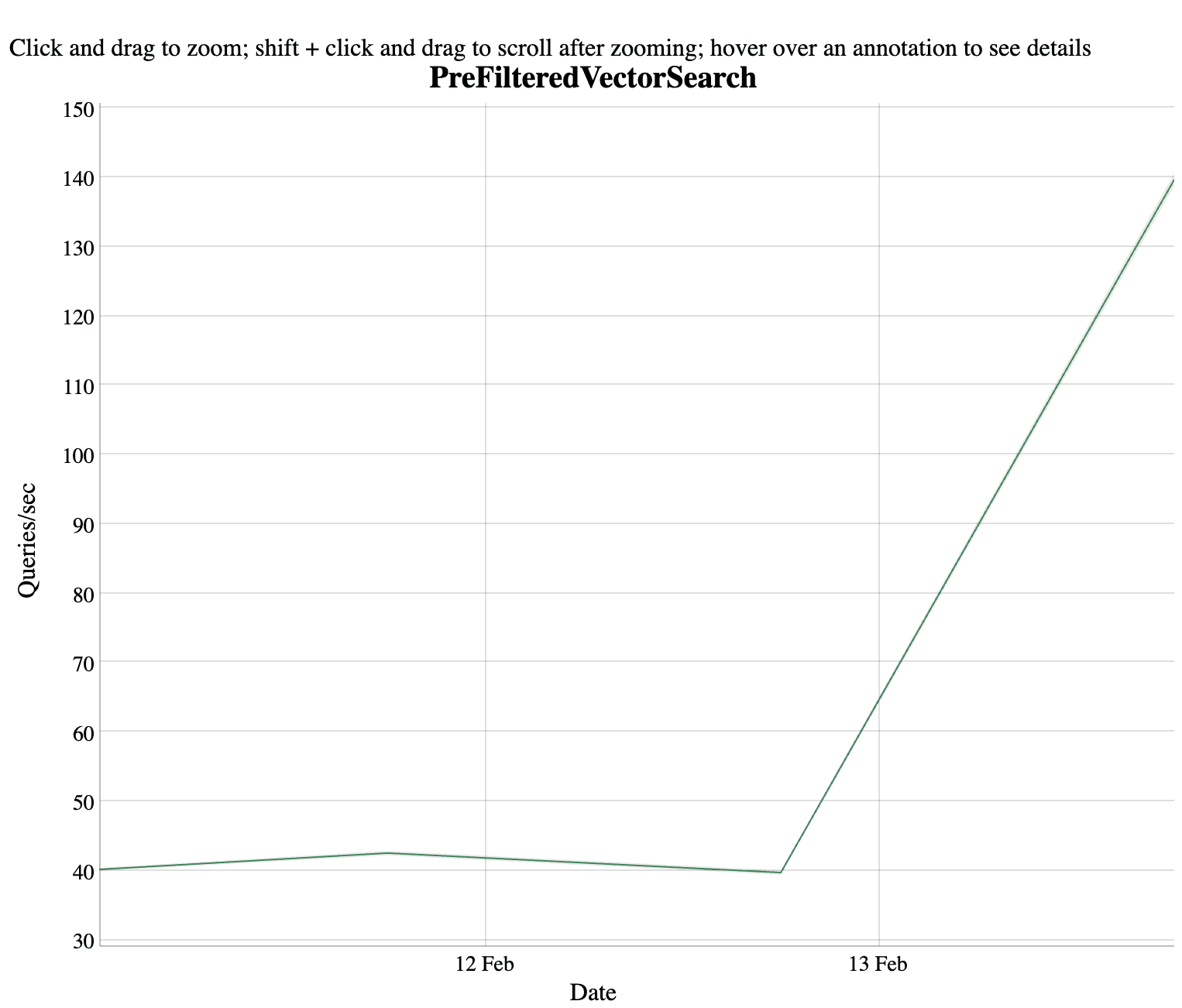

Even our nightly Lucene benchmarks saw an impressive improvement with this change.
Apache Lucene runs over 8M 768 document vectors with a random filter that allows 5% of the vectors to pass. These kinds of graphs make me happy.
