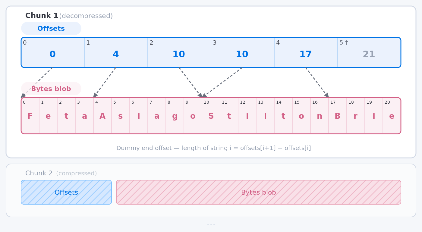

How columnar storage encodes string data
In Elasticsearch's standard mode, string values are stored by document; this is a row-major format. But in columnar mode, unsurprisingly, the data is stored in columnar-major format. A column of string data is stored in chunks. Each chunk contains many string values and consists of an array of integer offsets and a (Zstd-compressed) blob of the strings' bytes. For a string at index i, offsets[i] points to the offset in the decompressed byte blob where the string starts. So the length of string i can be computed from offset[i+1]-offsets[i]. (There's a dummy extra offset at the end, so we can easily compute the length of the last string). The following diagram shows how a chunk with the strings ‘Feta’, ‘Asiago’, ‘’, ‘Stilton’, and ‘Brie’ is encoded.

All we need are the lengths, and those live in the offsets array. It's compressed, too, but with cheap integer compression rather than Zstd, which is much faster.
With this realization, we can rewrite empty string term queries. The one new operation we need is docValues.loadLength(docId), which reads directly from the offset array without touching the compressed bytes. After the previous example, this should look familiar. The most interesting part is TermEqualsQuery.rewrite; it finds the empty string special case and replaces the query with the simpler version that only checks the length.
