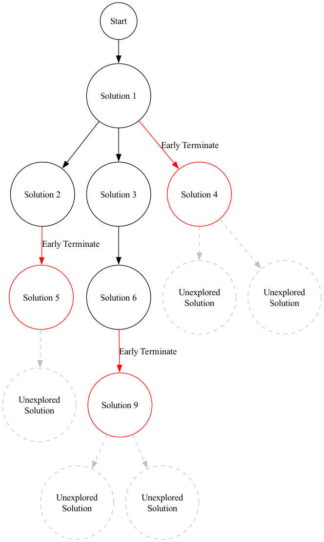

Navigating the solution space is a fundamental concept in optimization and search algorithms, where the goal is to find an optimal solution among a set of possible solutions. The solution space represents all potential solutions to a given problem, and navigating it involves systematically exploring these possibilities. This process can be visualized as moving through a graph where each node represents a different solution, and the objective is to identify the node that best meets the criteria of the problem. Understanding how to effectively navigate the solution space is crucial for solving complex problems that have huge numbers of solutions. Early termination is a generic optimization strategy that can be applied to any such algorithm to make smart decisions about when stopping searching for solutions under certain circumstances.
If any solution is considered 'good enough' to meet a desired criteria, the search can stop and the solution can be considered either a good candidate or an optimal solution. This means some potentially better solutions might remain unexplored, so it's tricky to find a perfect compromise between efficiency and quality of the final solution(s).
