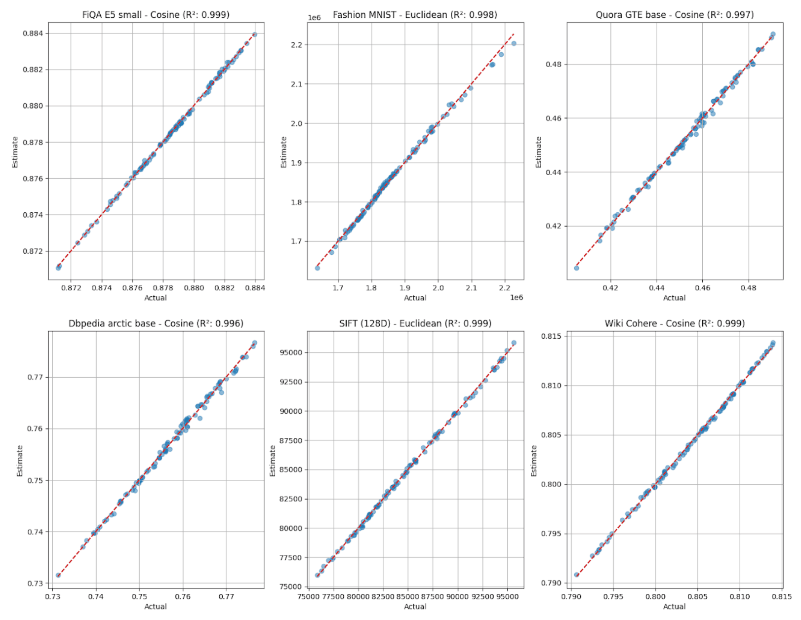

Figure 1 shows how well this fits in practice (and it’s remarkably good): predicted versus actual average distance to the kk-th neighbor, across a range of datasets and metrics, have R2R^2 between 0.996 and 0.999.
Figure 1 Goodness of fit of the average distance to the k-th nearest neighbor estimates. Each panel is a different dataset/metric; points are (actual, estimated) mean distances.

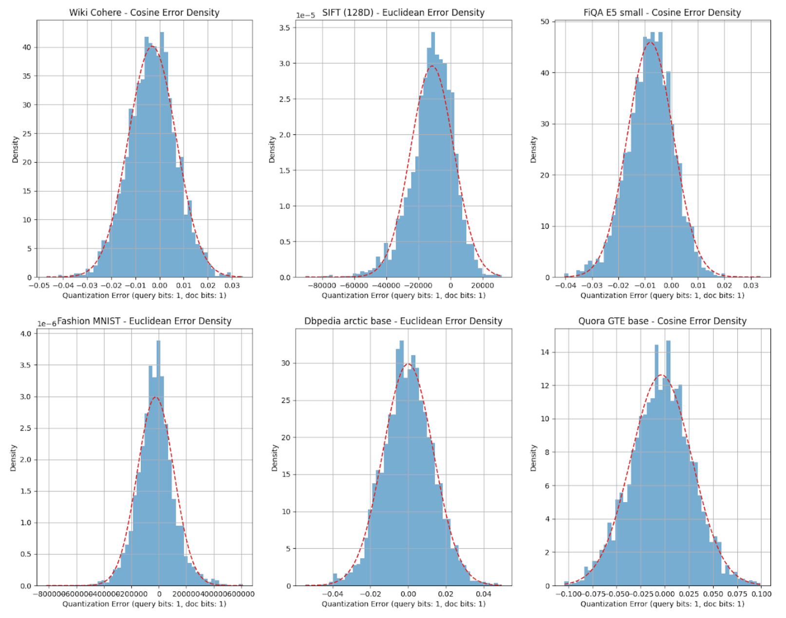

Modeling vector quantization error as Gaussian
With the nearest-neighbor distance model established, the second component is the quantization error distribution. For every metric we use, the quantized distance estimate differs from the true distance by an error that is a sum of many independent per-dimension contributions. By the Central Limit Theorem that sum tends to Gaussian, so we model the error as normal with a variance we estimate empirically:
σb2=1Z∑q∈Q∑i,j(ri,j(q)−r~i,j(q∣b))2,\sigma_b^2 = \frac{1}{Z}\sum_{q \in Q}\sum_{i,j}\big(r_{i,j}(q) - \tilde{r}_{i,j}(q \mid b)\big)^2\text{,}
where r~i,j(q∣b)\tilde{r}_{i,j}(q \mid b) is the quantized distance estimate using bb-bit vectors and ZZ is the total number of (query, neighbor) pairs in our sample set. In other words: sample, quantize, measure the squared distance errors, average.
Figure 2 shows the empirical basis for the Gaussian assumption: measured quantization error densities against best-fit Gaussians across a variety of datasets. The fit is good, which is what lets the rest of the model stay analytic.
Figure 2 Quantization error density plots (query bits 1, doc bits 1) with the best-fit Gaussian overlaid. The near-Gaussian shape is what the CLT argument predicts.

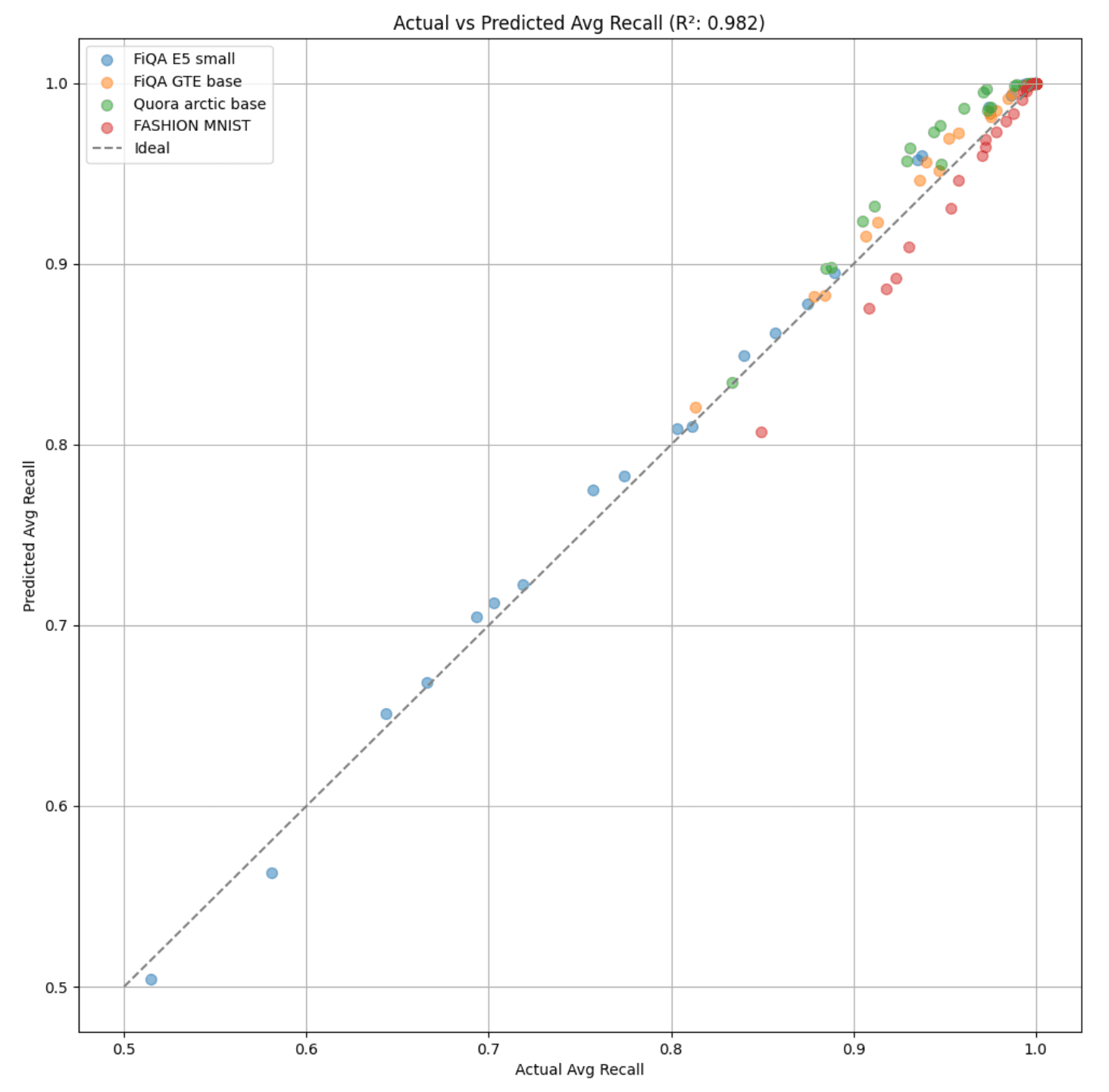

Figure 3 validates the end-to-end model: predicted average recall against measured recall across many parameter settings and multiple datasets has R2=0.982R^2 = 0.982.
Figure 3 Estimated versus actual average recall across a range of parameter settings and datasets. Points stay close to the ideal diagonal.
