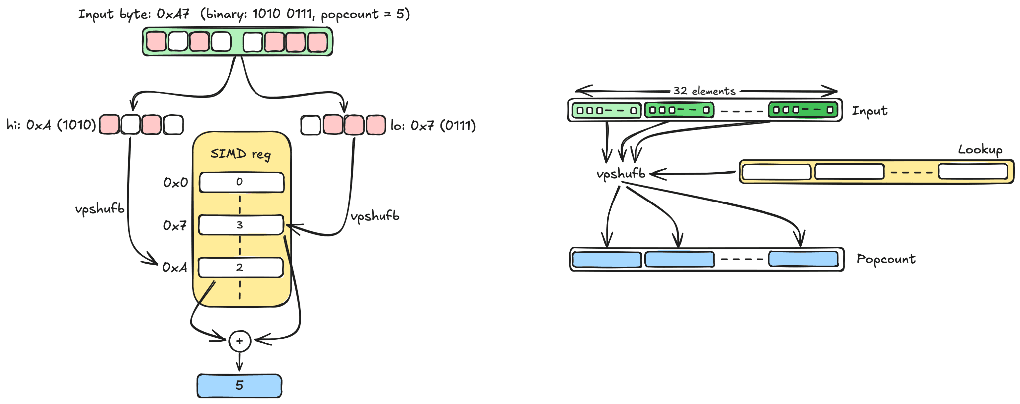

Building a missing instruction: Synthesizing popcount on AVX2 hardware
VPOPCNTDQ is available on AVX-512 processors from Intel Ice Lake and AMD Zen 4 onwards. But simdvec also needs to run on older AVX2 hardware that has no vector popcount instruction at all. The solution comes from Muła, Kurz, and Lemire (2018): Use the vpshufb byte-shuffle instruction as a parallel 4-bit lookup table. The idea is to use a SIMD register as the lookup table for the popcount function: Precompute popcount for every possible 4-bit value (0 through 15), and store these 16 results in a SIMD register. Then, for each byte of input, split it into its two nibbles and use vpshufb to look up both counts simultaneously:
Since vpshufb performs 32 independent table lookups in parallel, two shuffles, two masks, and one add gives us the popcount of 32 bytes (256 binary dimensions) without a dedicated popcount instruction:
const __m256i lookup = _mm256_setr_epi8(
    0, 1, 1, 2, 1, 2, 2, 3, 1, 2, 2, 3, 2, 3, 3, 4,
    0, 1, 1, 2, 1, 2, 2, 3, 1, 2, 2, 3, 2, 3, 3, 4);
// lookup low and high nibble popcounts separately
const __m256i lo  = _mm256_and_si256(vec, low_mask);
const __m256i hi  = _mm256_and_si256(_mm256_srli_epi16(vec, 4), low_mask);
const __m256i popcnt1 = _mm256_shuffle_epi8(lookup, lo);
const __m256i popcnt2 = _mm256_shuffle_epi8(lookup, hi);
local = _mm256_add_epi8(local, _mm256_add_epi8(popcnt1, popcnt2));
In this case, the instruction set architecture (ISA) didn’t offer the operation we needed, so we built it from what’s available. On AVX-512 with VPOPCNTDQ, the hardware provides the primitive directly; on AVX2, we can synthesize it from a byte-shuffle and a lookup table. Our native AVX2 implementation delivers ~4x over Java scalar scoring. Upgrading to AVX-512 with native VPOPCNTDQ adds another 1.3–2.1x on top, because a single instruction replaces the entire popcount sequence. (As usual, more details and JMH benchmarks can be found on the linked PRs.)
