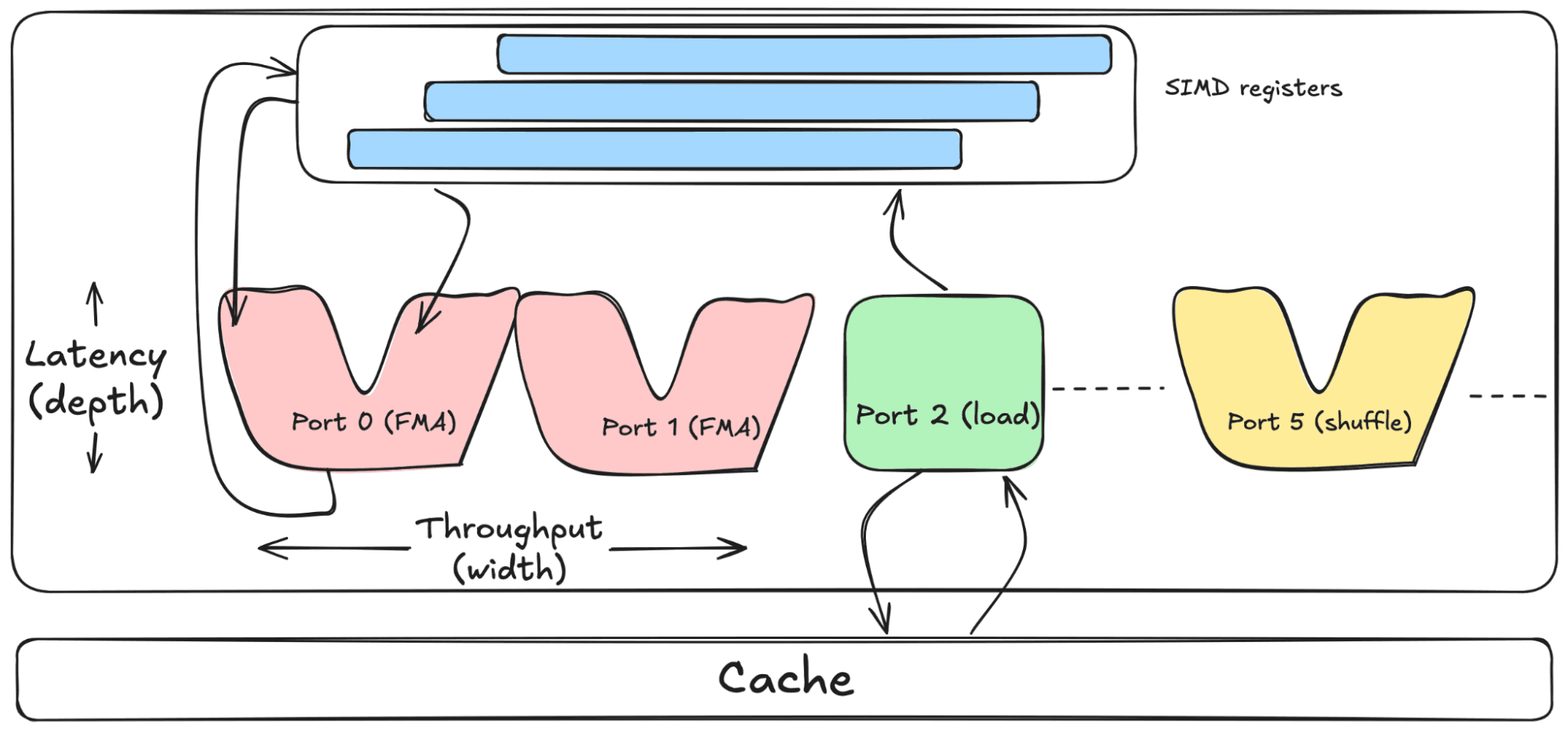

Modern CPUs can issue multiple operations per cycle because they have several execution units implemented in their silicon; operations are dispatched via interfaces called ports on x86 (execution pipelines, or pipes for short, on ARM). Ports handle different kinds of work in parallel: some memory loads and stores, some integer arithmetic, some floating-point math.
Two important properties of any operation a port can handle are latency and throughput. Latency is how many CPU cycles a single operation takes to produce its result; throughput is how many such operations can be started per cycle. Throughput is closely related to the number of ports available for a given operation: If a CPU has two ports that can execute FMAs, it can issue up to two independent new FMAs every cycle, for a peak throughput of two per cycle under ideal conditions.
Let’s take AVX-512 as an example. Most FMA instructions on modern Intel CPUs have a typical latency of ~four cycles and can execute on either of two FMA-capable ports. Starting from cold, the first result lands four cycles later, but once the pipeline is full, two new FMAs can start every cycle, as long as they don't depend on each other.
Our first steps aim at maximizing the number of ports used, balancing port usage and taking latency into account.
Cascade unrolling: maximizing FMA port utilization
Following the previous example, if an FMA instruction has a latency of four and a throughput of two, the CPU can keep ~eight FMAs in flight (issued, but not yet completed) at any moment. Of course, this can happen only if there are eight independent operations available.
If we chain them, each FMA waits for the previous one's result, and the CPU runs at latency (one FMA every four cycles) instead of throughput (two per cycle), up to 8x slower than the hardware can deliver.

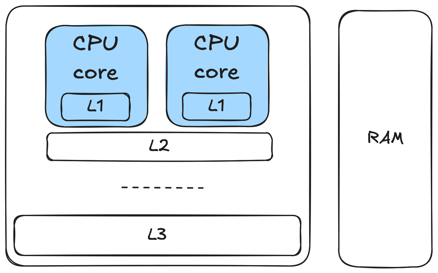

The vectors we score are often scattered across memory, producing irregular access patterns that are difficult for the CPU caches and hardware prefetchers to predict. This increases the likelihood that the data the CPU needs is not in the fast L1d cache and has to be fetched from further away (cache miss). The typical cost ranges from ~five cycles for an L1d hit to ~200+ cycles when the data must come from RAM.
It doesn’t matter if we maximized load port occupancy; if those ports stall waiting for data, the compute ports sit idle. The FMA throughput we saturated via cascade unrolling goes to waste. Retrieving data from memory to the L1d cache is time-consuming, especially if we need to traverse the whole memory hierarchy to RAM. Fortunately, as we know that we’re going to score multiple vectors, we can prime the CPU cache with the next vector (or vectors), effectively reducing or hiding the memory access latency.

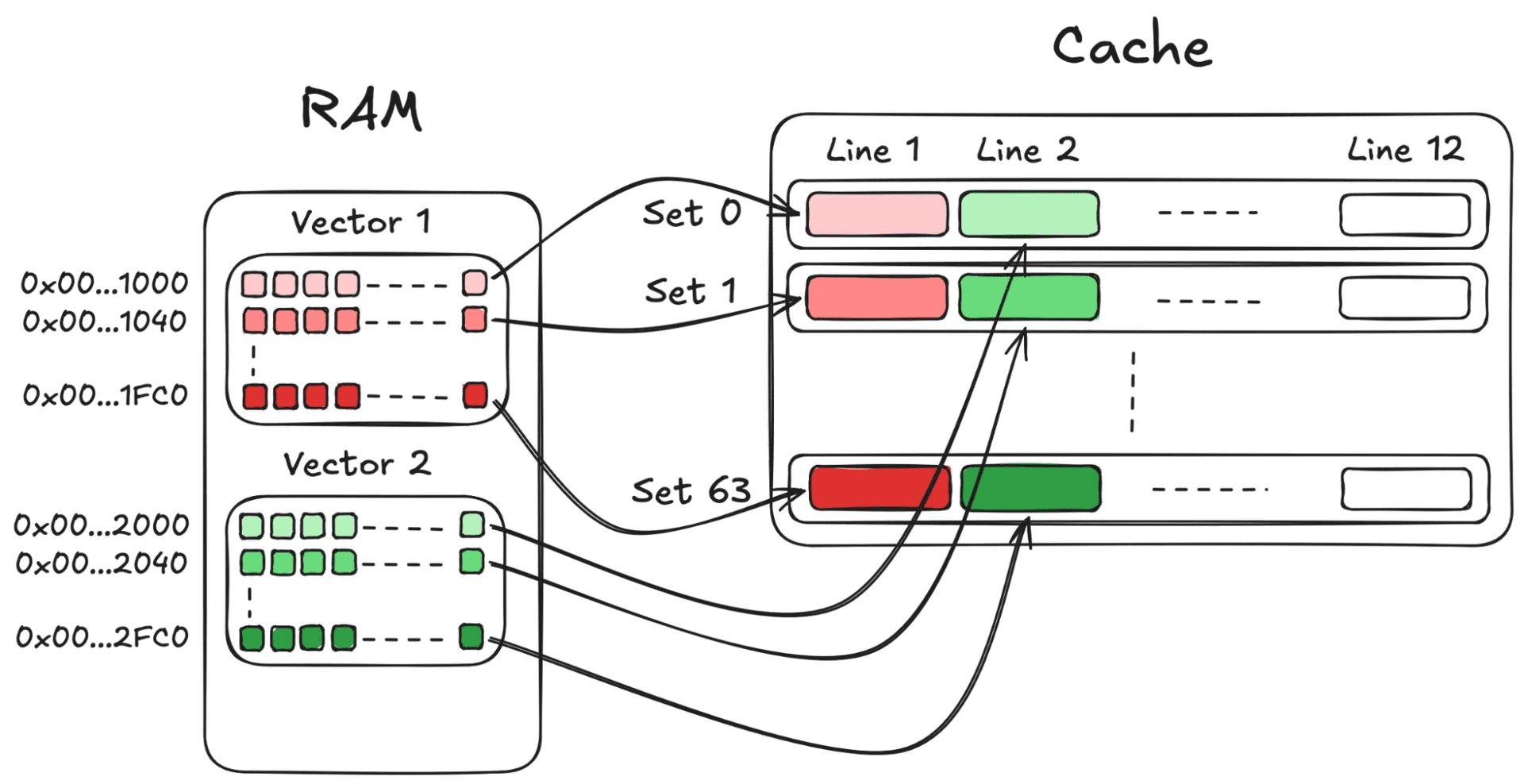

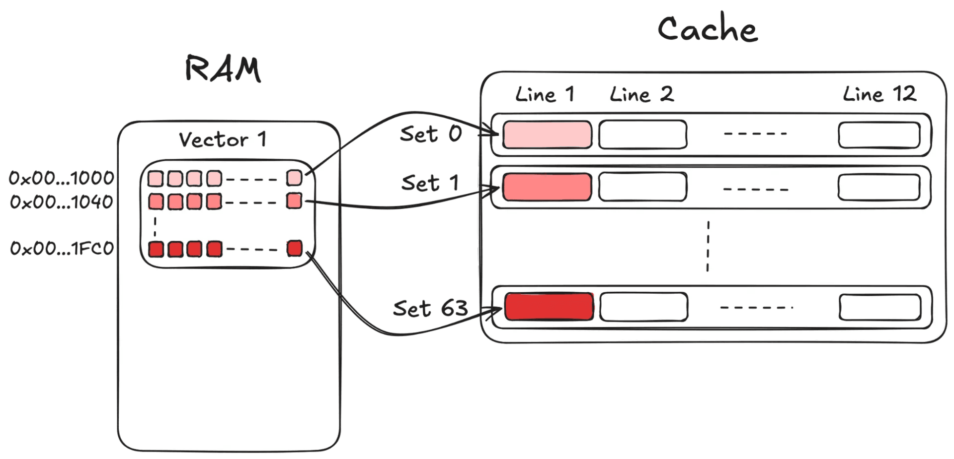

Let’s take a concrete example. Sapphire Rapids L1d cache is 48 KiB and 12-way associative. At 64 bytes per cache line, that gives us 768 cache lines organized into 64 sets. A cache line's set index (the “hashtable key”) is determined by bits [11:6] of the address (or, in other words, by (address / 64) % 64).
Suppose we have a float32 embedding with 1024 dimensions, stored contiguously in memory. Each vector occupies dims * sizeof(float32)= 4096 bytes, or exactly 64 cache lines. The stride between consecutive vectors is therefore 4096 bytes. Since 4096 is exactly one full wrap around the 64-set index space, the set index wraps perfectly: The i-th cache line of every vector maps to the exact same cache set.
Common power-of-2 vector sizes produce a stride that's a power-of-2 in bytes, which divides 64 sets evenly, so they interact pathologically with the cache in exactly this way. Processing together a batch of N documents with such dimensions exacerbates the situation: As they fall into the same L1d sets, they cause conflicts and cache thrashing.
Fixing cache aliasing by reducing batch parallelism

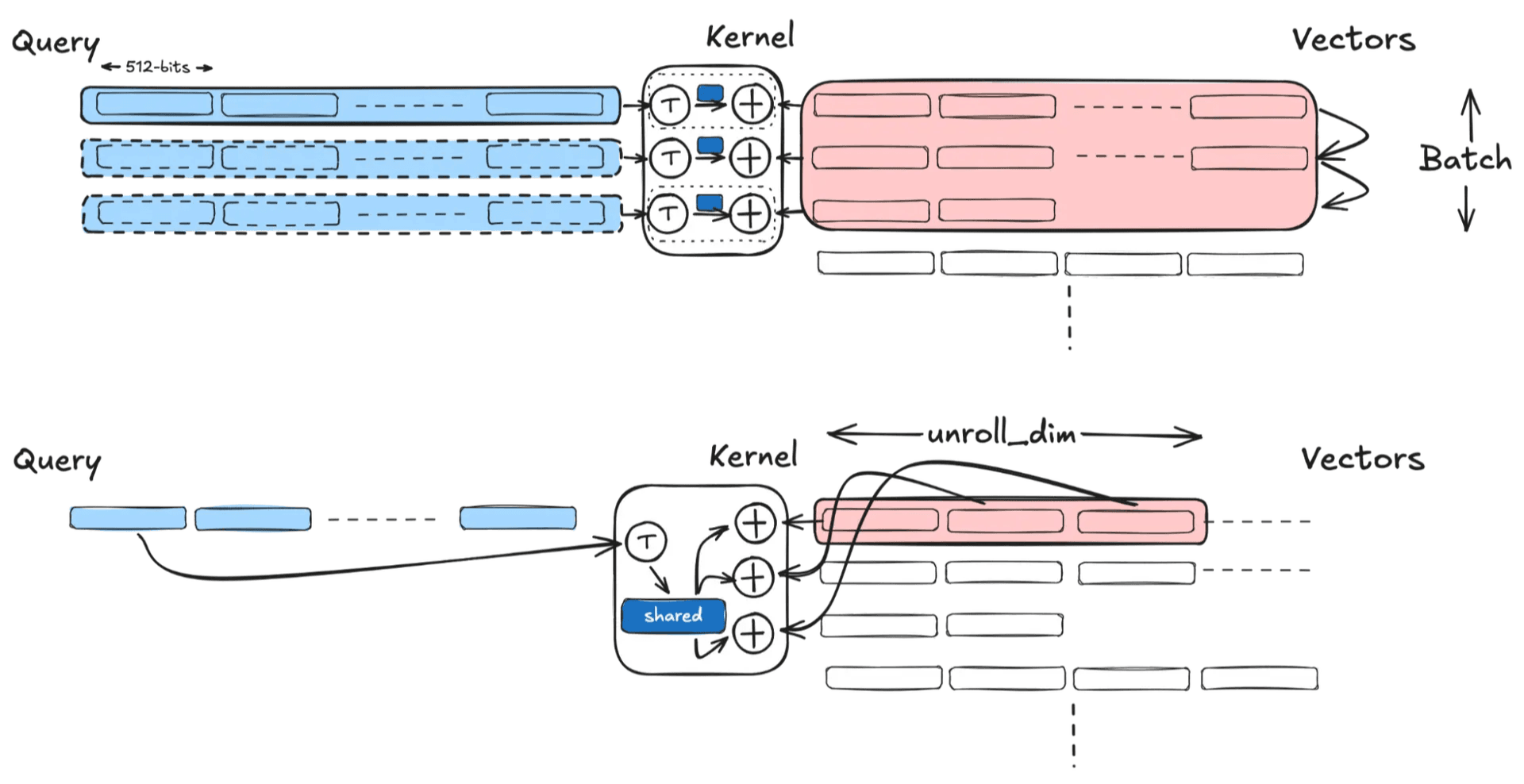

Unrolling along a different axis: saturating FMA pipelines without aliasing
batches parallelizes across documents, but that’s not the only axis available to us. We can unroll along the vector dimension axis instead. Rather than processing multiple vectors in parallel, we process multiple independent chunks of the same vector pair in parallel.
So we introduced unroll_dim. Crucially, by keeping batches=1, we sidestep the cache‑set aliasing trap altogether, and unroll_dim keeps the FMA pipeline saturated without needing the extra parallel doc loads that triggered the aliasing in the first place.
It works extremely well in some cases (+35–65% for dot product, as you’ll see from the aforementioned PR), but in other cases, the gain was more modest than we expected (~+10% for Euclidean distance). As in the other cases, all details and JMH benchmarks can be found in the linked PR.

The modest gains from unroll_dim on Euclidean distance suggested another bottleneck was still hiding in the bulk loop. What we found was a structural inefficiency hiding in the bulk function template: The existing bulk scorer called the single-pair scorer for each document, reloading the query elements N (4) times per outer step.
For some functions, we were also unnecessarily repeating operations associated with the query elements multiple times. For example, the int8 Euclidean distance kernel (sqri8) was calling the vpmovsxbw sign-extension instruction four times per outer step.
Hoisting query loads and operations out of the per-document loop cut L1D bandwidth for the query elements 4x; for sqri8, it removed three of the four vpmovsxbw sign-extension instructions per outer step. Recall that throughput depends on port availability: vpmovsxbw can only execute on a single port (port 5 on Sapphire Rapids), so issuing four copies per step saturated that port entirely; the sign extensions alone were the bottleneck.
Even when there’s no query-specific operation to hoist, the change matters. For doti8, vpdpbusd executes on two ports (0 and 5 on Sapphire Rapids) with a latency of five cycles, so we need ~10 independent operations in flight to reach peak throughput. With the query load hoisted, the inner loop becomes dependency-bound on a single accumulator chain per batch element. The redundant work now gone, unroll_dim=2 can fill the latency window by adding independent chains along the dim axis.
This structural refactoring gave us a good speedup: +19–22% on dot product, +44–51% on Euclidean distance (all details and complete numbers can be found in the linked PR).
