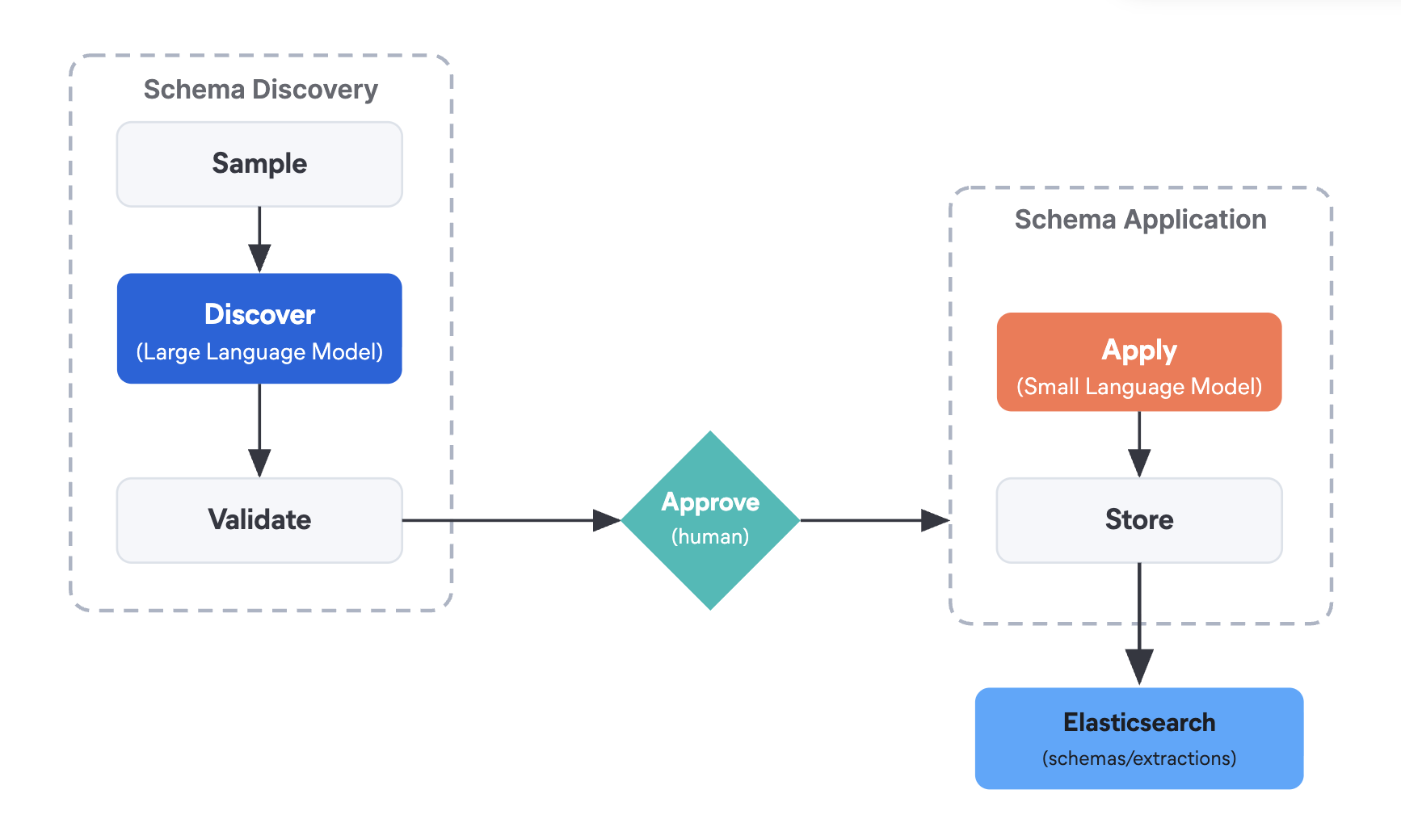

How two-tier LLM orchestration works
The workflow has two jobs: Decide what labels should exist, and then apply those labels to every report.
The first job is open-ended. A large model reads a varied sample of reports and proposes a small schema of categorical fields. A field is one way to describe the writer, such as attribution_style or procedure_orientation. Each field has a few allowed values, such as self_critical, system_attributing, or balanced.
The second job is repeatable. After a human approves the schema, a smaller model reads each report and chooses one value for each field.
We use Elastic Workflows because the steps are known ahead of time: sample reports, propose labels, wait for approval, classify every document, and store the results. Writing those steps in YAML makes the process reproducible, observable, and cheaper to rerun.

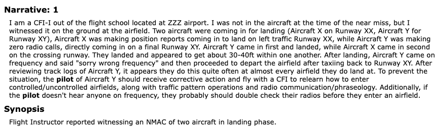

We’ll use the NASA ASRS database, which collects voluntary, anonymous incident reports from pilots, controllers, and mechanics. The dataset is public, and the reports are written as free-text narratives.
What we want to ask is:
What does this report reveal about the pilot who wrote it?
The planner reads a varied sample of reports and decides which distinctions are meaningful based on how the reports are actually written.
Step
Role
Model tier
sample
Pull a diverse subset of reports from the corpus.
(no LLM)
discover
Read the question and the sample, propose a schema of fields with enum values.
Large
approve
Human reviews the proposed schema and approves or edits it.
(Human via waitForInput)
apply
Iterate over the corpus, assign one value per field to each report.
Small
store
Write the schema and the per-document field values to Elasticsearch.
(No LLM)

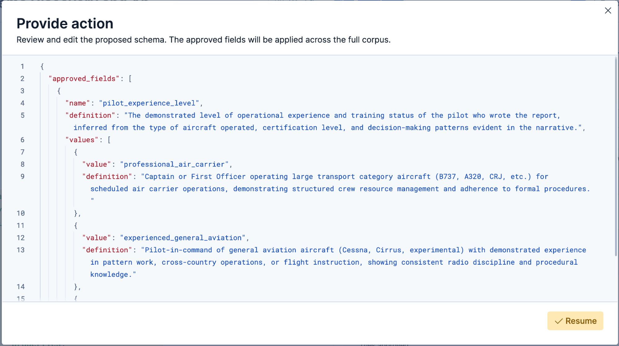

Human-in-the-loop schema approval with waitForInput
The proposed schema is now passed to a person for approval. Elastic Workflows has a waitForInput step that pauses the workflow with a schema, exposes a form, and resumes when the input is submitted.
waitForInput has no timeout of its own, so if nobody responds, the execution waits indefinitely. To put a limit on that, set a workflow-level settings.timeout; if it elapses before the reviewer submits the form, the execution is canceled.

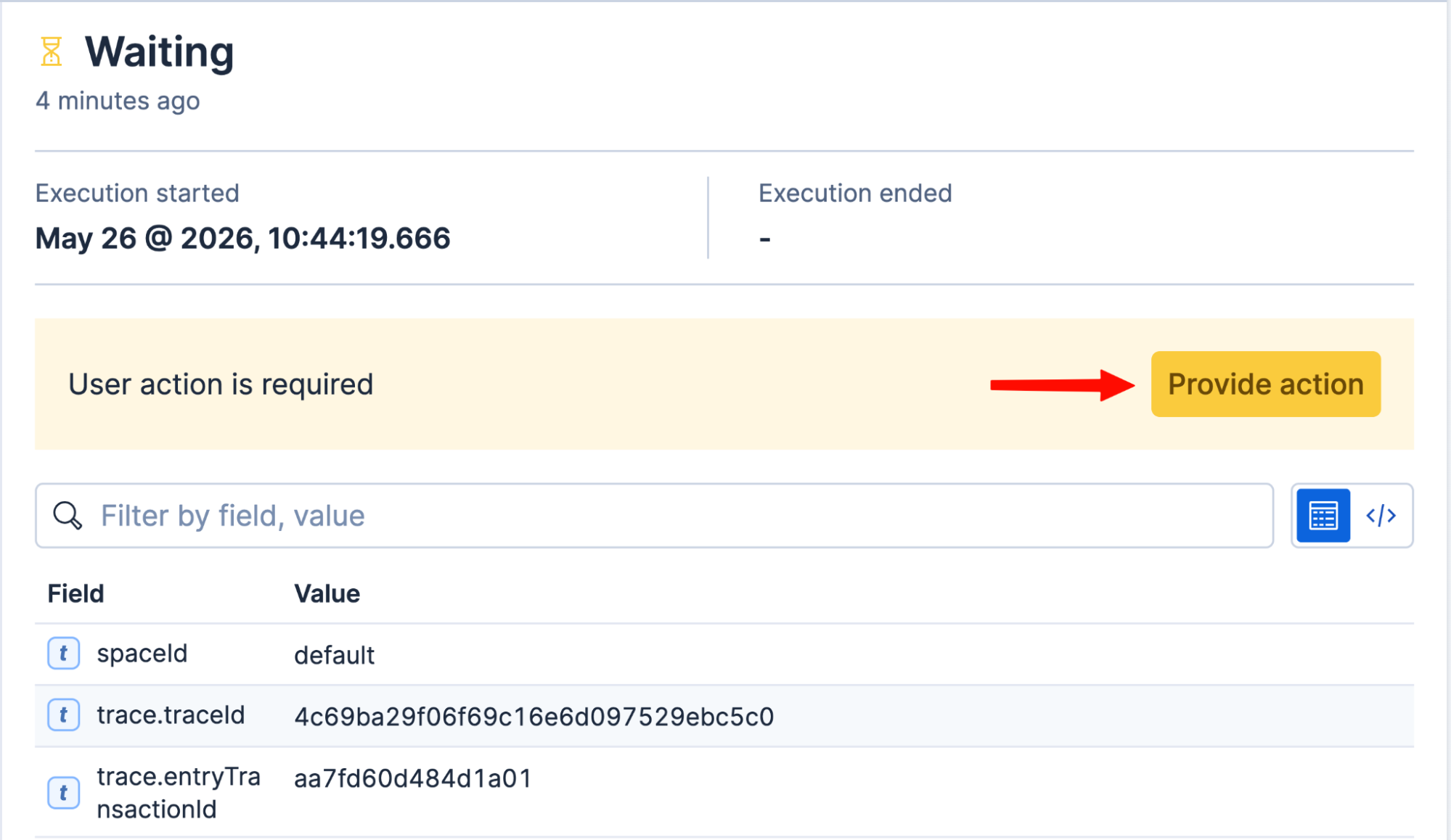

When the workflow reaches this step, the execution pauses and the Kibana UI shows an "Action is required" badge. Clicking Provide action opens a form where the reviewer can paste or edit the schema JSON. Since waitForInput cannot be prepopulated from a previous step, the code polls the discover step output and prints a paste-ready JSON block that can be copied directly into this form.

The step_output helper (in the notebook) polls the execution via GET /api/workflows/executions/{id} until the discover step completes and then returns its output.
Code JSON output pasted on Kibana:
The reviewer can keep useful fields, rewrite unclear ones, merge overlapping values, and add notes. After approval, the workflow resumes and sends the final schema to the executor step.
For a new corpus, keep this human gate in place. Once the schema is stable, you can auto-approve and only fall back to review when it’s worth it: Route just the low-confidence extractions to a person, or compare a new discovery run against the schema stored in the schemas index and trigger review only when fields or values change beyond a threshold.

Writing schemas and extractions back to Elasticsearch
The workflow produces two things: the approved schema and the per-document field values. The store_schema step runs right after the human gate, before the classification step fans out:
- name: store_schema
  type: elasticsearch.index
  with:
    index: schemas
    document:
      question: "${{ inputs.goal }}"
      approved_fields: "${{ steps.human_gate.output.approved_fields }}"
      reviewer_notes: "${{ steps.human_gate.output.notes }}"
Each extraction is written inside the foreach loop, so results are persisted as they’re produced rather than batched at the end.
The schemas index holds one document per discovery run (question, approved fields, reviewer notes). The extractions index holds one document per report per schema version.
