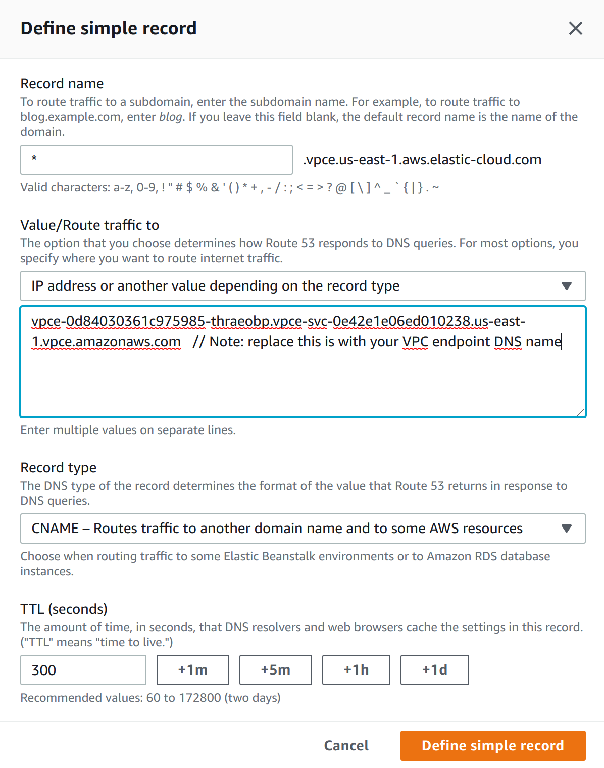

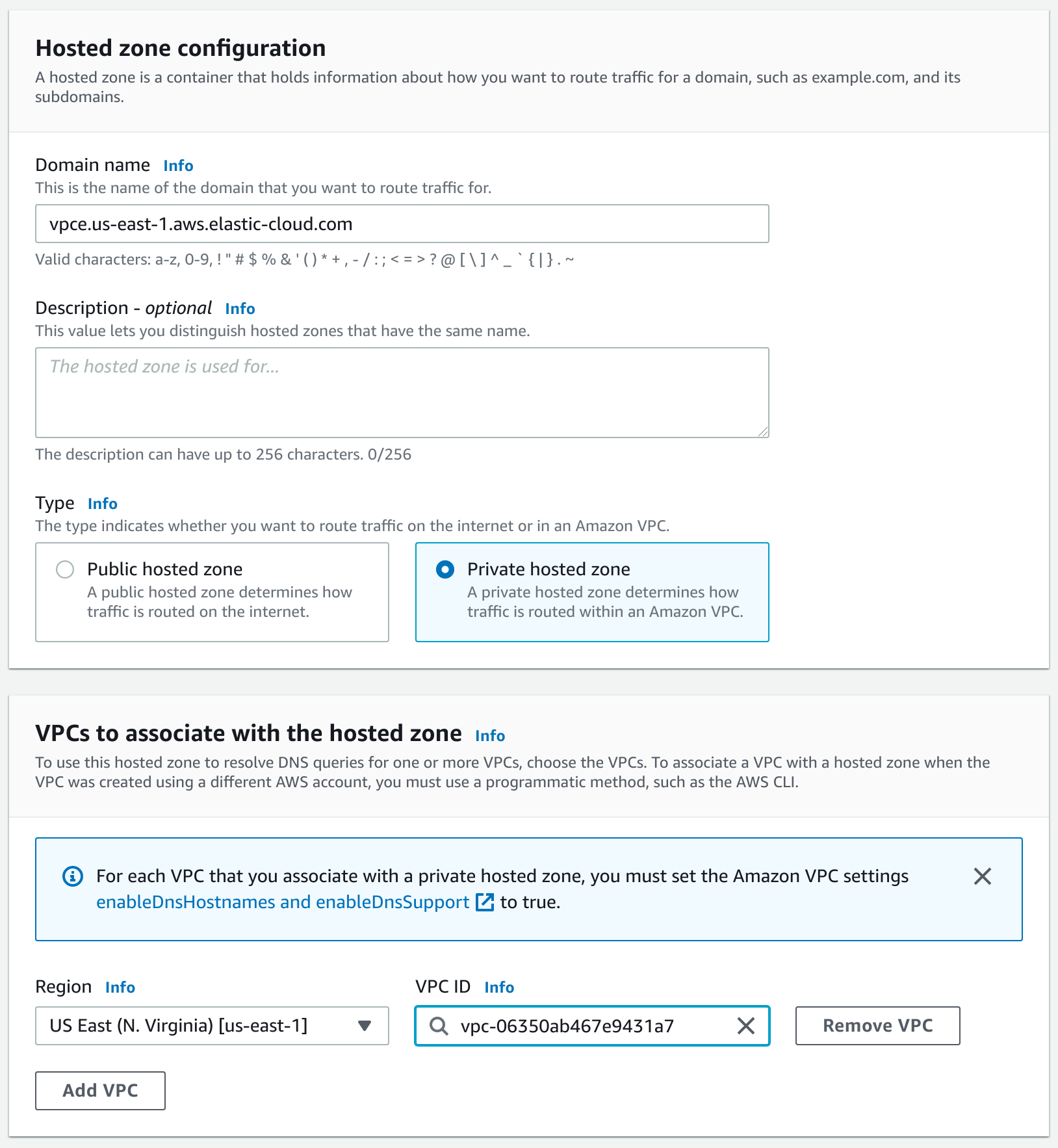

  2. Create a DNS record.
    1. Create a Private hosted zone. Consult Private hosted zone domain name in PrivateLink service names and aliases for the name of the zone. For example, in us-east-1 use vpce.us-east-1.aws.elastic-cloud.com as the zone domain name. Don’t forget to associate the zone with your VPC.
      Private hosted zone example
    2. Then create a DNS CNAME alias pointing to the PrivateLink Endpoint. Add the record to a private DNS zone in your VPC. Use * as the record name, and the VPC endpoint DNS name as a value.
      Follow the AWS instructions for details on creating a CNAME record which points to your VPC endpoint DNS name.
      PrivateLink CNAME

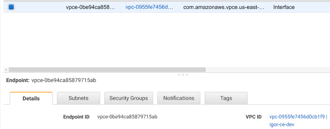

Finding your VPC endpoint IDedit
Having trouble finding your VPC endpoint ID? You can find it in the AWS console.
VPC Endpoint ID
