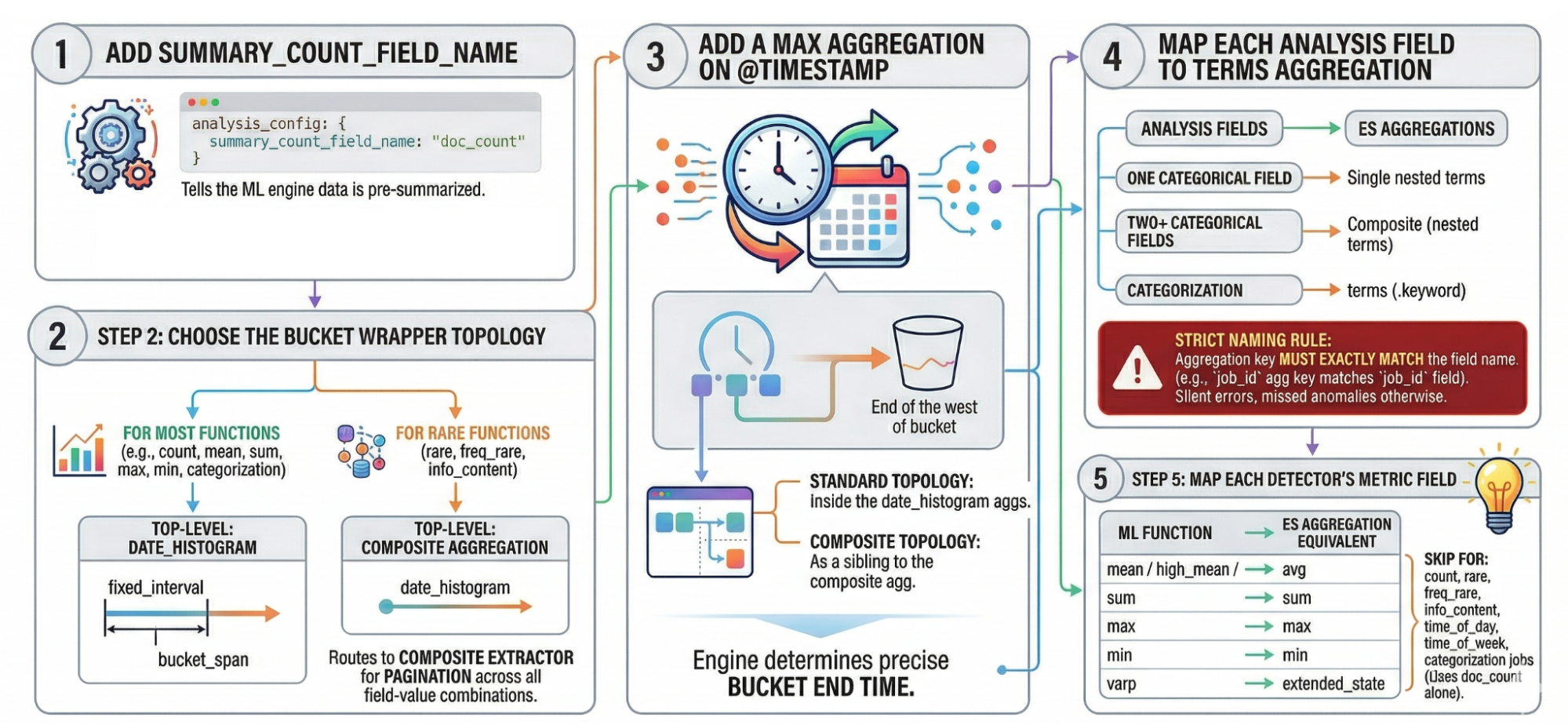

Converting any scroll-based job to an aggregation-based datafeed follows the same five steps. Once you understand the pattern, applying it to any compatible job takes about 10 minutes.
Flowchart illustrating how to configure Elasticsearch ML datafeed aggregations, showing steps for summary fields, bucket topology, timestamp handling, field mapping, and detector metrics.
Step 1: Add summary_count_field_name: "doc_count" to the analysis config. This tells the ML engine that incoming data is pre-summarized. Without it, the engine treats each aggregated bucket as a single raw document and produces wrong anomaly scores.
Step 2: Choose the bucket wrapper topology. For most functions (count, mean, sum, max, min, varp, time_of_day, time_of_week, and categorization) use a date_histogram at the top level whose fixed_interval matches your bucket_span exactly to ensure accurate analysis. For rare, freq_rare, and info_content, use a composite at the top level with a date_histogram as one of its sources. This routes the datafeed to the composite extractor, which paginates through all field-value combinations rather than truncating to a top-N.
Step 3: Add a max aggregation on @timestamp. The ML engine needs this to determine the precise end time of each bucket. In the standard topology (Step 2, date_histogram outer), it goes inside the histogram’s aggregations. In the composite topology, it sits as a sibling of the composite aggregation.
Step 4: Map each analysis field to a terms aggregation, named exactly after the corresponding field in the analysis config. One categorical field → a single nested terms. Two or more categorical fields → a composite aggregation nested inside the date_histogram, with one terms source per field. For categorization jobs, use a terms aggregation on the .keyword subfield of the categorization_field_name. The naming rule is strict: The aggregation key must exactly match the field name in the analysis config; the ML engine uses the aggregation name, not the field parameter, to look up values. A mismatch produces silently wrong results; no error, just a job that appears to run while missing everything meaningful.
Step 5: Map each detector’s metric field to its Elasticsearch aggregation equivalent:
ML function
`mean` / `high_mean` / `low_mean`
`avg`
`sum`
`sum`
`max`
`max`
`min`
`min`

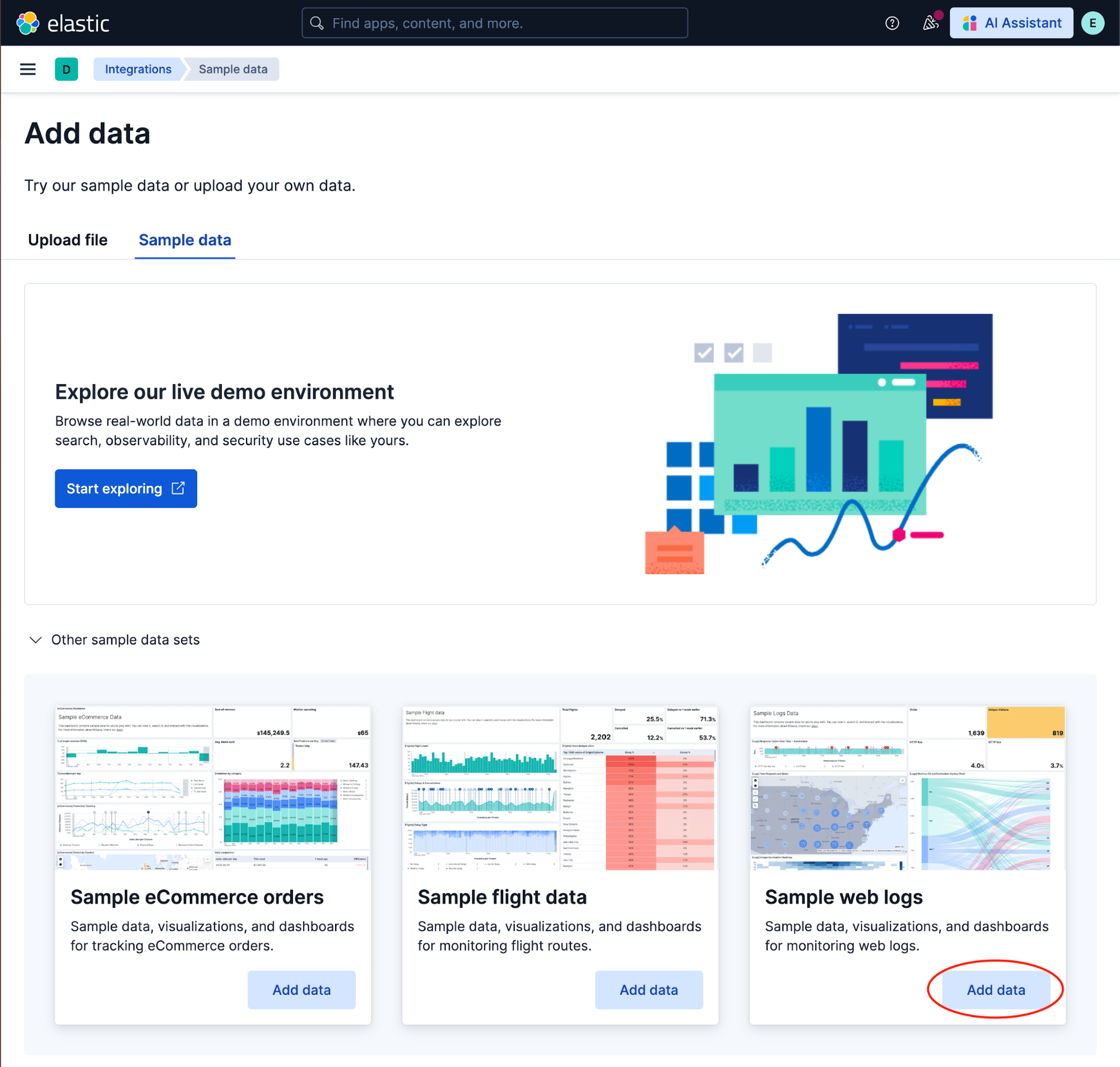

Let’s build this end to end using Kibana’s sample web logs. If you haven’t loaded them yet, go to the Kibana home page and click Integrations → Sample data → Sample web logs → Add data. This gives us a data view called Kibana Sample Data Logs and an index called kibana_sample_data_logs with fields including @timestamp, bytes (response size), and geo.dest (destination country).

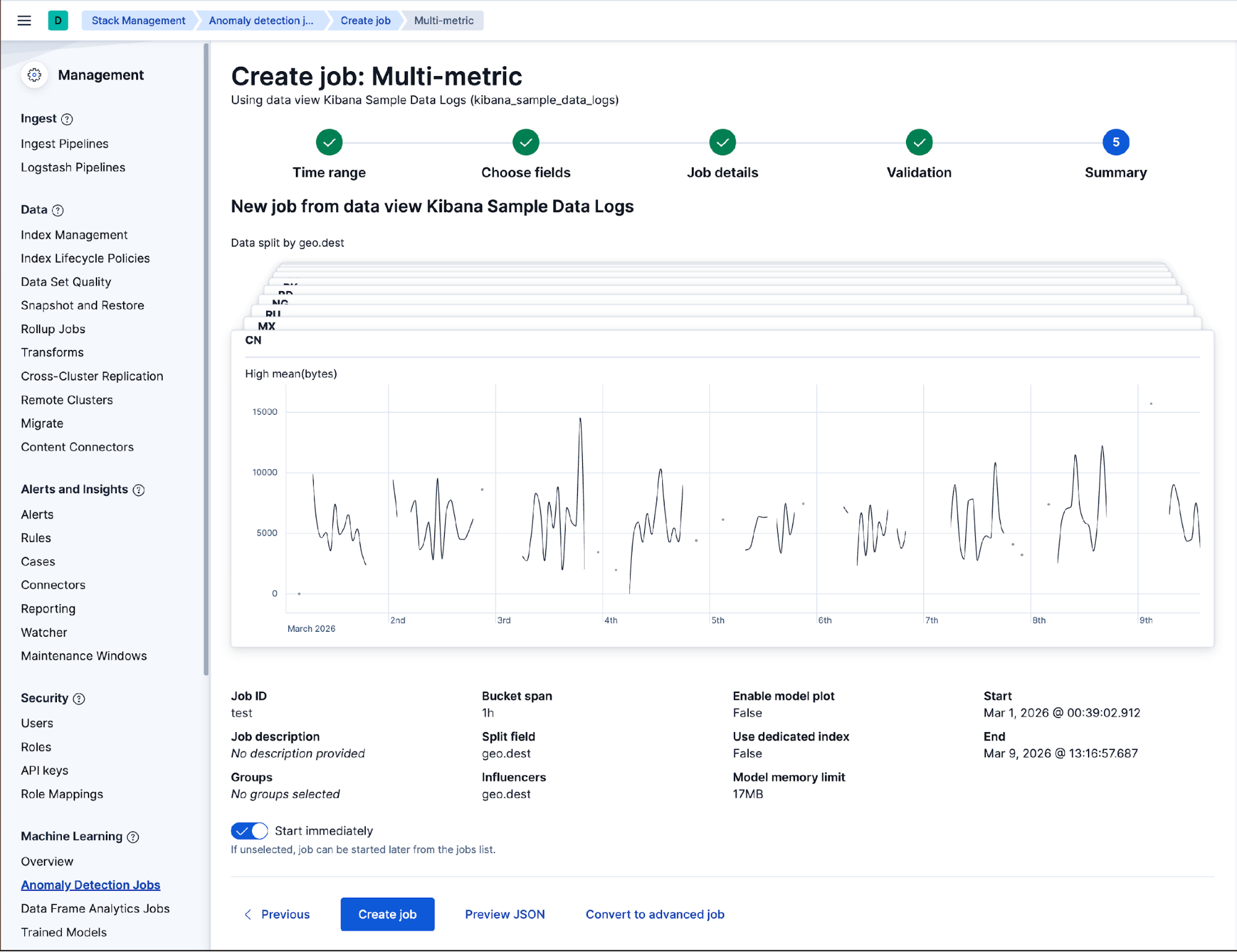

This is how most jobs get created in practice. Navigate to Machine Learning → Anomaly Detection → Manage Jobs → Create job.
Kibana interface showing the “Create job” step for anomaly detection, with a panel listing available data views and the “Kibana Sample Data Logs” option selected.

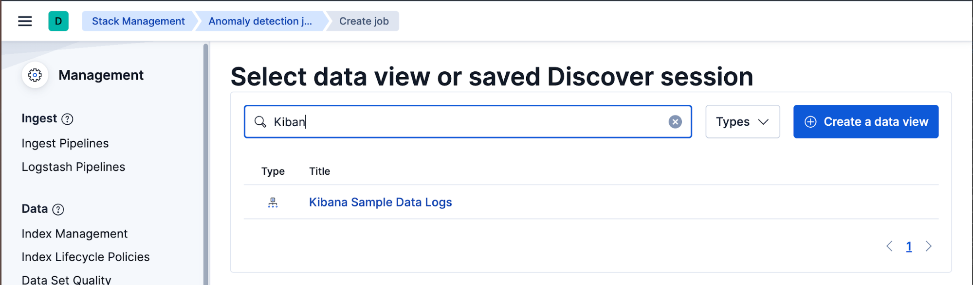

Select the “Kibana Sample Data Logs” data view, and set the time range to cover the full sample dataset. On the job type screen, choose Multi-metric.

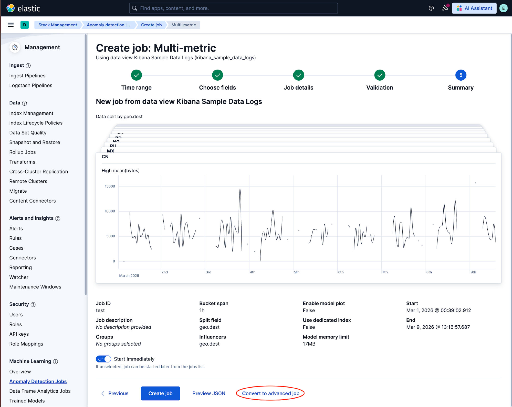

In the Multi-Metric Wizard, configure the detector:
  • High mean of bytes.
  • Split data by geo.dest.
  • Bucket span: 1h.
Kibana anomaly detection job summary showing a multi‑metric chart split by geographic destination and a configuration panel listing job ID, bucket span, split field, influencers, memory limit, and time range.

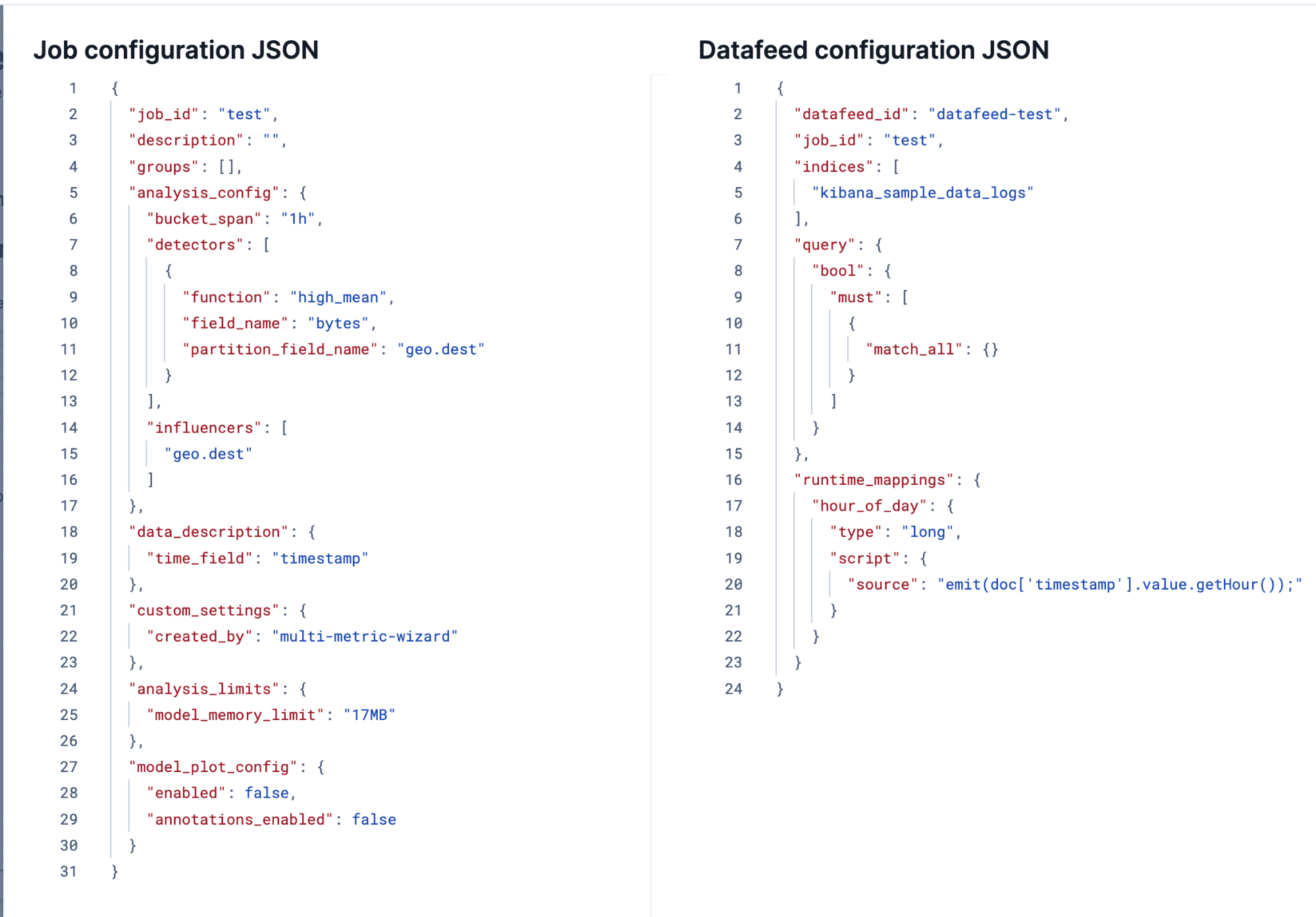

Give the job an ID, and leave everything else at its defaults, but don’t click Create yet. On this last configuration step, click on Preview JSON and look at the datafeed section. What you’ll see is a plain scroll-based datafeed with no aggregations, just an index pattern and a match_all query.

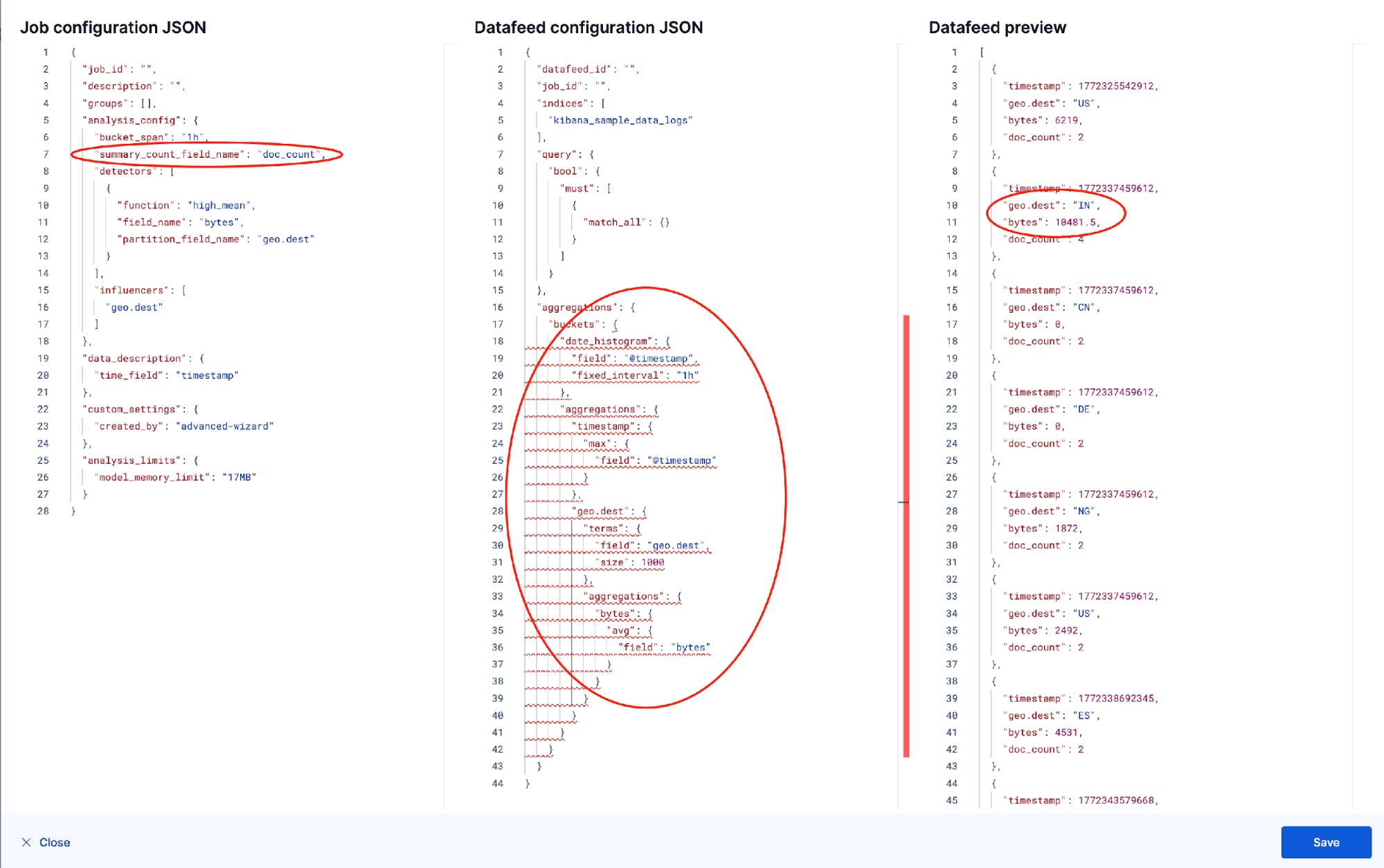

Side‑by‑side JSON showing an Elasticsearch ML job configuration and its matching datafeed configuration, including detectors, influencers, index selection, query, and runtime mappings.
This is the default every wizard produces. On a small cluster, it works fine. On a large cluster with CCS and a broad index pattern, this datafeed will scan every raw document on every run and never catch up with live data.
Instead of clicking Create, click Convert to advanced job. This keeps everything you just configured (the detector, the partition field, the bucket span) and drops you directly into the Advanced Wizard, where we can apply the five-step pattern.

Validate with the preview
Before we create the job, let’s use the Preview tab. This runs the aggregation against real data and shows exactly what the ML node will receive, a very useful sanity check before committing.
Three‑panel view showing an ML job configuration JSON, a matching datafeed JSON with aggregations, and a datafeed preview listing timestamped, bucketed results with fields like geo.dest, bytes, and doc_count.
Three things to verify in the preview output: doc_count should be present on every bucket and greater than 1. The bytes values should look like average response sizes: numbers in the hundreds to hundreds of thousands for web traffic. And each row should correspond to a distinct (timestamp, geo.dest) pair. If anything looks off, fix it in the JSON editor and rerun the preview.
