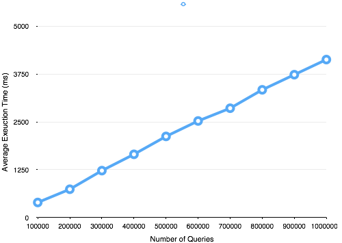

The 500 documents were percolated against query sets of increasing size. 10 tests were performed, starting with an index of 100,000 queries. For each test, the number of queries was increased by 100,000 up to a maximum of 1 million. Each test was therefore a superset of all the previous tests. The following illustrates the linear performance relationship of Percolator:
Figure 2 - Execution time vs Number of Queries
For the purposes of this example, we assumed we needed all document percolations returned in 1 second. The above relationship indicates each shard needs to evaluate at most 250,000 percolation queries to achieve this latency.
