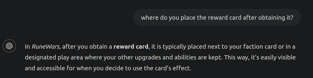

Runewars is a miniature game with a fairly complex set of rules explained in its 40 pages manual, and going back to play it after a few years since the last match means forgetting most of the rules. Let's try and ask ChatGPT (version GPT-4o) for some refreshers:
That's not just generic, it's wrong: reward cards must be hidden from other players. It's clear that it does not know the rules to this game, so let's augment the model with the rules!
Demo goal
Have an AI chat model able to answer questions relative to the Runewars rules, and provide the manual page where it found the information with the response. The code used to make all of this work is available on Github.
