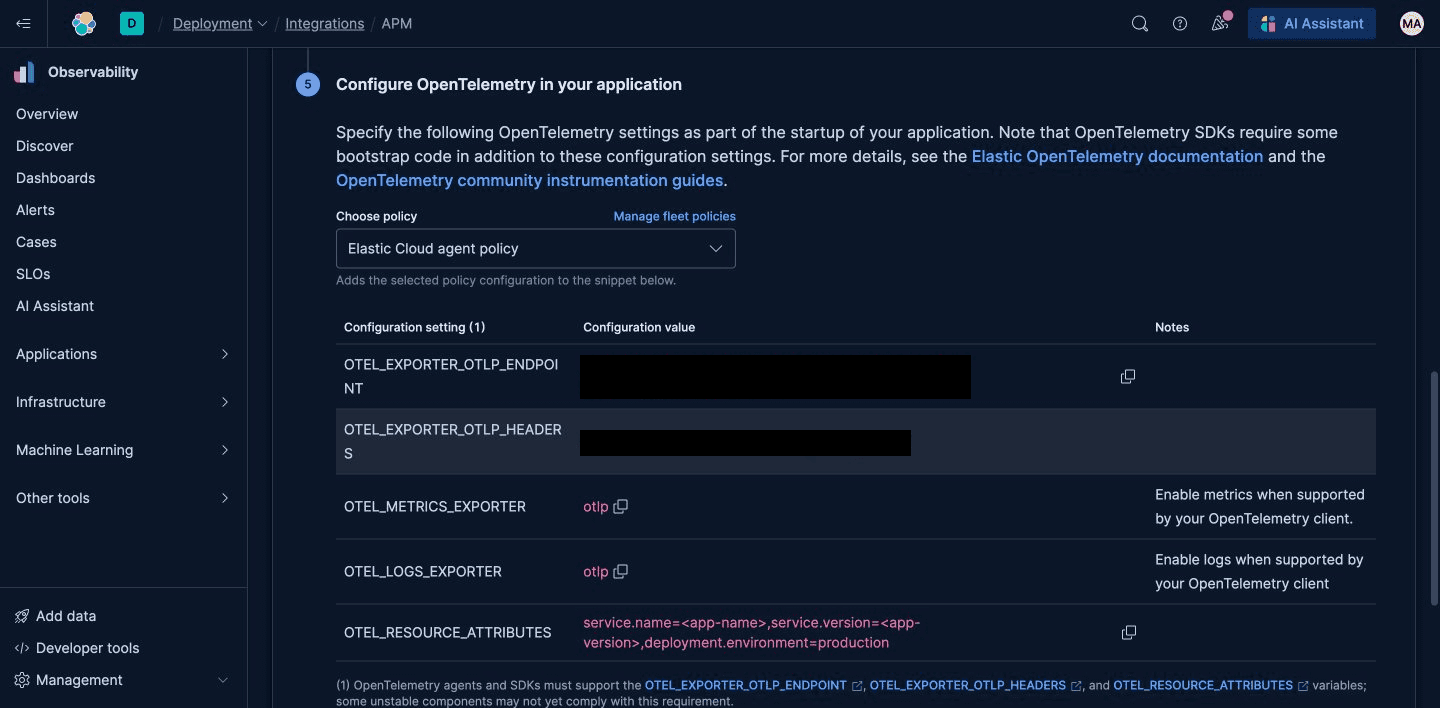

Configure the connection
OTel uses environment variables for connection configuration. You need four to get started:
Variable
Purpose
Example
`OTEL_EXPORTER_OTLP_ENDPOINT`
Managed OTLP (mOTLP) endpoint URL
`https://my-deployment.ingest.us-central1.gcp.elastic-cloud.com`
`OTEL_EXPORTER_OTLP_HEADERS`
Authentication
`Authorization=ApiKey <your-api-key>`
`OTEL_SERVICE_NAME`
Service name (shown in Kibana APM)
`search-analytics-demo`
`OTEL_RESOURCE_ATTRIBUTES`
Other resource attributes
`service.version=1.0.0`
Where to find these values: In Elastic Cloud, your mOTLP endpoint follows the pattern https://<deployment>.ingest.<region>.gcp.elastic-cloud.com. You can find it in the Elastic Cloud console under your deployment's details or in Kibana at the APM integration page (/app/home#/tutorial/apm) under the OpenTelemetry tab. Your API key can be created from Kibana's Stack Management > API Keys or via the Elasticsearch Create API Key API. For self-managed deployments, you can use the EDOT Collector as an intermediary that receives OTLP and forwards to Elasticsearch.
Set them in your environment or .env file:
export OTEL_EXPORTER_OTLP_ENDPOINT="https://my-deployment.ingest.us-central1.gcp.elastic-cloud.com"
export OTEL_EXPORTER_OTLP_HEADERS="Authorization=ApiKey <your-api-key>"
export OTEL_SERVICE_NAME="search-analytics-demo"
export OTEL_RESOURCE_ATTRIBUTES="service.version=1.0.0"

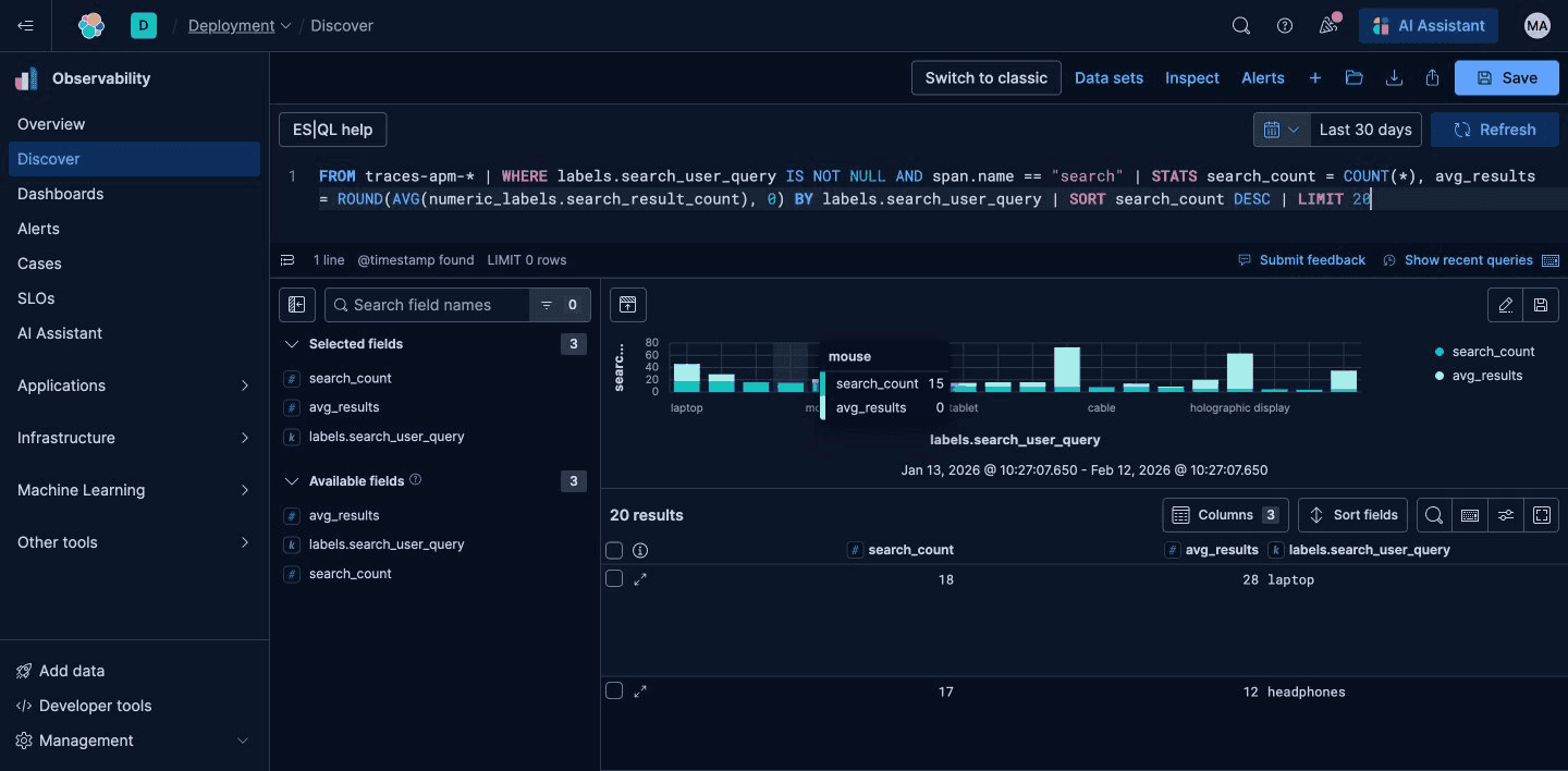

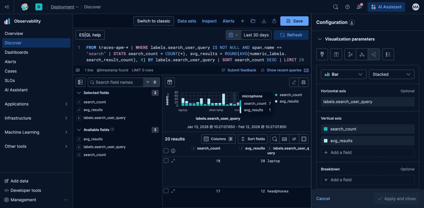

Running ES|QL queries in Kibana Discover
With spans flowing to Elastic, open Kibana and go to Discover (in the left sidebar under Analytics, or use the global search bar and type "Discover"). By default, you'll see the KQL query bar, a filter language familiar from Kibana dashboards. Click Try ES|QL in the top right to switch to the ES|QL editor. Unlike KQL (which filters documents) or the JSON query DSL (which requires nested objects), ES|QL is a piped language: Each | step transforms the previous output, making aggregations like STATS count BY field read naturally from left to right.
The editor gives you a full-width text area where you type piped queries. Results appear as both a table and an auto-generated chart; Kibana picks a sensible visualization based on your query shape. For STATS ... BY queries, you'll get a bar chart automatically.
Set the time range wide enough to capture your data (top-right date picker). If you're just getting started, try "Last 30 days".
Six ES|QL queries for search analytics
Everything below runs against traces-generic.otel-default, the index where Elastic's OTel-native ingestion automatically stores trace data. You don't need to create this index; it's provisioned by Elastic when the first OTLP span arrives.
These queries ran against our live demo cluster: 62 searches, ~20 distinct queries, latency range 77ms–153ms.
Note: Results below are illustrative. When you run the reference project and generate traffic with python generate_traffic.py --blog 2 --sessions 50, your exact numbers and top queries will vary based on session count and random query selection. The query patterns and ES|QL syntax are what matter here.

Query 2: What are users searching for?
The first question every search team asks.
FROM traces-generic.otel-default
| WHERE attributes.search.query IS NOT NULL
  AND attributes.search.query != ""
  AND name == "search"
| STATS
    search_count = COUNT(*),
    avg_results = ROUND(AVG(attributes.search.result_count), 0)
  BY attributes.search.query
| SORT search_count DESC
| LIMIT 20
Results:
Query
Searches
Average results
laptop
9
8
headphones
7
12
running shoes
6
5
"laptop" was the most popular query, with nine searches. There were around 20 distinct queries total (including zero-result ones).
The avg_results column tells you whether popular queries are actually returning content. A query with high volume and low results is a relevance problem worth investigating. If your query has high volume and high results, check whether users are actually clicking. We'll get to that in the next blog focussing on measuring search quality with click data.

If no rows appear, check in order:
  1. OTEL_EXPORTER_OTLP_ENDPOINT points to the mOTLP endpoint, not your Elasticsearch URL.
  2. OTEL_EXPORTER_OTLP_HEADERS includes Authorization=ApiKey <your-key>.
  3. OTEL_TRACES_SAMPLER=always_on is set (default sampler may drop spans).
  4. Kibana → Observability → APM → Services shows search-analytics-demo (confirms export is working).
Turn ES|QL results into Kibana visualizations
The bar chart that Discover auto-generates from your ES|QL results is a good start, but you can customize it. Click the pencil icon in the top-right corner of the chart to open the inline Lens editor.
From here you can:
  • Change chart type (bar, line, area, pie, table, metric).
  • Adjust axes and add breakdown dimensions.
  • Save the visualization to a dashboard.
This is the path from ad hoc ES|QL exploration to a persistent dashboard panel. You don't need to build visualizations from scratch; Discover and Lens handle the chart rendering from your query results.
