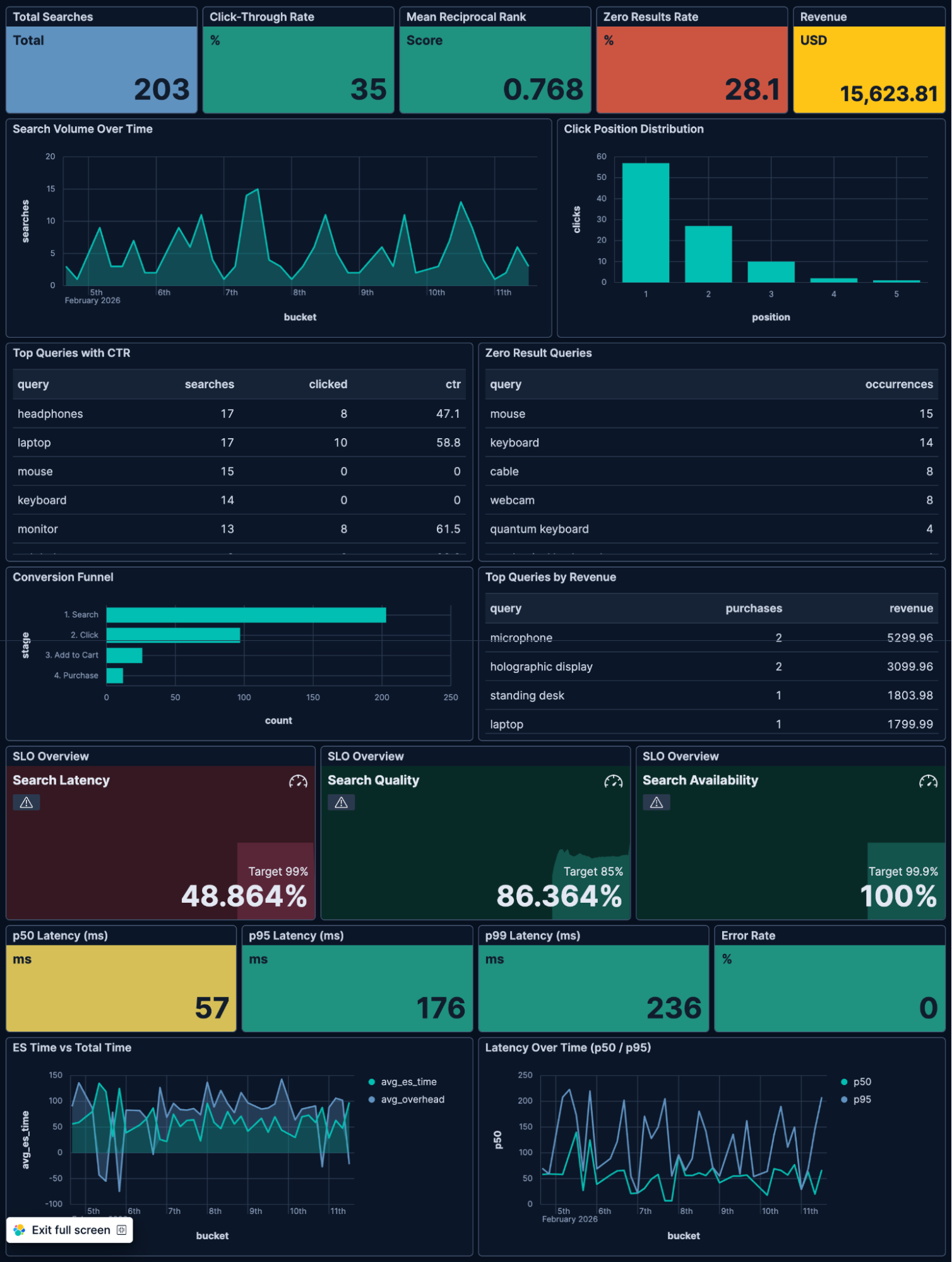

You can turn this into a funnel visualization using Kibana Lens. Run each stage count as a separate ES|QL query, save them as dashboard panels, and arrange them as a horizontal bar chart with the four stages on the y-axis and counts on the x-axis. The drop-off at each step becomes immediately visible.
The dashboard above (from the first blog in the series) shows this in practice: The Conversion Funnel panel in the lower left uses a horizontal bar chart to visualize the four stages, and the Top Queries by Revenue table alongside it shows revenue attribution. You can build these directly from the ES|QL queries in this post.

Revenue attribution by search query
Here's the query your product manager actually wants:

This gives you a ranked list of queries by the revenue they generated. The search.query attribute on purchase spans (the denormalization we discussed earlier) makes this a single aggregation query, without joins or subqueries.
How to act on search revenue  data
  • Protect high-revenue queries. If "laptop bag" generates the most revenue, any relevance change that affects that query gets extra scrutiny. You might add it to a regression test suite or pin specific results with query rules. You might even set up an alert when its conversion rate drops (Blog 6).
  • Prioritize relevance investment. The queries at the top of this list are where relevance improvements have the most business impact. A 10% CTR improvement on a query that generates $500/month in revenue is worth more than a 50% improvement on one that generates $20.
  • Identify missed opportunities. Cross-reference with the top-queries data from Blog 2. A query with high search volume but no purchase attribution is either a browsing query (informational intent) or a conversion gap worth investigating.
Top revenue queries: where to focus relevance investment
To focus your relevance team's efforts, pull the top revenue-generating queries:
FROM traces-generic.otel-default
| WHERE attributes.search.action == "purchase"
  AND attributes.search.query IS NOT NULL
| STATS
    purchases = COUNT(*),
    revenue = SUM(attributes.checkout.total_amount)
  BY attributes.search.query
| SORT revenue DESC
| LIMIT 10
Cross-reference this with the per-query CTR from Blog 3. A query with high revenue but low CTR is underperforming; even small relevance improvements have outsized business impact. A query with high CTR but no purchase attribution might be informational (such as users browsing but not buying). The queries at the top of both lists deserve the most attention from your relevance team.
