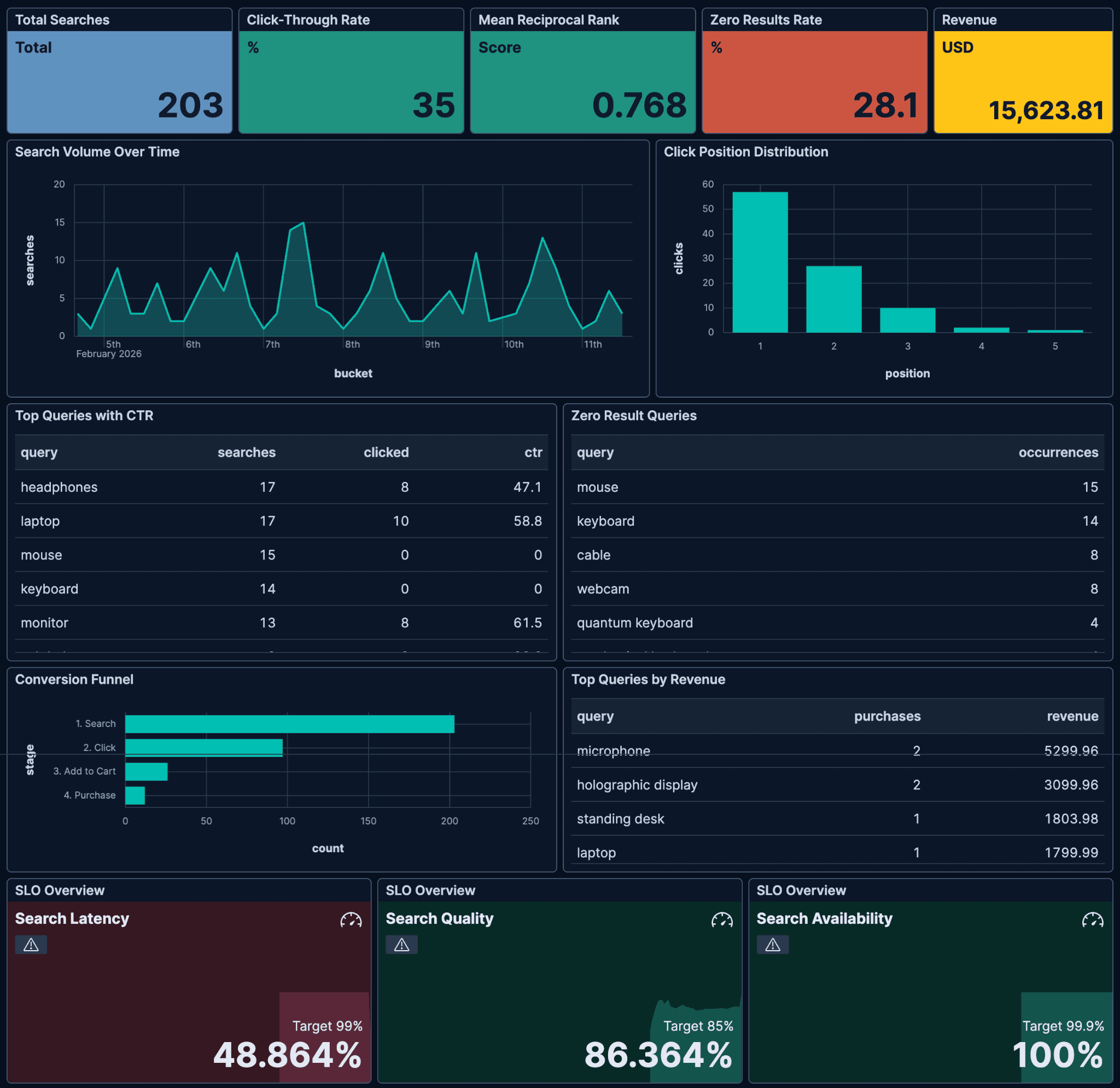

Here's what this looks like in practice. This Kibana dashboard is powered entirely by OTel traces and ES|QL, with no custom pipeline or separate analytics service:
Every panel on this dashboard comes from the same index. The headline metrics use value-based coloring to surface health at a glance: CTR and MRR are green (healthy), while the Zero Results Rate is red (needs attention). Below, you can see which queries drive the most clicks, which ones return nothing, and how searches convert through the funnel to revenue.

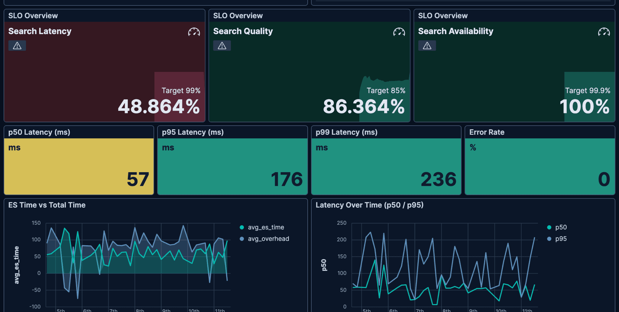

Notice the SLO cards at the bottom, with targets like "99% of searches under 250ms" that let you track reliability as a measurable commitment. That's a hint at something bigger.

The same traces that calculate your CTR also give you operational visibility, without requiring any extra instrumentation:
The search dashboard's SLO cards track three targets: your search latency target (99% under 250ms), search quality (85% returning results), and availability (99.9% success rate). Below them, latency percentiles use the same value-based coloring. Green means healthy, yellow means watch it, and red means needs attention.
The operational charts break down where time is spent (Elasticsearch query time versus application overhead) and how latency trends over time. All of this comes from the same search.* attributes you added for analytics, and no extra instrumentation is required.
