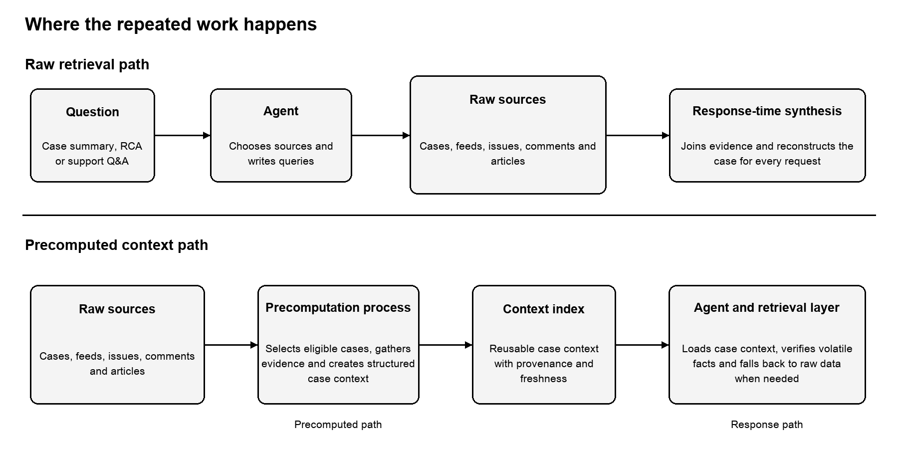

The next question about the same case or about a related case often required much of the same orientation and synthesis work. That repetition consumed input tokens and added latency. It also increased the chance of invalid queries or wrong source selection.
Earlier work on precomputed context provided a starting point. It described extracting useful context ahead of time and storing it as structured Knowledge Indicators (KIs). Then it explained how an agent retrieves those compact records before scanning raw documents.
For this support use case, we wanted to understand what context was worth preparing in advance and how the choice of context affected response efficiency and reliability. We also wanted to know what retrieval rules were needed when an agent could use several KI types. This article follows that design process and reports the findings.

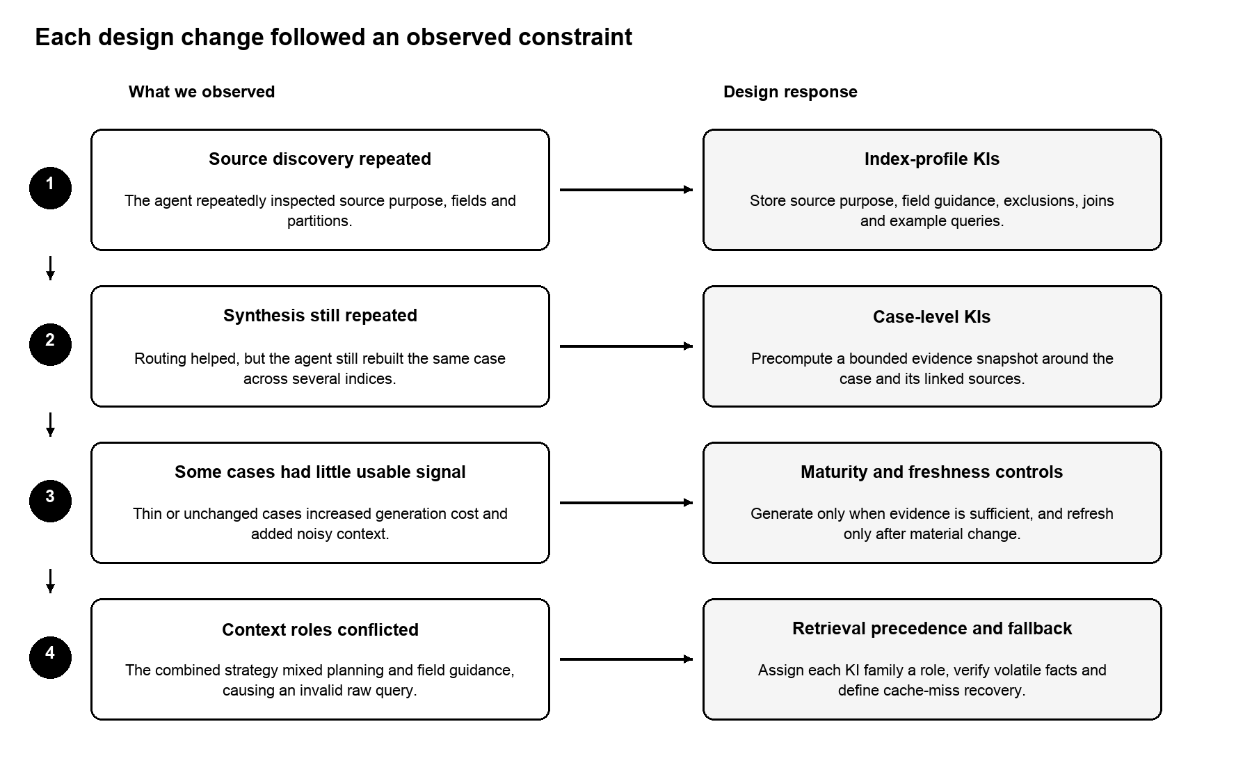

Starting with index profiles
We began with index profile KIs. A workflow read each support index mapping and sampled a few documents. It generated a compact profile describing the index’s purpose, the questions it could answer, important fields, exclusions, verified joins, time coverage, example Elasticsearch Query Language (ES|QL) queries, and more. A representative KI document with selected fields looked like this:

The profiles helped the agent choose a source and form a query. They reduced orientation work, especially when index or field names were unclear, but they didn’t remove the main cost of a case investigation. After selecting the indices, the agent still had to gather the case record and reconstruct the conversation. They also still had to follow links to engineering and knowledge sources and then reconcile the evidence. Routing was useful, but the repeated work was synthesis.
Changing the unit of context
That observation led to case-level KIs. The workflow materializes one evidence-aware snapshot per eligible case. It gathers the case record, recent material conversation events, linked engineering issues and comments, and linked knowledge articles. The resulting KI document contains a stable case identifier and source references. It also contains tags and freshness metadata.
The design became more detailed as we worked through support specific nuances. Support conversations contain provisional theories, later corrections, administrative status changes, and occasionally separate incidents inside one case. A single fluent summary can flatten those distinctions. The case schema therefore records incident phases, a hypothesis ledger with confirmed, inferred, contradicted, and unresolved states, root cause status and confidence, technical outcome, reusable learning, and more.

Figure 1. The workflow grew in response to observed constraints. Each addition addresses a specific source of repeated work, noise, or retrieval failure.

After a few iterations, we realized that generating a KI for every case adds cost and noise. Many cases have little usable evidence. In some, there’s only a short intake message; in others, there’s no substantive feed or acknowledgement from a support engineer. So we added gates and filters to the workflow. For example:
  • A case proceeds when it has linked engineering evidence or at least two material conversational events, including evidence of support participation.
  • The workflow compares the stored KI watermark with the newest timestamp across the case and its material feed. An unchanged case reuses its existing KI instead of regenerating it every time.
  • The workflow limits corpus selection by focusing generation on recent cases or those otherwise likely to be queried, especially when the source corpus is large.
  • The workflow also refreshes the case KI when linked sources can change independently, rather than relying on an incomplete watermark.
Deferred cases remain available through raw lookup and can be reconsidered after new activity arrives. Provenance is part of the stored KI: References point back to linked sources, and the output records what was missing or unverifiable. The KI shortens routine investigation, while raw records remain available for current status, complete history, attachments, and evidence outside the generated snapshot.
Figure 2. Case-level context moves repeated evidence gathering into a precomputed workflow. The response path keeps raw verification and fallback available.

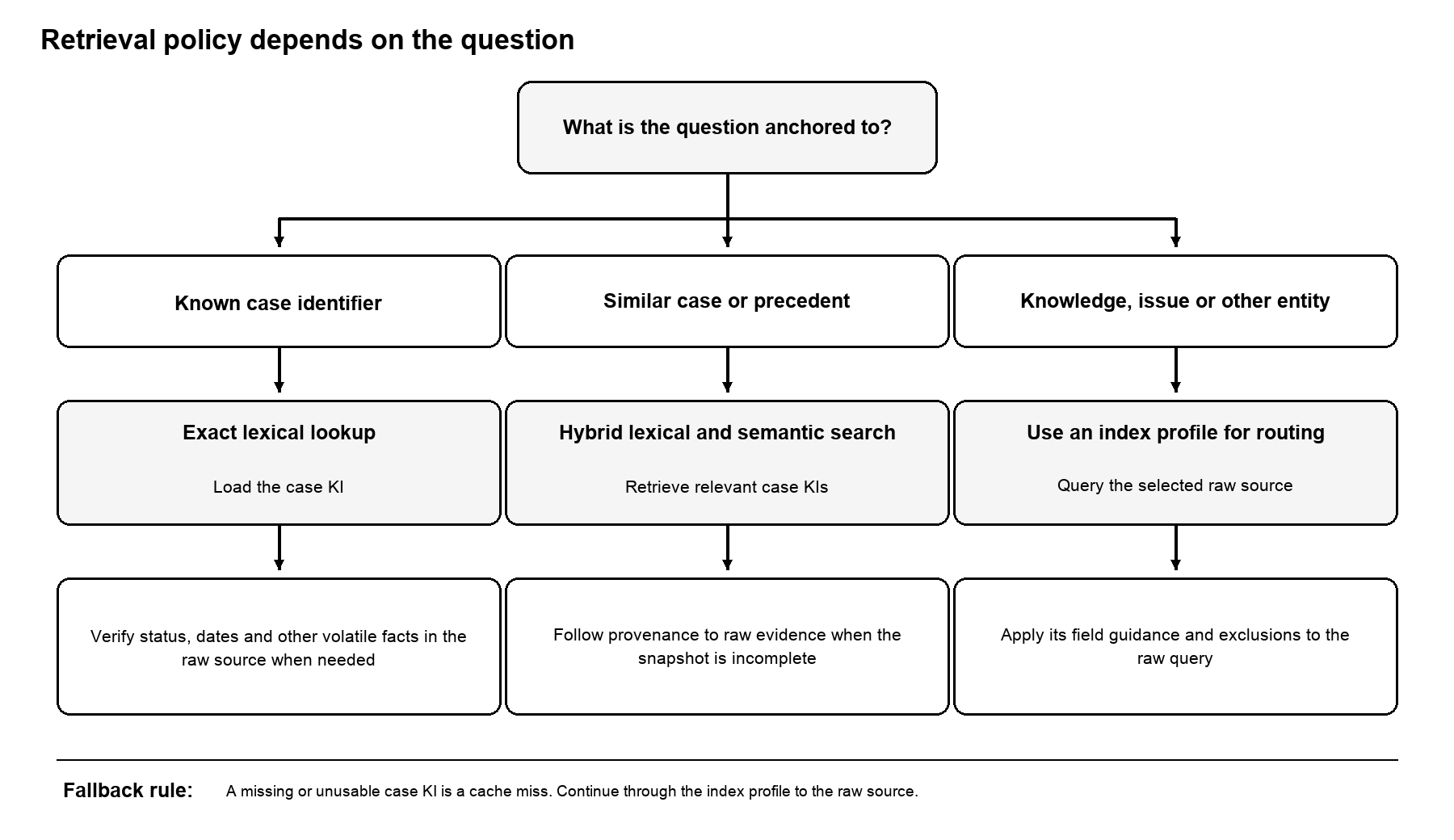

The retrieval skill is part of the system
While workflows generate KIs, the agent requires retrieval guidance to use them effectively. To address this, we developed a retrieval skill which provides ES|QL templates for querying KIs stored in the index and guidance on when to use each retrieval method. For instance, a known case number is searched lexically because it’s an exact identifier. Questions about similar cases or precedents use hybrid lexical and semantic retrieval, while questions about official knowledge, engineering issues, comments, or other non-case entities begin with an index profile and then query the selected raw source.
The skill also assigns a clear role to each KI family. An index profile provides routing and field guidance, while a case KI provides a bounded snapshot of the evidence relevant to one case. If no case KI is available, the agent treats that as a cache miss and follows the index profile guidance back to the underlying data, rather than assuming that the available context is complete.
That distinction matters during a typical case lookup. For a question such as What is the current priority of case 1234567?, the agent retrieves the case KI by case _id to understand the investigation and its supporting evidence. It then checks the live case record for values that can change, including status and priority, along with updated_at. If the live record is newer than the KI’s last update, the live value takes precedence. The KI remains useful for durable evidence, while the source record remains the reference for current state. The next eligible refresh rebuilds the KI using timestamps from the case and its material feed, in addition to linked sources.
This separation was shaped by an evaluation failure. In an earlier version, the agent used the case KI to plan retrieval but issued a raw source query using an inferred schema instead of the fields supplied by the index profile. The query failed, causing retries and additional model work. Later versions of the skill made the precedence rules, source roles, field guidance, and recovery steps for mapping errors explicit.
Figure 3. The retrieval skill routes by question type. Exact case lookup, precedent search, and non-case retrieval use different context paths, with raw evidence available for verification and fallback.

The combined strategy exposed a composition problem
While evaluating the responses, we made a counterintuitive observation: Providing both index profiles and case KIs didn’t improve on using case KIs alone. Inspection of the trace showed that the agent understood some of the case context but lacked a dependable rule for composing the two KI families. It used a case-level KI for planning but then ignored the index profile’s schema guidance when querying raw data, leading to failures and suboptimal responses.
This resulted in a practical lesson for improving guidance in the retrieval skill: Context sources need roles and precedence. The agent must know which source can support an answer, which source only routes to evidence, when verification is required, and what to do after a cache miss or mapping error. Two individually useful context types can create additional work when those contracts are implicit.
