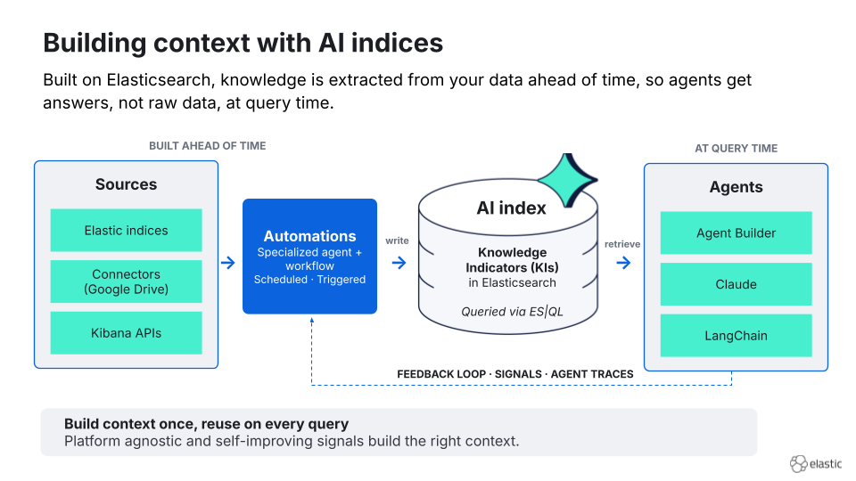

Context Engine consists of five components, as shown in the following image: sources, automations, AI index, agent memory (agents), and the feedback loop.
Within Elastic, we’re developing a context engine to deliver the boosts in accuracy and efficiency that agents need. Let’s explore each component in detail.
Sources
Context can come from any Elasticsearch index or data stream, so you build it where your data already lives. It can also come from external applications and data sources, through connectors, and from agent traces captured in Agent Builder or sent from other agent frameworks over OpenTelemetry (OTel).
How automations build context
Automations populate the AI index. They're Elastic Workflows with specialized steps that search raw content, process results with a large language model (LLM) or other models, structure the output for retrieval, verify provenance, apply access control, track state, and write KIs to the AI index.
You don't have to write them from scratch. A setup agent looks at your connected sources and suggests automations. They can run on small, inexpensive models or plain ES|QL, which keeps build costs low while the savings show up on every query afterward.
The AI index, built on the Elasticsearch vector database
The AI index is the context store. It runs on Elasticsearch as a vector database and includes ES|QL and hybrid search. It holds the KIs that automations produce. Its schema and mappings are designed for agents to retrieve from.
How agent memory works
As users complete tasks, agents can store and retrieve memories with remember, recall, and forget tools. Memory consolidation and organization-wide sharing are next on the roadmap.
How agent traces feed back into context
Every agent interaction produces a trace that records how the agent worked through the task, including where it succeeded and where it got stuck, in addition to where it spent tokens. The feedback loop looks for inefficiencies in these traces and suggests changes to your automations, so KIs improve from real usage as well as from any test set you wrote up front.

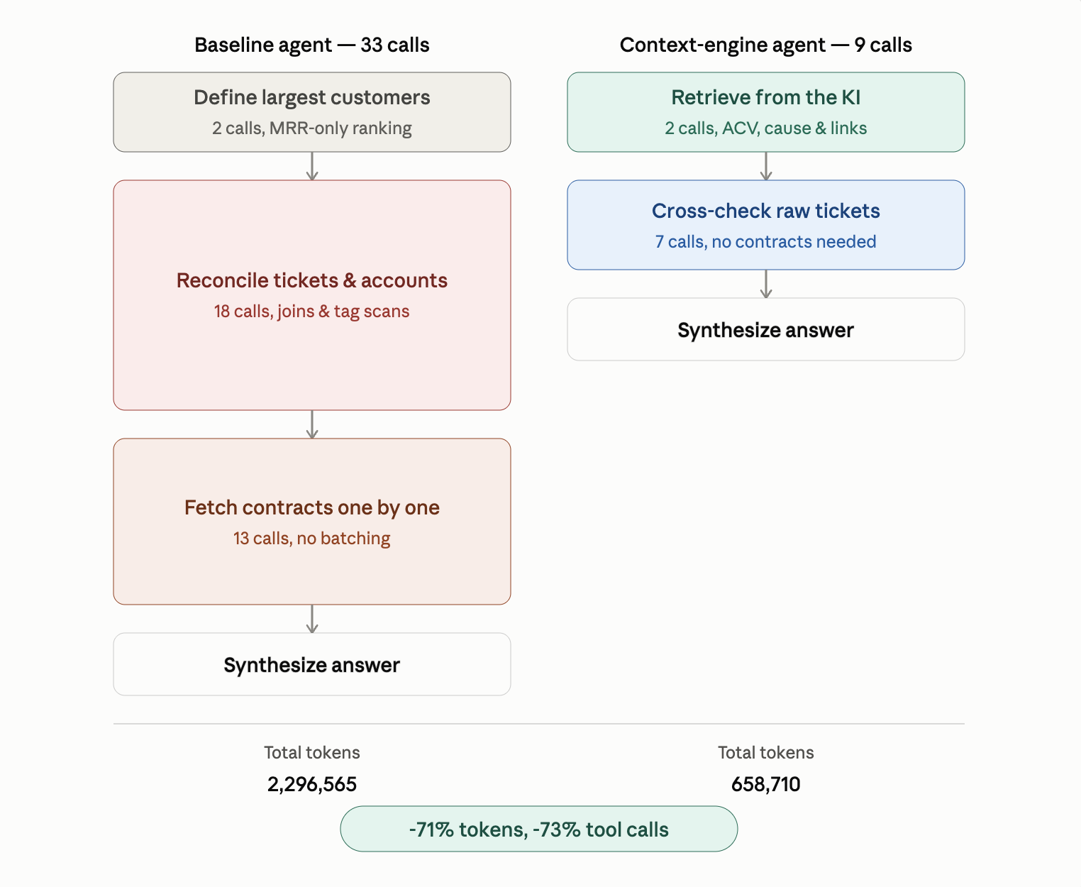

How the baseline agent spent 33 tool calls
By using the following request, Give me a summary of the issues hitting our largest customers, the baseline agent:
  1. Ran discovery, looking at each data source, its fields, and sample documents to learn the structure.
  2. Worked out what "customer" means in the data (there are subscribers and contracted accounts) and how to define "largest" (there are fields for annual contract value [ACV] and monthly recurring revenue [MRR]).
  3. Queried the tickets index to find problems.
  4. Pulled the full text of every contract that mentioned an affected customer, looking for relationships to other organizations.
The baseline spends 18 calls reconciling tickets against accounts and 13 more fetching contracts one at a time. The Context Engine Agent reads the account relationships once and then spends seven calls checking the raw tickets.
The discovery and contract reads are the expensive part, and they account for most of the token cost in the baseline run.
What changed with the context layer
With the AI index, the agent started with knowledge that automations had precomputed. It already knew which fields identify customers and which define the largest ones. The entity KIs also captured relationships from the raw contract text, such as one parent company sitting over several smaller ones. Reading the KIs up front let the agent skip the expensive queries and full document scans, and run lightweight checks against the original data instead. As a result, the run used 71% fewer input tokens, and the context window stayed free of noise.
