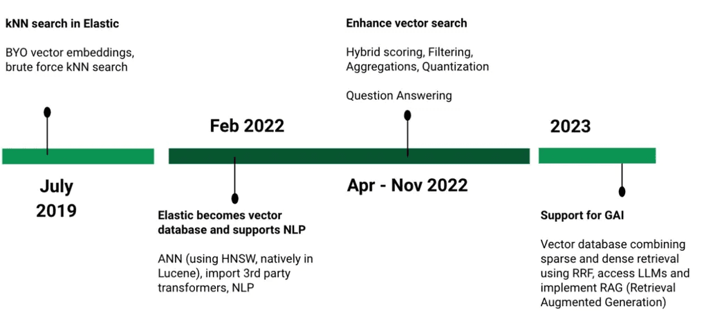

Timeline
After enabling brute-force kNN search on dense vectors in 7.0 back in 2019, Elasticsearch started supporting approximate nearest neighbors (ANN) search in February 2022 with the 8.0 release and hybrid search support came right behind with the 8.4 release in August 2022. Figure 1, below, shows the Elasticsearch timeline for bringing hybrid search to market:
Figure 1: Hybrid search timeline for Elasticsearch

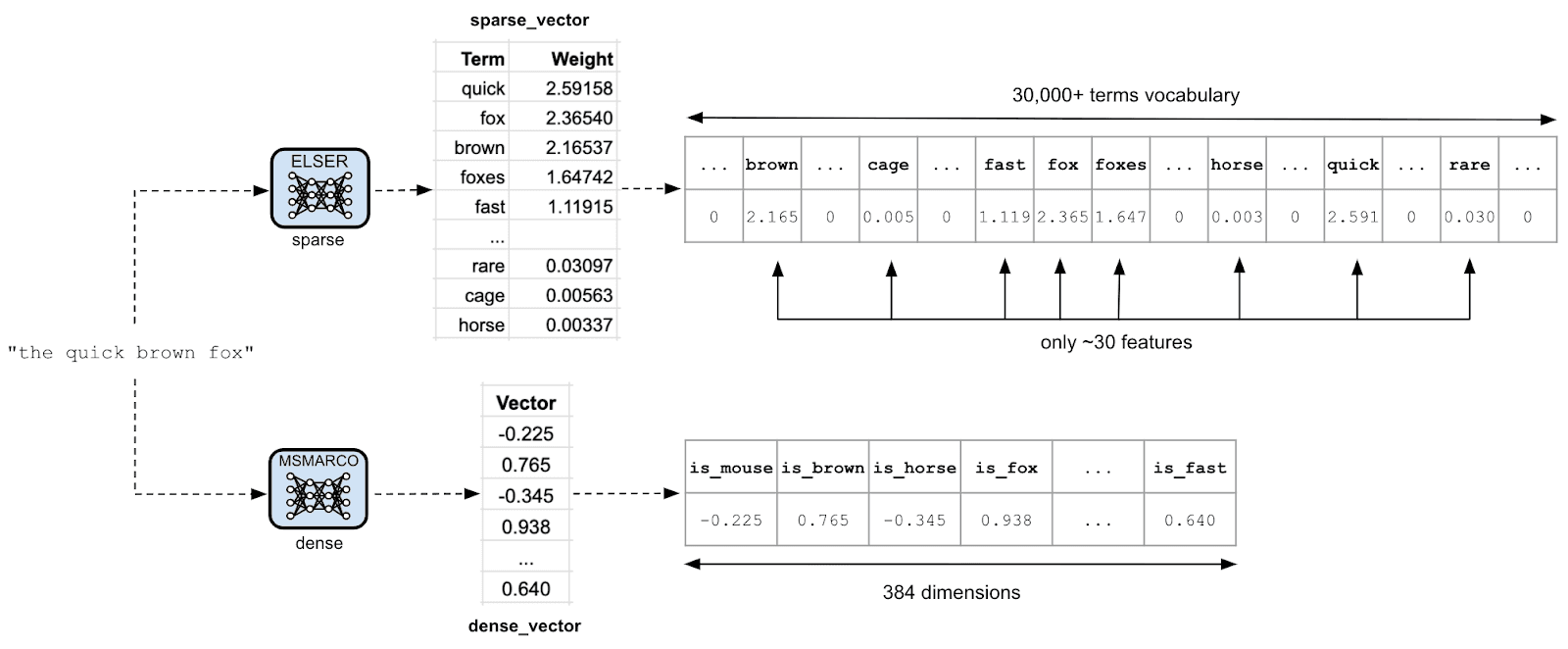

Sparse or dense?
Before heading over to hybrid search queries, we would like to briefly highlight the differences between sparse and dense models. Figure 2, below, shows how the piece of text “the quick brown fox” is encoded by each model.
In the sparse case, the four original terms are expanded into 30 weighted terms that are closely or distantly related to them. The higher the weight of the expanded term, the more related it is to the original term. Since the ELSER vocabulary contains more than 30,000 terms, it means that the vector representing “the quick brown fox” has as many dimensions and contains only ~0.1% of the non-zero values (i.e., ~30 / 30,000), hence why we call these models sparse.
Figure 2: Comparing sparse and dense model encoding
In the dense case, “the quick brown fox” is encoded into a much smaller embeddings vector that captures the semantic meaning of the text. Each of the 384 vector elements contains a non-zero value that represents the similarity between the piece of text and each of the dimensions. Note that the names we have given to dimensions (i.e., is_mouse, is_brown, etc.) are purely fictional, and their purpose is just to give a concrete description of the values.
Another important difference is that sparse vectors are queried via the inverted index (yes, like lexical search), whereas as we have seen in previous articles, dense vectors are indexed in specific graph-based or cluster-based data structures that can be searched using approximate nearest neighbors (ANN) algorithms.
