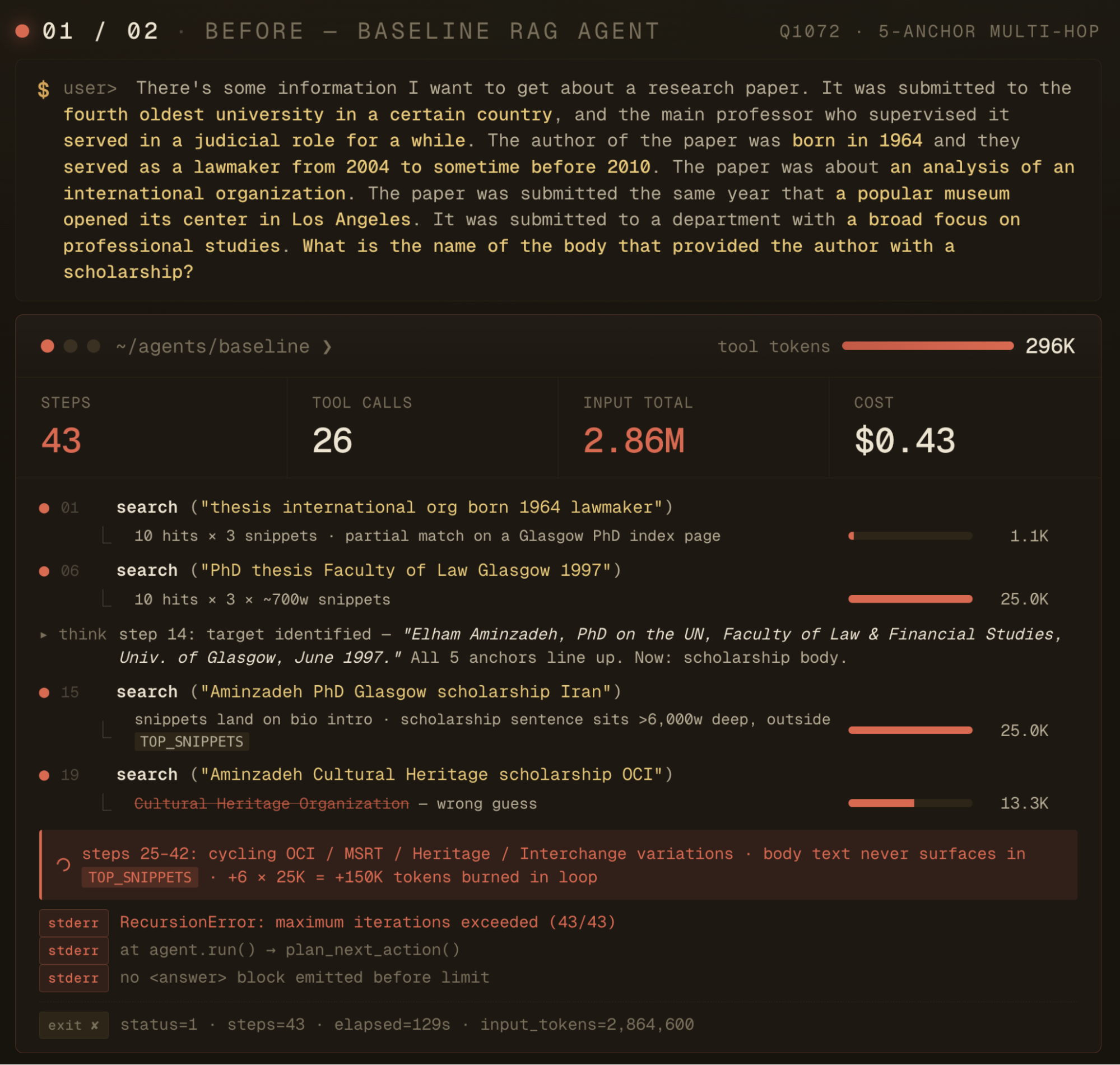

Agents stall before they reach the answer
Frontier models are extremely capable when armed with the ability to access sources of information — they can crawl web pages, parse spreadsheets, navigate logs, run queries. The challenge is doing this without running out of tokens before arriving at the answer.
This challenge is familiar to engineering leaders who are building agents with access to data. The agent gets a task, decides it needs information, searches, retrieves, evaluates, decides it needs more, searches again, reads, stitches together a partial picture, loops. By the time the model is ready to answer, most of the token and latency budget is gone. Sometimes the answer is in the corpus and the context window fills before the agent gets to it. Sometimes the agent picks the wrong thread and never recovers.

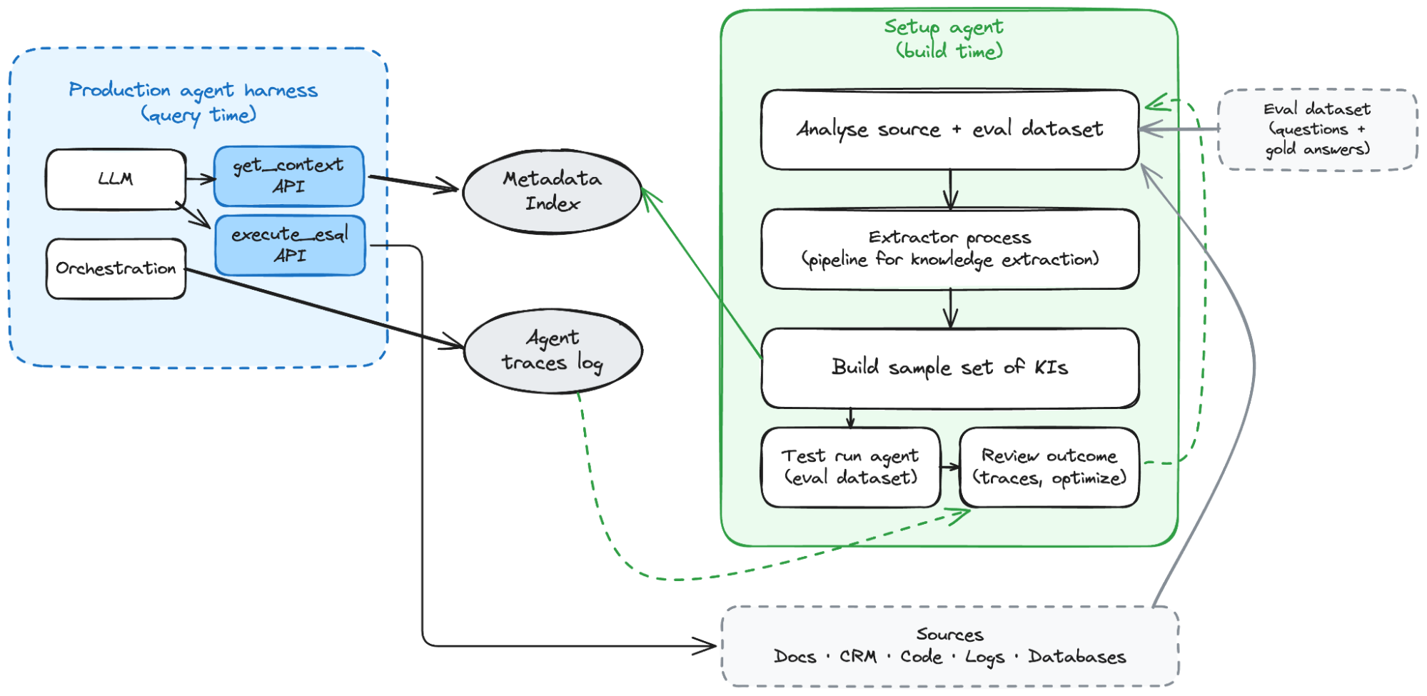

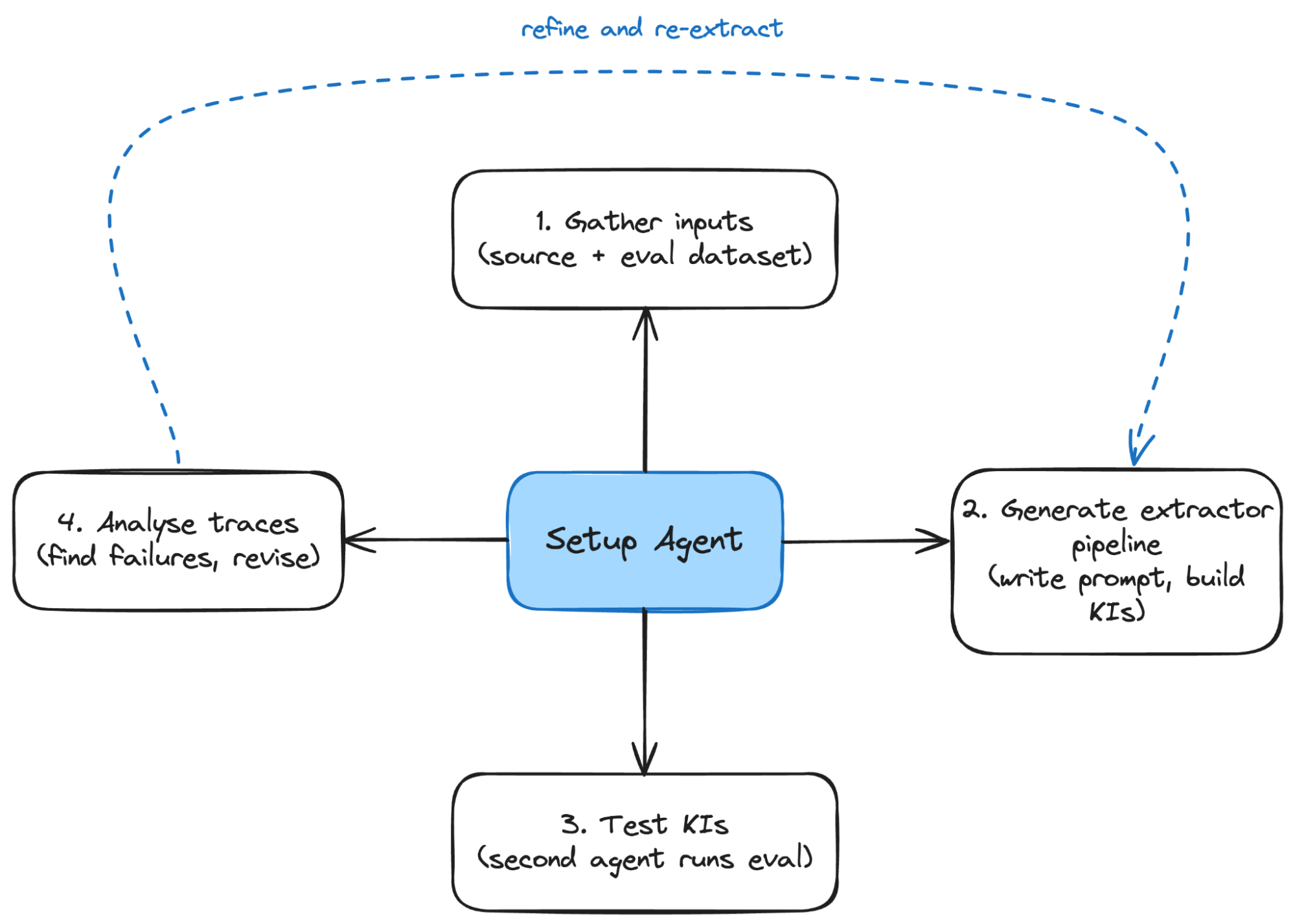

In practice this is harder than it sounds, and the difficulty is why this work needs a system with optimized search, retrieval, and data engineering to work effectively.
The part that makes this work is measuring how the metadata holds up. We watch how agents use it to answer real questions, where they fail, where they fall back to scanning the raw source, where they give up. Those failures are the signal. They tell the setup agent what it missed, the metadata gets regenerated, and the next batch of failures looks different. Without that loop, the extraction agent overfits to whatever small set of questions it was first tuned against, and the strategy doesn't scale past a demo.
The shape of the loop, end to end:
The user contributes once - a set of example questions and a pointer at the source. Everything inside the loop runs on its own, and keeps running as new traces come in.

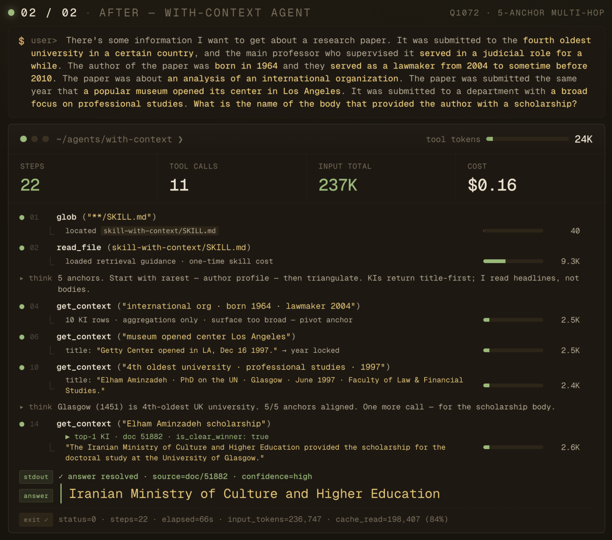

Querying Knowledge Indicators
We settled on a natural-language interface for querying the metadata. The agent sends a question; an LLM behind the interface rewrites it into the underlying query against the index. The agent doesn't need to know the schema, the retrieval strategy, or which source the answer is coming from.
POST /api/_get_context
  "query":        "Wilkinson 2014 creatine review rheumatoid arthritis article title",
  "size":         10,
  "execute":      true

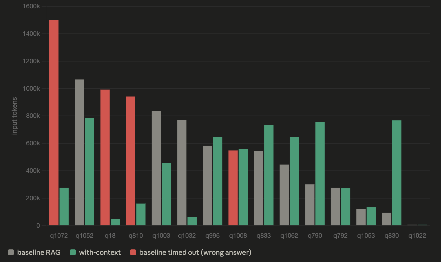

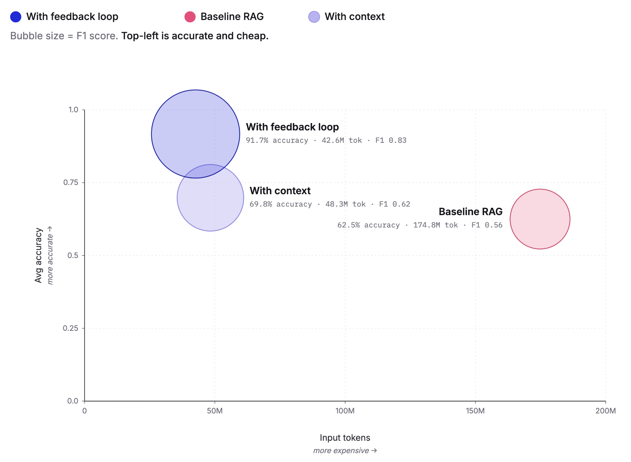

The three metrics we tracked
We want to know whether pre-computing context represented in knowledge indicators helps an agent answer faster and more accurately than the standard RAG pattern when both are working against the same corpus with the same budget.
Three things we care about:
  • Accuracy. How often does the agent commit to the correct answer? Answer match against the gold answer (judged by an LLM), plus F1 scores.
  • Input tokens consumed. Every step the agent takes costs tokens. Fewer tokens to the same answer is the whole point of the strategy. If with-context answers more questions but burns the same budget doing it, that's not a win for any real deployment.
  • Whether the agent converges within the step budget. A wrong-but-committed answer and a "ran out of steps and gave up" answer are both failures, but they fail for different reasons and the fix is different. We track timeouts separately.
We're not chasing leaderboard accuracy. We're testing whether the strategy holds up where the budget is tight, which is where every real agent lives.

Baseline (search-and-fetch RAG). The baseline skill exposes two helpers:
  • Search runs an ES|QL semantic and lexical MATCH(text, …) query against the corpus and returns up to ten hits, each with docid, url, _score, and three body snippets of up to 700 words. The agent reads relevant passages inline, in a single call, without the full document body.
  • get_by_doc_id is the escape hatch for fetching a full body when the snippets don't cover the answer.
A caveat on the baseline: this is the standard search-and-fetch pattern most teams use today, but it's not the most optimized RAG setup possible. Someone tuning RAG hard against this benchmark — chunking strategies, reranking, query expansion — would close some of the gap. The comparison is against the setup most customers actually run, not the theoretical best.
In-context setup. The in-context skill exposes two helpers:
  • get_context POSTs a natural language question to query relevant KIs.
  • execute_esql is available as a raw fallback against the corpus.
The skill's SKILL.md teaches the agent to chain get_context calls for entity-anchored multi-hop retrieval and only drop to body searches after two or more KI calls have come up short.

We took a 96 question sample (from the 830 question dataset) and transformed 25k (out of the 100k-document web corpus) documents into KIs (a 25% sample) which included the golden docs in each question. This produced around 240k KIs, built on Gemini Flash over roughly 7 hours.
Stage 1: Setup Agent Optimization
At setup time, we took a small slice of 15 questions and worked with the agent to improve the KI extraction process — iterating on the prompt to reduce the number of steps and tokens the agent harness consumed to reach an answer.
Against that same set of 15 questions and after 4 agent loop iterations refining the KI extractor prompt, the in-context setup posted:
metric
baseline RAG
with-context
change
exact match
4 / 15 (26.7%)
9 / 15 (60.0%)
+33 pp
F1
0.39
0.62
+0.24
input tokens
9.0M
6.3M

The headline isn't really the 30% token saving. Exact-match accuracy more than doubled, while wall time stayed flat and tokens went down. Five new questions came out right that the baseline got wrong, and zero baseline wins were lost in the swap.
A note on what these numbers mean. The accuracy figures here are not directly comparable to the BrowseComp-Plus leaderboard. Leaderboard runs optimize for accuracy with generous step and token budgets. This experiment deliberately constrains both to simulate the real-world case we care about — agents working against limited budgets where retrieval efficiency, not raw reasoning headroom, decides whether the answer lands.
The wins clustered around questions where a KI directly answered the query. The baseline on the same questions burns through call after call of keyword search, often hitting its recursion limit before it converges. On four of the new wins, the baseline didn't fail because it was wrong, it failed because it ran out of steps. The KI route gets to the answer in a fraction of the budget, which is what the 80–95% token savings on those specific questions reflect.
However, it wasn't uniform. On a couple of questions the in-context setup actually used more tokens than the baseline (one was +151%, another +723%), because no KI covered the question well and the agent fell through to body searches after exhausting the KI route. That's the failure mode the feedback loop is built to close — every one of these traces is a signal that the extractor missed something the agent needed, and the agent would continually improve the extractor prompt to capture these facts for the domain more effectively.

We then re-ran the 96-question set as a single live evaluation:
metric
baseline RAG
with-context
with-context + disambig
change vs no-disambig
judge correct
60 / 96 (62.5%)
67 / 96 (69.8%)
88 / 96 (91.7%)
+21.9 pp
F1
0.561
0.624
0.827
+0.203
input tokens
174.8M
48.3M
42.6M
−12%
timeouts (43-step limit)
28 / 96
37 / 96
27 / 96
−10
Force-commits landed correct on 22 of 28 fires this run, which is why timeouts dropped and accuracy jumped.

21 of the 29 failures flipped. Wrong-twin: 16 of 19. Numeric: 1 of 3 — the two misses didn't surface their disambig KI on this run, which looks stochastic. No-candidate: 4 of 7, because a disambig KI with an answer-bearing title surfaces during retrieval before the force-commit safety net fires.
Accuracy improved and the agent got faster doing it. Input tokens dropped 12%, timeouts dropped from 37 to 27, and the typical winning trace lands in around 25 steps.

This tuning isn't a setup step you do once either. It runs as an agent in a loop, always improving. The extraction agent writes the prompt, the eval shows where it failed, the agent rewrites the prompt against those failures. Stage 1 did exactly this over 4 iterations. And the loop keeps running after launch, because sources change and the questions drift. Every new domain needs an extractor that fits its source, plus a process that keeps it fitting.

What moves the ceiling is the failures themselves. When the agent commits to a wrong answer, the trace tells you something precise — exactly which two entities the index couldn't separate, and which one the agent picked instead. That's specific enough to act on. The system takes those failures and builds new KIs aimed straight at the gap, each one naming both entities and what separates them. Stage 1's tuning improves how facts get pulled; the feedback loop adds targeted facts the extractor would never have written on its own. Stage 3 did this, and accuracy moved from 70% to 92%.
