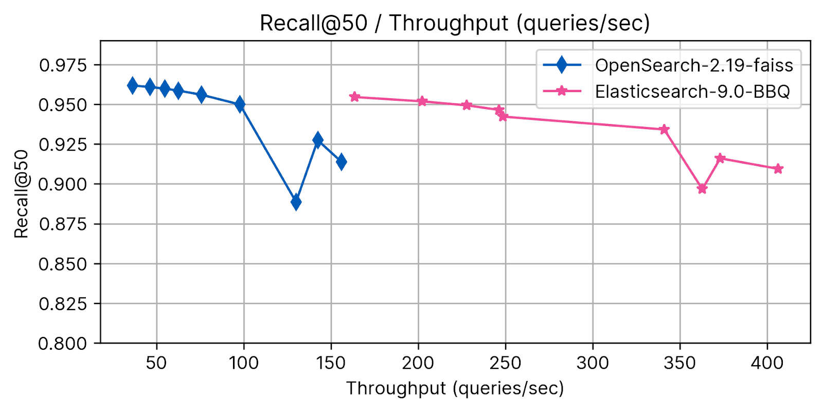

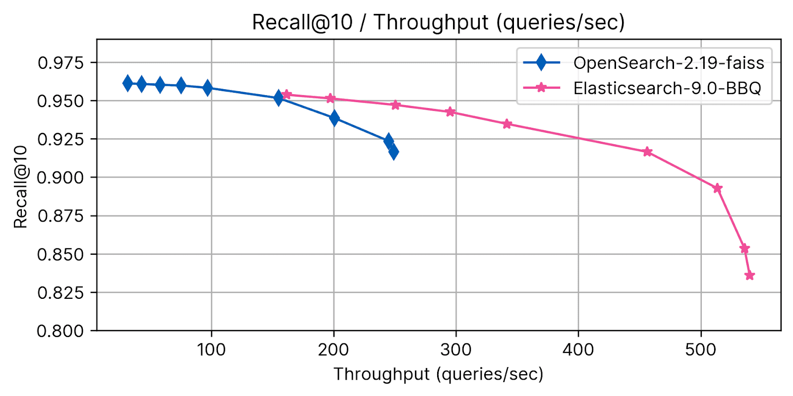

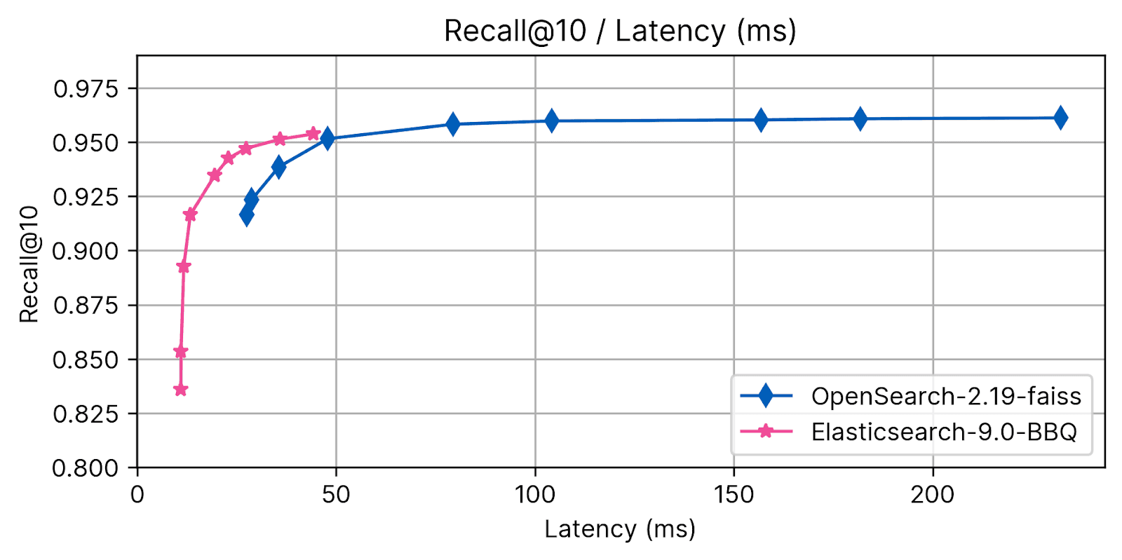

Results

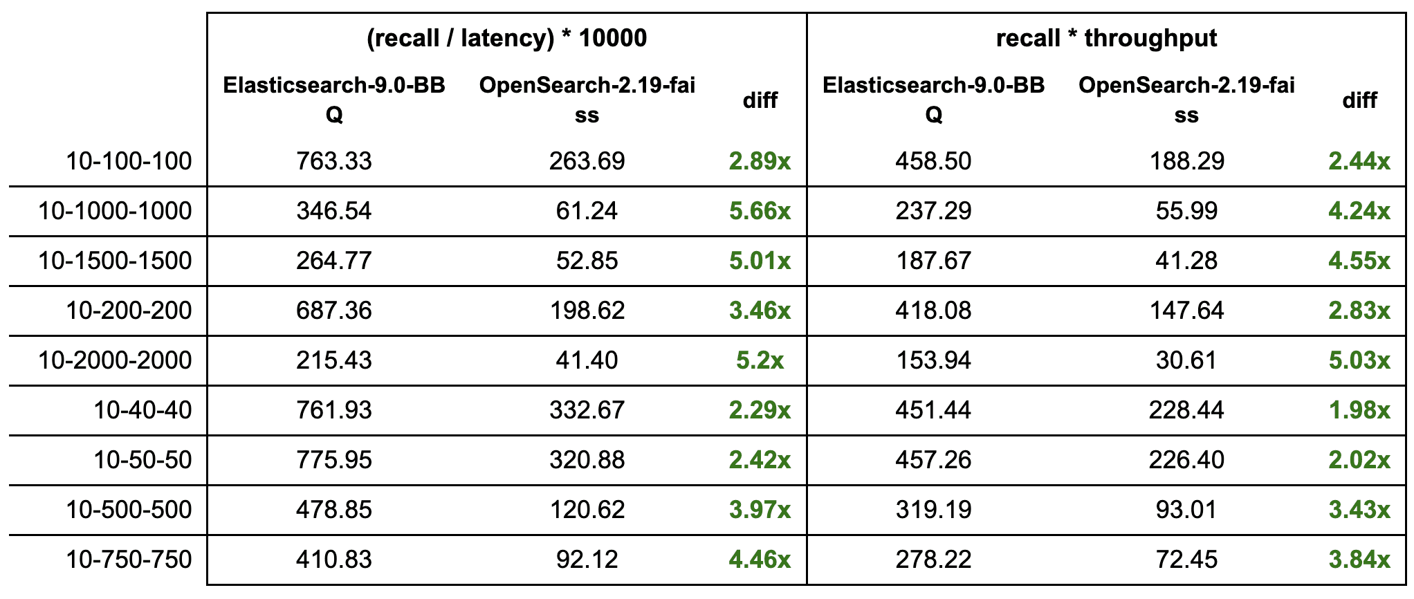

There are multiple ways to interpret the results. For both latency and throughput, we plotted a simplified and a detailed chart at each level of recall. It’s easy to see differences if we consider “higher is better” for each metric. However, latency is a negative one (lower is actually better), while throughput is a positive one. For the simplified charts, we used (recall / latency) * 10000 (called simply “speed”) and recall * throughput, so both metrics mean more speed and more throughput are better. Let’s get to it.

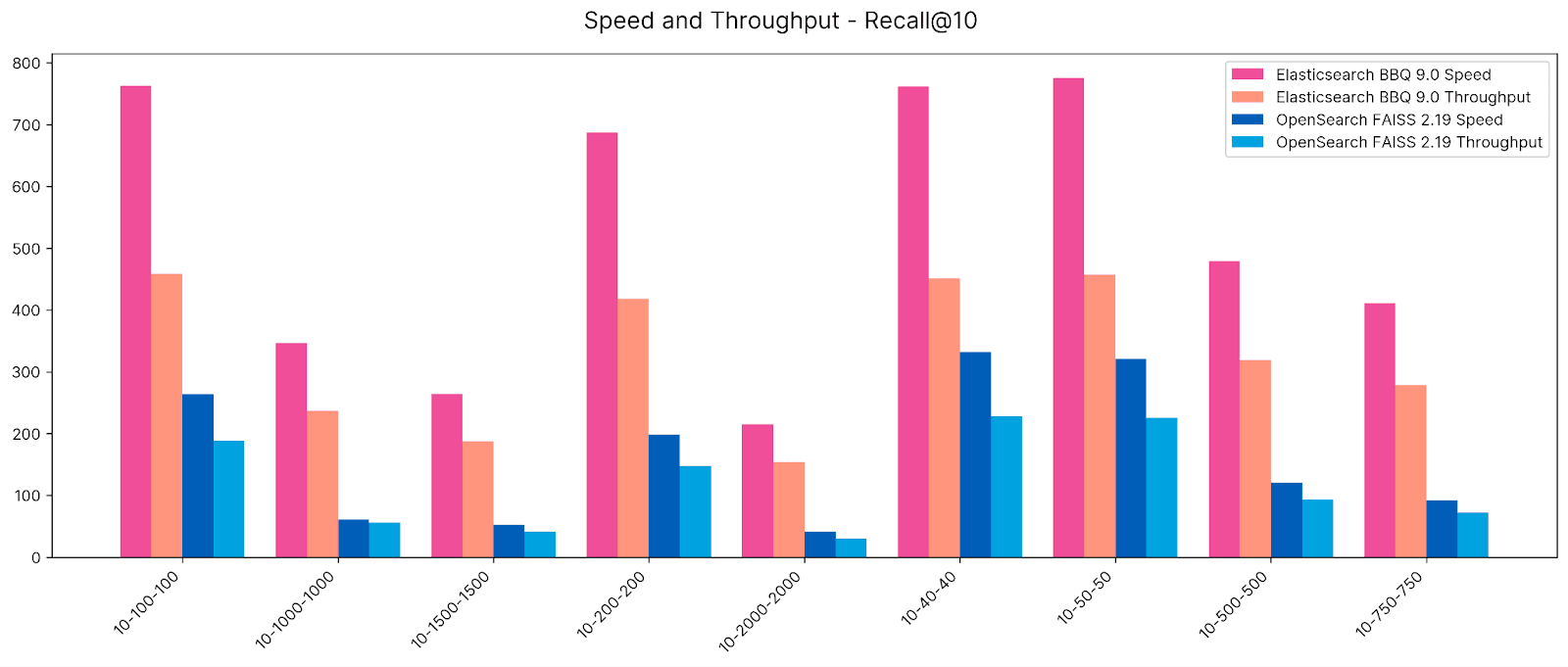

Recall @ 10 - simplified
At that level of recall Elasticsearch BBQ is up to 5x faster (3.9x faster on average) and has 3.2x more throughput on average than OpenSearch FAISS.
Recall @ 10 - Detailed

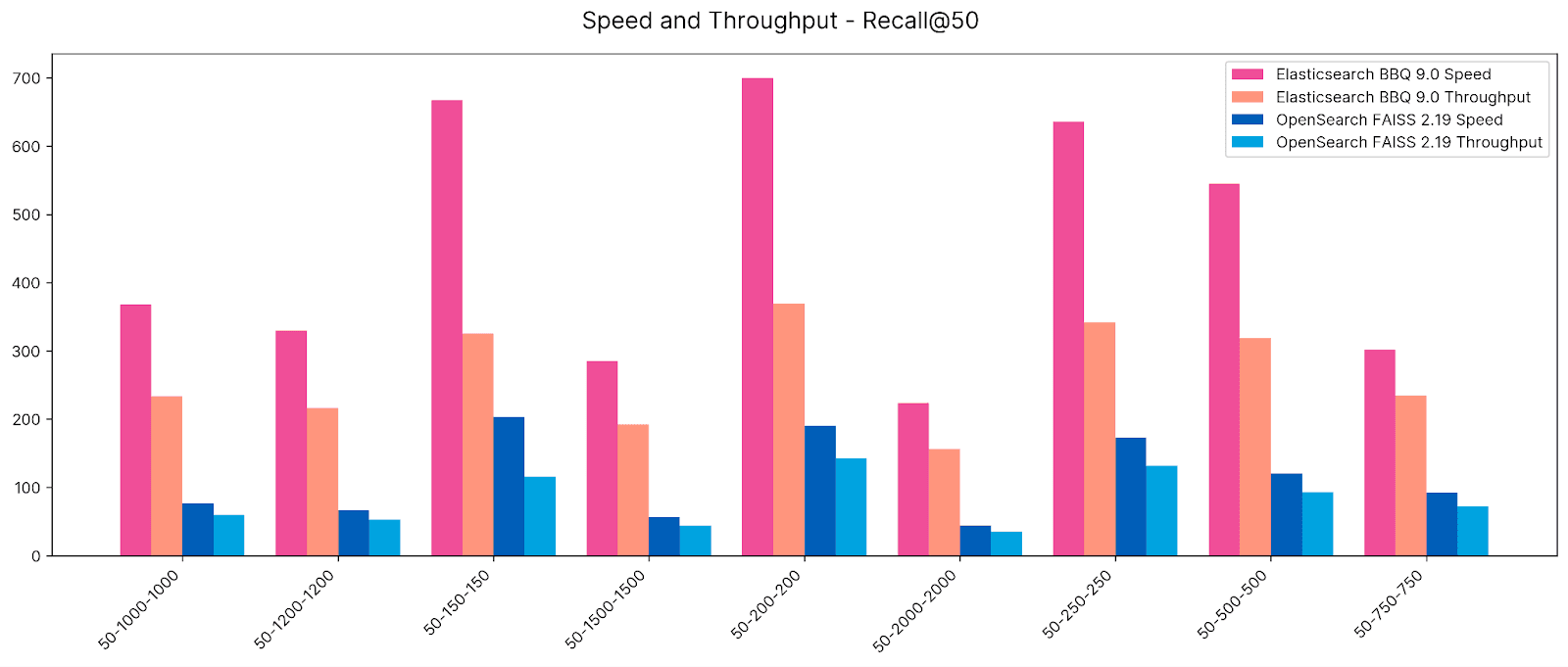

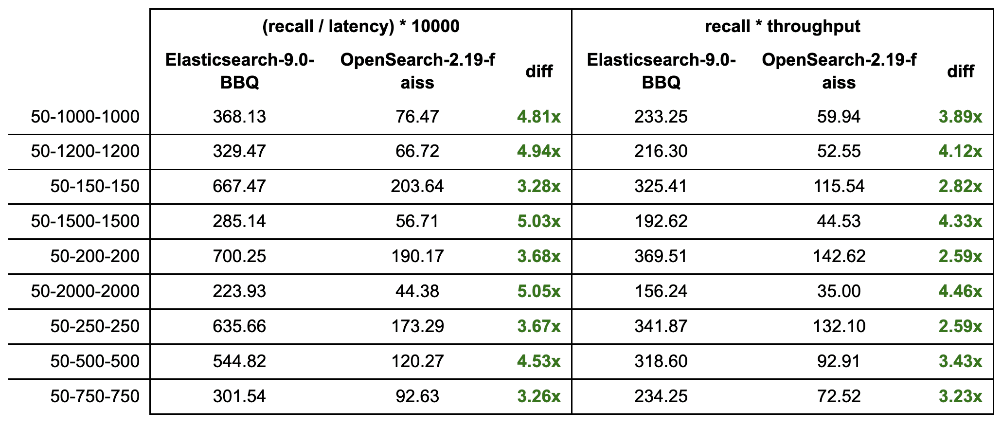

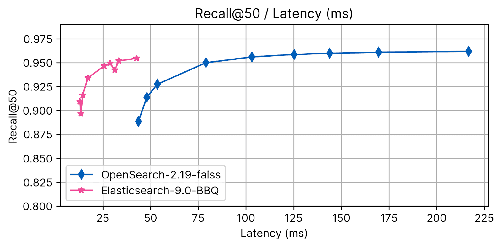

Recall @ 50 - simplified
At that level of recall Elasticsearch BBQ is up to 5x faster (4.2x faster on average) and has 3.9x more throughput on average than OpenSearch FAISS.
Detailed Results - Recall @ 50
Task
Latency Mean
Throughput Mean
Avg Recall

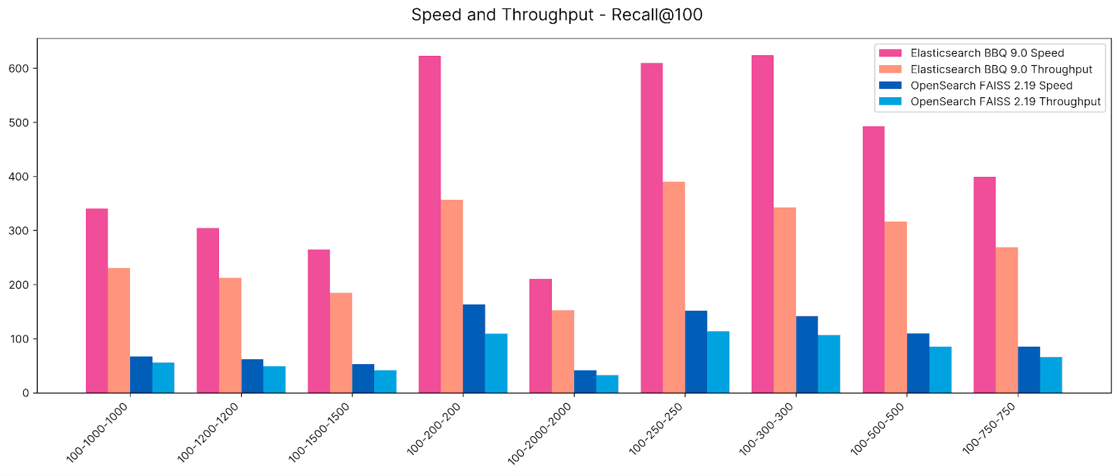

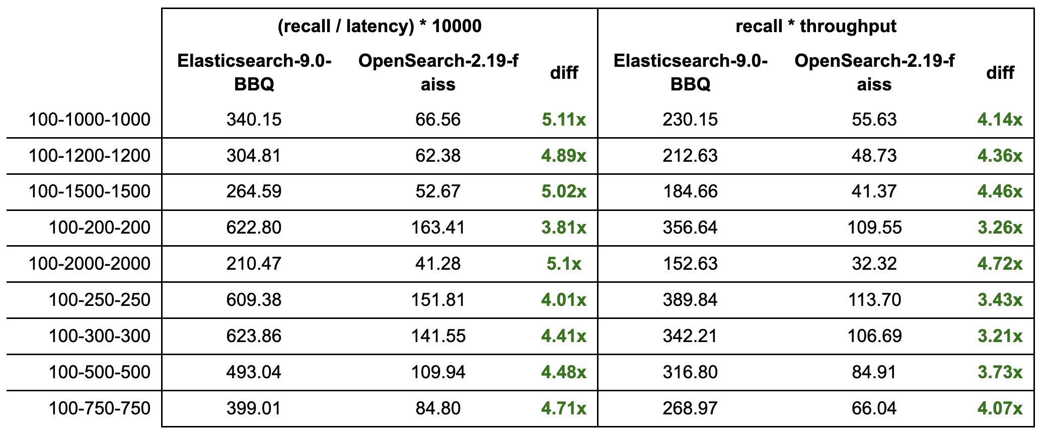

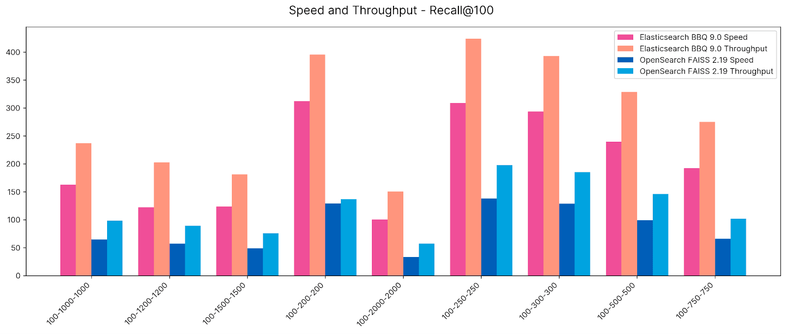

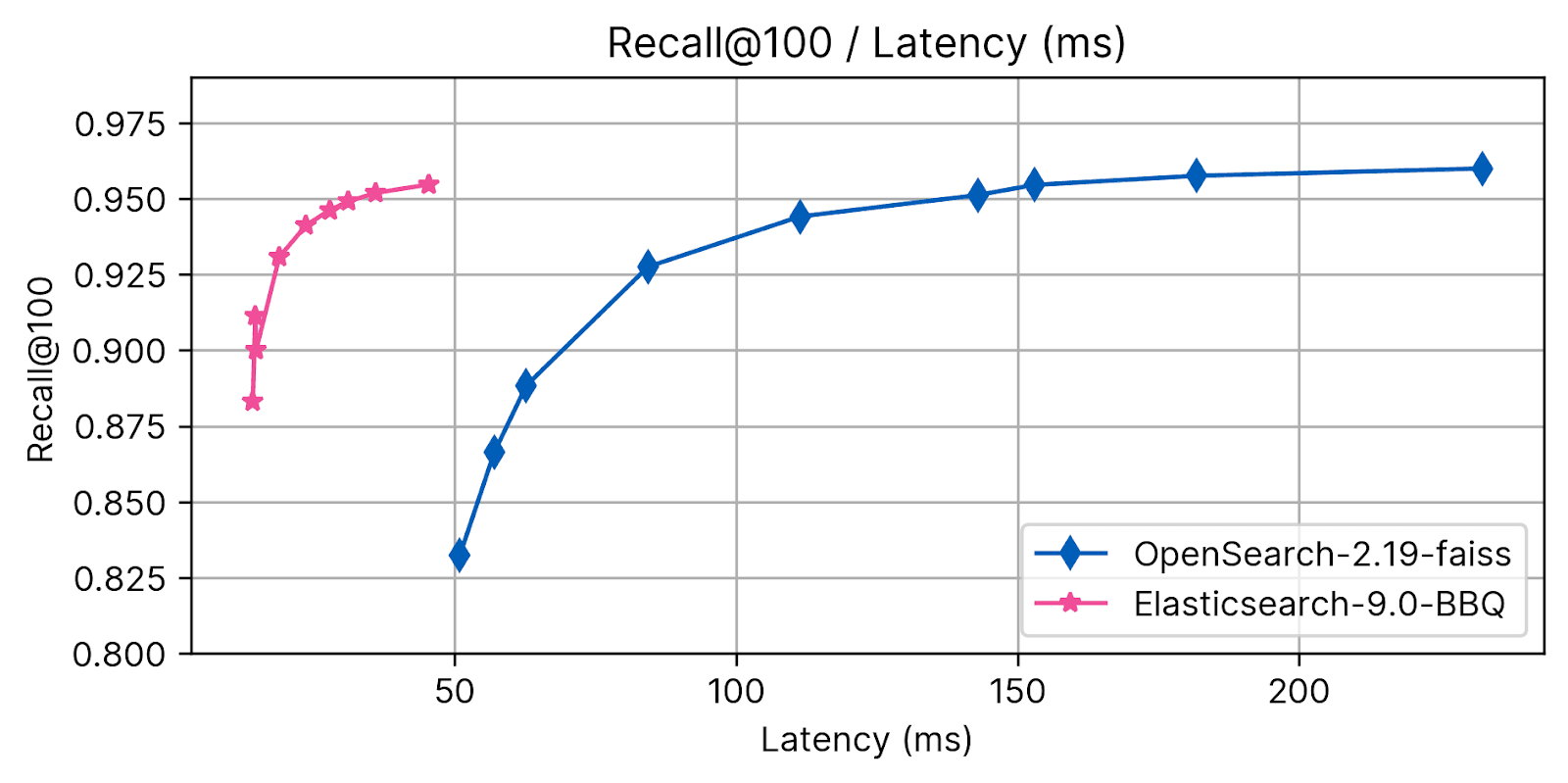

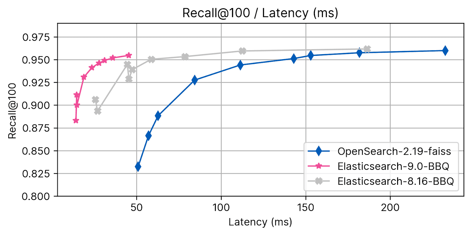

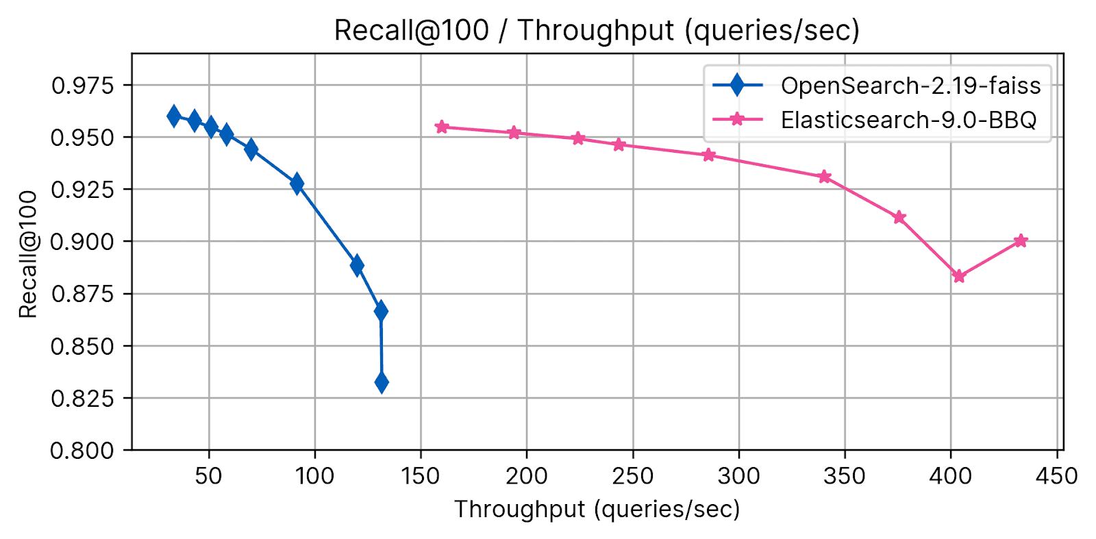

Recall @ 100
At that level of recall Elasticsearch BBQ is up to 5x faster (average 4.6x faster) and has 3.9x more throughput on average than OpenSearch FAISS.
Detailed Results - Recall @ 100

100-300-300
62.76
120.10
0.89
OpenSearch-2.19-faiss
100-500-500
84.36
91.54
0.93
100-750-750
111.33
69.95
0.94
Improvements on BBQ
BBQ has come a long way since its first release. On Elasticsearch 8.16, for the sake of comparison, we included a benchmark run from 8.16 alongside the current one, and we can see how recall and latency have improved since then.
In Elasticsearch 8.18 and 9.0, we rewrote the core algorithm for quantizing the vectors. So, while BBQ in 8.16 was good, the newest versions are even better. You can read about it here and here. In short, every vector is individually quantized through optimized scalar quantiles. As a result, users benefit from higher accuracy in vector search without compromising performance, making Elasticsearch’s vector retrieval even more powerful.
Conclusion
In this performance comparison between Elasticsearch BBQ and OpenSearch FAISS, Elasticsearch significantly outperforms OpenSearch for vector search, achieving up to 5x faster query speeds and 3.9x higher throughput on average across various levels of recall.
Key findings include:
  • Recall@10: Elasticsearch BBQ is up to 5x faster (3.9x faster on average) and has 3.2x more throughput on average compared to OpenSearch FAISS.
  • Recall@50: Elasticsearch BBQ is up to 5x faster (4.2x faster on average) and has 3.9x more throughput on average compared to OpenSearch FAISS.
  • Recall@100: Elasticsearch BBQ is up to 5x faster (4.6x faster on average) and has 3.9x more throughput on average compared to OpenSearch FAISS.
These results highlight the efficiency and performance advantages of Elasticsearch BBQ, particularly in high-dimensional vector search scenarios. The Better Binary Quantization (BBQ) technique, introduced in Elasticsearch 8.16, provides substantial memory reduction (~95%) while maintaining high ranking quality, making it a superior choice for large-scale vector search applications.
