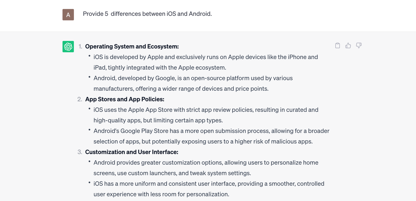

What is ChatGPT?
First things first, ChatGPT is awesome! It can help you work more efficiently — from summarizing a 10,000-word document to providing a list of differentiations between competing products, as well as many other tasks.

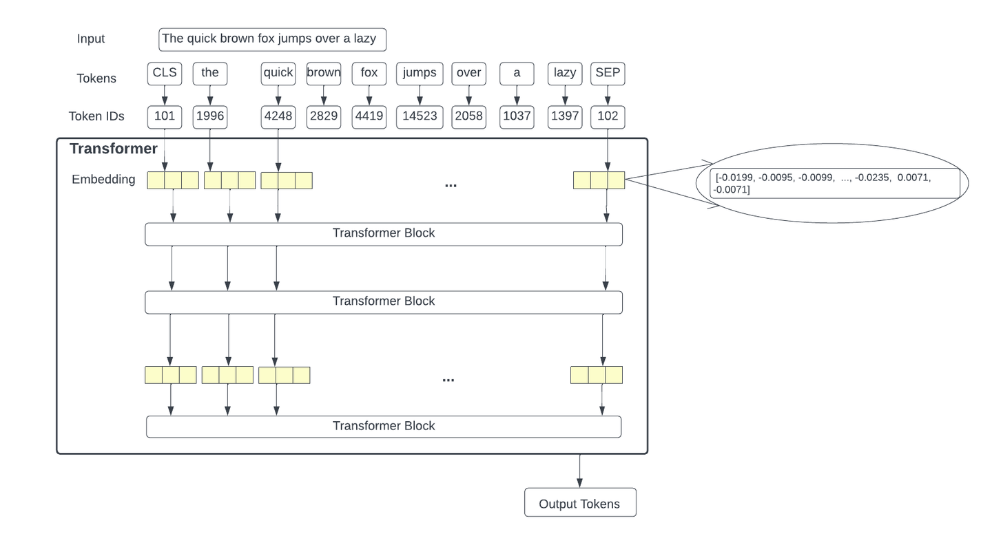

Tokens
Tokens are the basic units of text or code that an LLM uses to process and generate language. Tokens can be characters, words, subwords, or other segments of text or code, depending on the chosen tokenization method or scheme. They are assigned numerical values or identifiers and are arranged in sequences or vectors, then are fed into or outputted from the model. Tokenization is the process of splitting the input and output texts into smaller units that can be processed by the LLM models.
For example, the sentence “A quick brown fox jumps over a lazy dog” can be tokenized into the following tokens: “a,” “quick,” “brown,” “fox,” “jumps,” “over,” “a,” “lazy,” and “dog.”

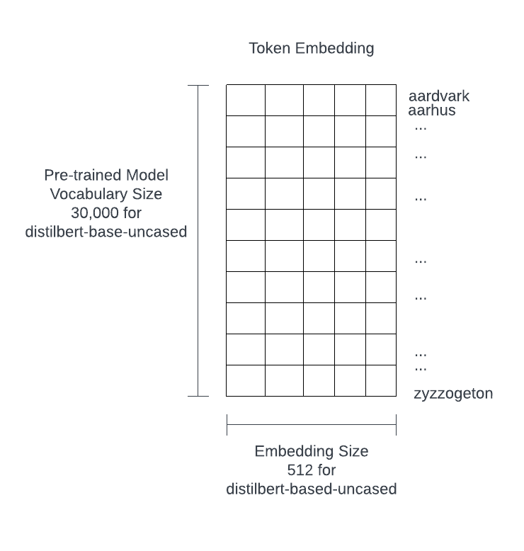

Embedding
Embeddings are vectors or arrays of numbers that represent the meaning and the context of the tokens that the model processes and generates. They are derived from the parameters of the model and are used to encode and decode the input and output texts. Embeddings help the model to understand the semantic and syntactic relationships between the tokens and to generate more relevant and coherent texts. They are essential components of the transformer architecture that GPT-based models use. They can also vary in size and dimension, depending on the model and the task.
At a minimum, pre-trained LLMs contain embedding for tens of thousands of words, tokens, and terms. For example, ChatGPT-3 has a vocabulary of 14,735,746 words and a dimension of 1,536. The following is from a small model called distilbert-based-uncased. Despite the fact that this is a small model, it is still 100s mb in size.

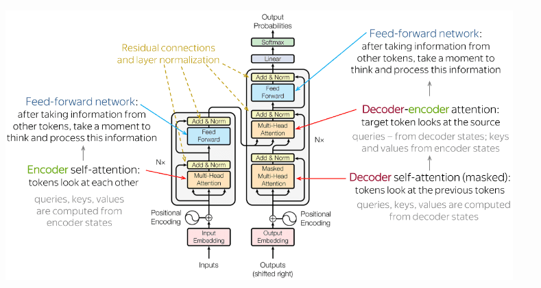

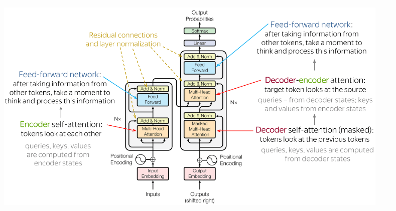

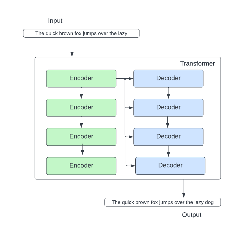

Transformer
A transformer model is a neural network that learns context or meaning by tracking relationships in sequential data like the words in this sentence. In its simplest form, a transformer will take an input and predict an output. Within the transformer, there is an encoder stack and a decoder stack.

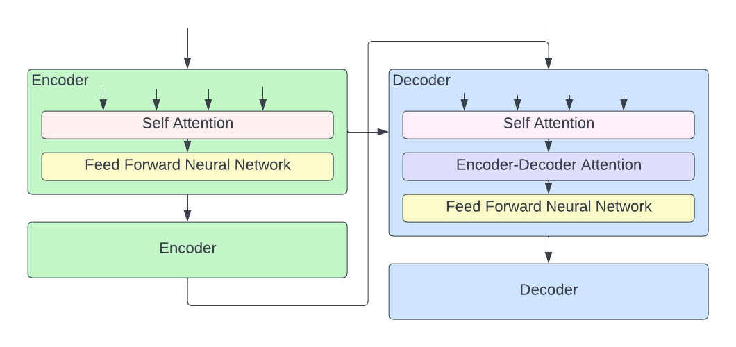

Let’s dig into the encoder block and the decoder block. In the encoder block, there are two important components: the self-attention neural network and the feed-forward neural network.
The self-attention layer is crucial as it builds in the “understanding” of the current token from the previous words that are relevant to the current one. For example, “it” refers to the chicken in “the chicken crossed the road because it wants to know what the jokes are all about.”
The other important layer in an encoder is the feed-forward neural network (FFNN). FFNN predicts what word comes after the current token.
Moving on to the decoder side, the encoder-decoder attention layer stands out. The encoder-decoder layer focuses on relevant parts of the input sentence, taking into account the layer below it and the output of the encoder stack.
Putting it all together:
We will take an input, tokenize the input, and obtain token IDs of the tokens before converting them into embeddings for each token. From there, we will pass the embeddings into a transformer block. At the end of the process, the transformer will predict a series of output tokens. The following image provides a detailed look at the transformer model.
The decoder stack outputs a vector of floats. The linear layer projects the vector of floats produced by the stack of decoders into a larger vector called a logits vector. If the model has a 10,000-word vocabulary, then the linear layer maps the decoder output onto a 10,000 cell vector. The softmax layer turns those scores from the logit vector into probabilities — all positive — and adding up to 100%. The cell with the highest probability is chosen, and the word associated with it is produced as the output for this step.

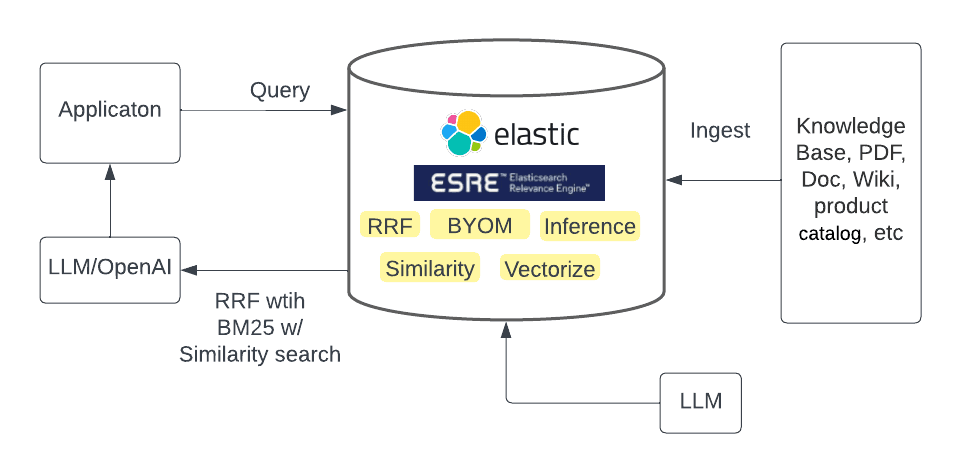

Method 1: Provide context to your data and integrate with ChatGPT or other LLMs

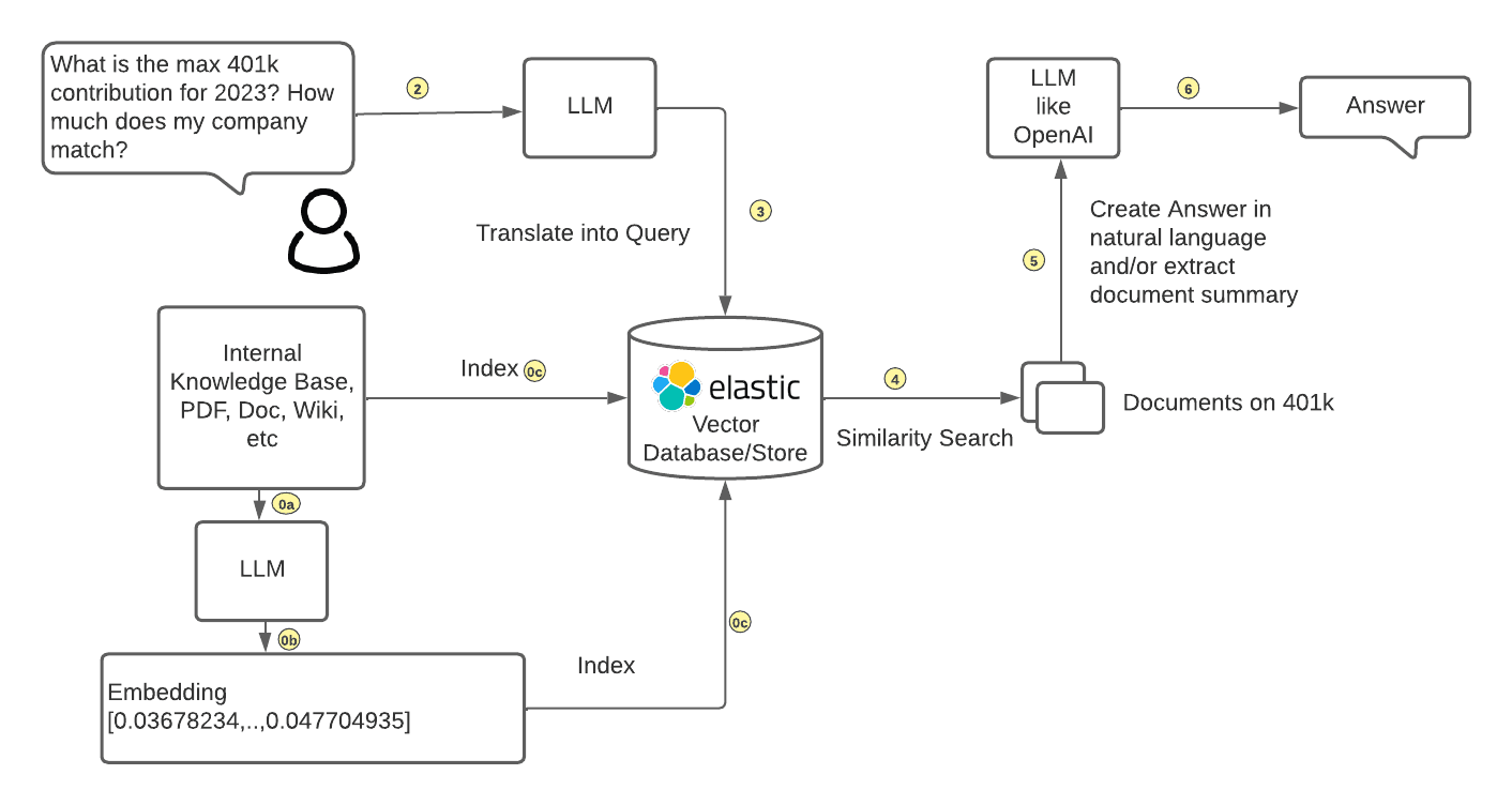

The following depicts how to separate LLMs from your data while integrating with generative AI.
A customer can bring their own embedding generated by a LLM and ingest their data along with the embedding into Elasticsearch. Then, the customer can take the similarity search results from their own data stored in Elasticsearch (context to the user’s question) to ChatGPT or another LLM to construct natural-language based answers to their users.
Also, the newly released reciprocal rank fusion (RRF) allows users to perform hybrid search, which can combine and rank search results. For instance, the BM25 method can filter for the relevant documents along with vector search to provide the best documents. With RRF, customers can achieve best search results natively through Elasticsearch instead of through their own applications, which greatly reduces complexity and maintenance of their applications.

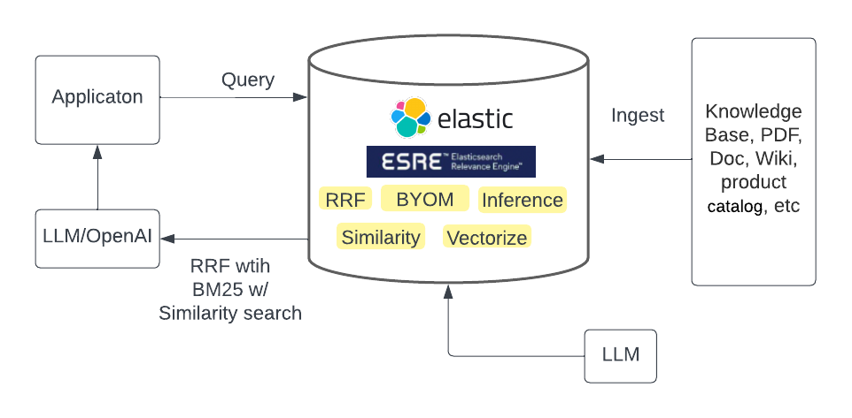

Method 2: Bring your own model
The recently announced Elasticsearch Relevance Engine
TM (ESRETM) provides the capability to bring your own LLMs. This capability has been available for a while through machine learning. The Elasticsearch machine learning team has been scaffolding infrastructure for integrating transformer-based models. Starting with the 8.8 release, you can ingest and query just like you would normally do in Elasticsearch through the search APIs. On top of that, you can use the hybrid search method with RRF, which provides even better relevance. As the models are managed and integrated into Elasticsearch, it reduces operation complexity while achieving the most relevant search results.
This approach would require the users to know what model would work well for their use case and a commercial relationship with Elastic.

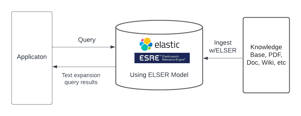

Method 3: Use the built-in sparse encoder model
Elastic Learned Sparse Encoder is the Elastic out-of-the-box language model that outperforms SPLADE (SParse Lexical AnD Expansion Model), which itself is a state-of-the-art model. Elastic Learned Sparse Encoder solves the vocabulary mismatch problem where a document may be relevant to a query but does not contain any terms that appear in the query. An example of the mismatch may be if we ask “how have American corporations have assisted with Covid-19 efforts”, then manufacturers of ventilators may not appear in the query results.
Elastic Learned Sparse Encoder is accessible just like other search endpoints via the text_expansion query. Elastic Learned Sparse Encoder enables our user to begin the state-of-the-art generative AI search with a click and yield immediate results. Elastic Learned Sparse Encoder is also an Elastic commercial feature.

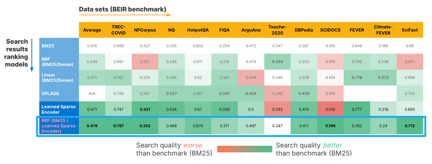

Here are some benchmark results using the BEIR benchmark. We used several standardized data sets (horizontal axis) and applied different retrieval metaphors (vertical axis). As you can see, a combination of BM25 and our Learned Sparse Encoder using RRF, returns the best relevance scores. These scores with RRF beat the SPLADE model and our Learned Sparse Encoder model when considered by itself. We published more details on our blog here.

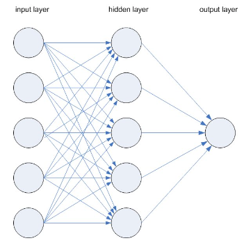

Neural Network (NN)
Each node is a neuron. Think of each individual node as its own linear regression model, composed of input data, weights, a bias (or threshold), and an output. The math representation may look like:
∑wixi + bias = w1x1 + w2x2 + w3x3 + bias
output = f(x) = 1 if ∑w1x1 + b>= 0; 0 if ∑w1x1 + b < 0
Once an input layer is determined, weights (w) are assigned. These weights help determine the importance of any given variable with larger ones contributing more significantly to the output compared to other inputs. All inputs are then multiplied by their respective weights and then summed. Afterward, the output is passed through an activation function, which determines the output. If that output exceeds a given threshold, it activates the node and passes data to the next layer in the network. This results in the output of one node becoming the input of the next node. This process of passing data from one layer to the next layer is a feed-forward network. This is just one type of NNs.
