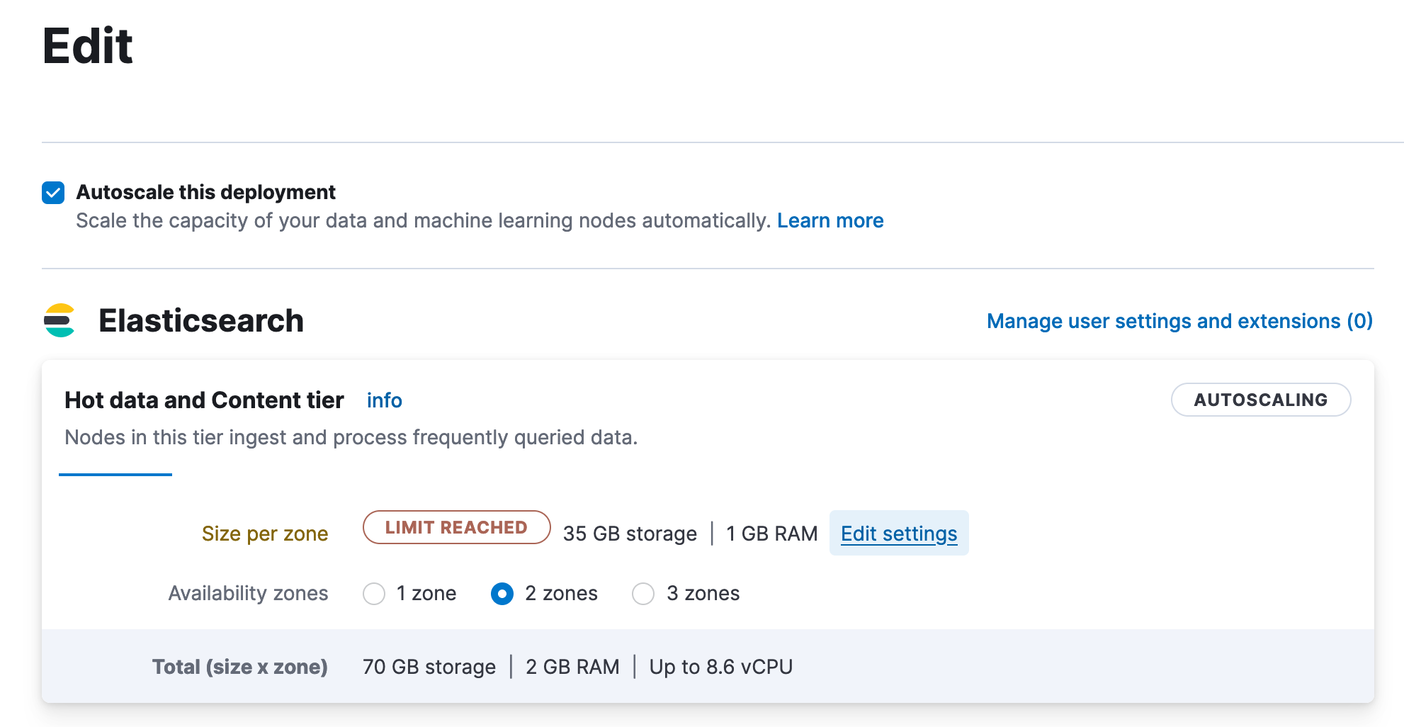

Option 1: Configure Autoscaling
- Log in to the Elastic Cloud console or ECE Cloud UI.
- On the home page, find your deployment and select Manage.
- Go to Actions > Edit deployment and check that autoscaling is enabled. Adjust the Enable Autoscaling for dropdown menu as needed and select Save.
- If autoscaling is successful, the cluster returns to a
healthystatus. If the cluster is still out of disk, check if autoscaling has reached its set limits and update your autoscaling settings.

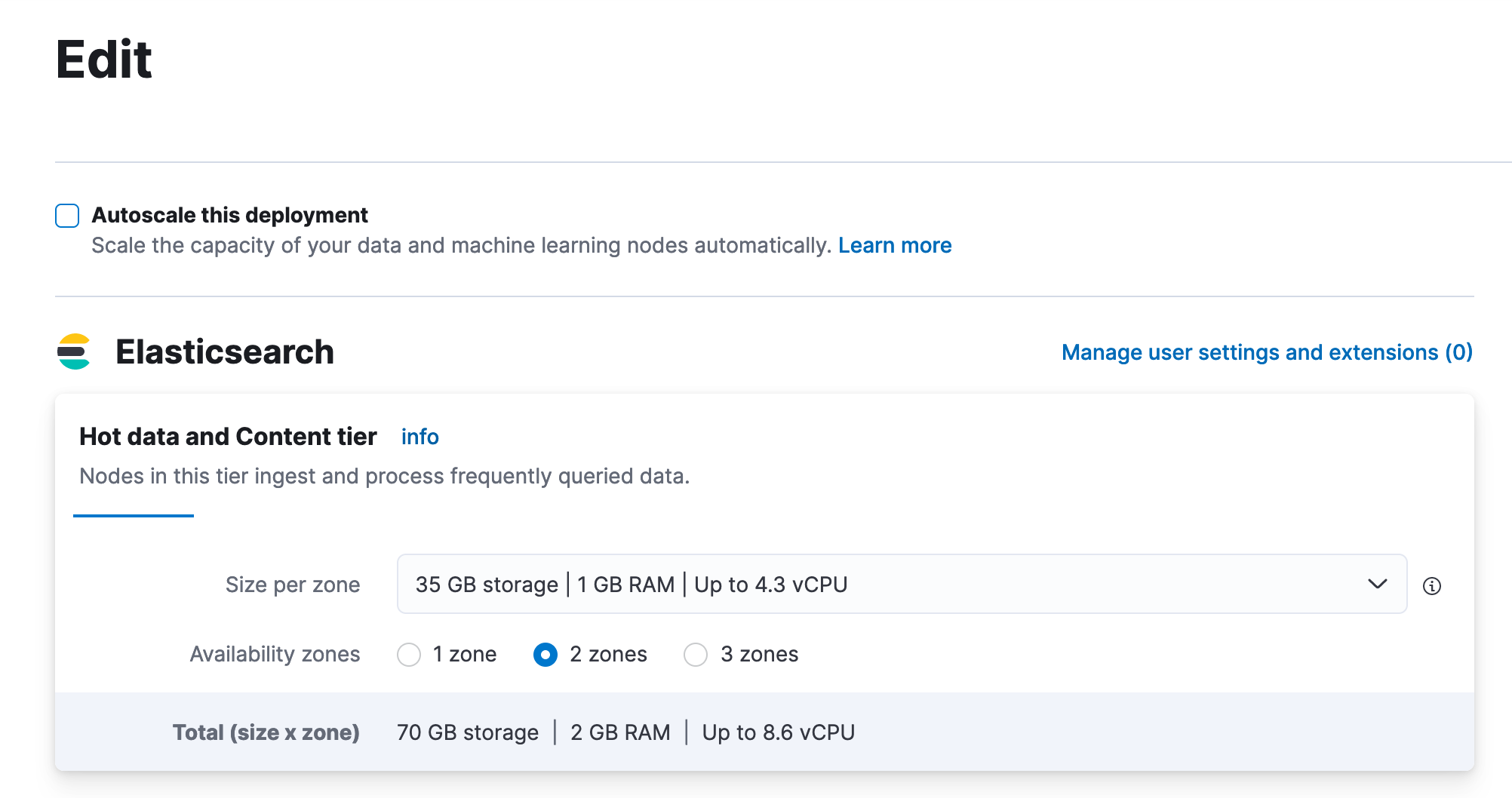

Option 2: Configure deployment size and tiers
You can increase the deployment capacity by editing the deployment and adjusting the size of the existing data tiers or adding new ones.
- In Kibana, open your deployment’s navigation menu (placed under the Elastic logo in the upper left corner) and go to Manage this deployment.
- From the right hand side, click to expand the Manage dropdown button and select Edit deployment from the list of options.
- On the Edit page, increase capacity for the data tier you identified earlier by either adding a new tier with + Add capacity or adjusting the size of an existing one. Choose the desired size and availability zones for that tier.
- Navigate to the bottom of the page and click the Save button.
