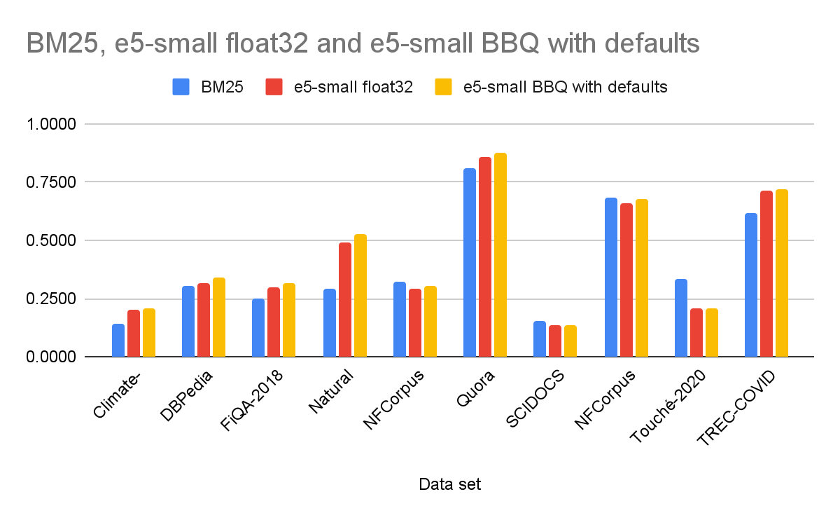

To measure this, we used NDCG@10 (Normalized Discounted Cumulative Gain at 10), a standard metric that evaluates the quality of the top 10 search results. A higher NDCG score means more relevant documents are ranked higher. You can learn more about this in our ranking evaluation API documentation.
We ran several benchmarks across 10 public datasets from the BEIR data sets, comparing traditional BM25 search, vector search with the e5-small model (float32 vectors), and vector search with the same model using BBQ. We chose e5-small because we know from previous benchmarks that BBQ is at its best with high vector dimensionality, so we wanted to benchmark it where it struggles, with rather low-dimensional vectors like e5-small produces. We measured using NDCG@10, which is a ranking quality metric that takes into account the order of the results. Below is a representative example of the results we saw.

BM25, E5-SMALL float 32 and e5 samll bbq with defaults
The results are stunning. BBQ achieved better ranking quality than pure float32 search in 9 out of the 10 datasets. Even in the single exception, the difference was negligible. Furthermore, BBQ was the top-performing method overall in 6 of the 10 sets. As a sidenote, often the best ranking is obtained by using a hybrid of BM25 and vector queries, plus other factors like distance, time, and popularity, and Elasticsearch excels in these types of queries.
One may ask how BBQ provides better ranking than float32, since BBQ is a lossy compression. Sure with BBQ we oversample and rerank by the float32 vector, but that shouldn’t matter, since conceptually, with float32, we rank all the documents using the float32 vectors. The answer is that with HNSW we only evaluate a smaller number of vectors per shard, which is defined in the parameter we call num_candidates. The default num_candidates when no quantization is performed is 1.5*k, with k being the number of results returned to the user. You can read more about the benchmarks we performed to get to that default here. When we are quantizing to BBQ, the comparison of vectors is faster and we can afford a larger num_candidates while still reducing latency, so after some benchmarking work we set the default num_candidates for BBQ to max(1.5*k, oversample*k).
For the benchmark above, that relies on our defaults, and in which k=10, we calculate num_candidates as follows:
  • Float32: 1.5*k = 1.5*10 = 15
  • BBQ: max(1.5*k, oversample*k) = max(1.5*10, 3*10) = 30
Because of the difference in num_candidates, we scan a greater part of the HNSW graphs when using BBQ and get better candidates in the top 30 that are reranked by float32, which explains how BBQ provides better ranking quality. You can set num_candidates for your needs (e.g., see here), or, like most users, you can trust our benchmarks, and rely on the defaults.
