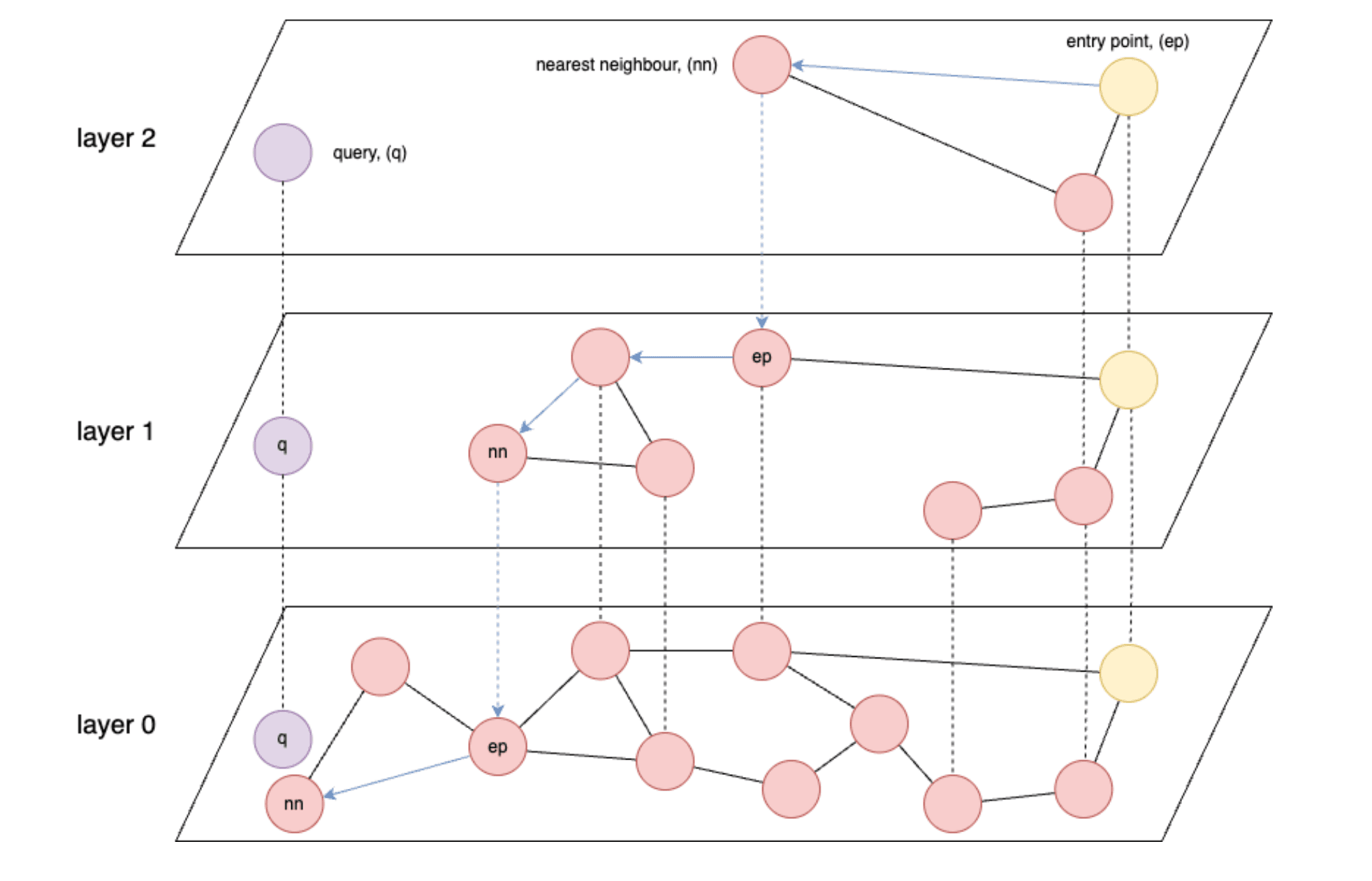

  • Graph-based indices like HNSW (Hierarchical Navigable Small World) are the fastest for vector retrieval.
    • HNSW: An approximate nearest neighbor search algorithm that builds a multi-layer graph structure to enable efficient high-dimensional similarity searches.
  • HNSW is fundamentally limited in speed by data read speed from memory, or in the worst case, from storage.

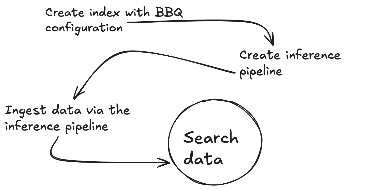

Better Binary Quantization (BBQ) implementation
To keep this blog simple, you will use built-in functions when they are available. In this case, you have the .multilingual-e5-small vector embedding model that will run directly inside Elasticsearch on a machine learning node. Note that you can replace the text_embedding model with the embedder of your choosing (OpenAI, Google AI Studio, Cohere and plenty more. If your preferred model is not yet integrated, you can also bring your own dense vector embeddings.)
First, you will need to create an inference endpoint to generate vectors for a given piece of text. You will run all of these commands from the Kibana Dev Tools Console. This command will download the .multilingual-e5-small. If it does not already exist, then it will set up your endpoint; this may take a minute to run. You can see the expected output in the file 01-create-an-inference-endpoint-output.json in the Outputs folder.

Now let's create a new mapping with 2 properties, a standard text field (my_field) and a dense vector field (my_vector) with 384 dimensions to match the output from the embedding model. You will also override the index_options.type to bbq_hnsw. You can see the expected output in the file 03-create-byte-qauntized-index-output.json in the Outputs folder.
PUT bbq-my-byte-quantized-index
  "mappings": {
    "properties": {
      "my_field": {
        "type": "text"
      "my_vector": {
        "type": "dense_vector",
        "dims": 384,
        "index_options": {
          "type": "bbq_hnsw"
To ensure Elasticsearch generates your vectors, you can make use of an Ingest Pipeline. This pipeline will require 3 things: the endpoint, (model_id), the input_field that you want to create vectors for and the output_field to store those vectors in. The first command below will create an inference ingest pipeline, which uses the inference service under the hood, and the second will test that the pipeline is working correctly. You can see the expected output in the file 04-create-and-simulate-ingest-pipeline-output.json in the Outputs folder.
PUT _ingest/pipeline/my_inference_pipeline
  "processors": [
      "inference": {
        "model_id": "my_e5_model",
        "input_output": [
            "input_field": "my_field",
            "output_field": "my_vector"
POST _ingest/pipeline/my_inference_pipeline/_simulate
  "docs": [
      "_source": {
        "my_field": "my awesome text field"
You are now ready to add some documents with the first 2 commands below and to test that your searches work with the 3rd command. You can check out the expected output in the file 05-bbq-index-output.json in the Outputs folder.
