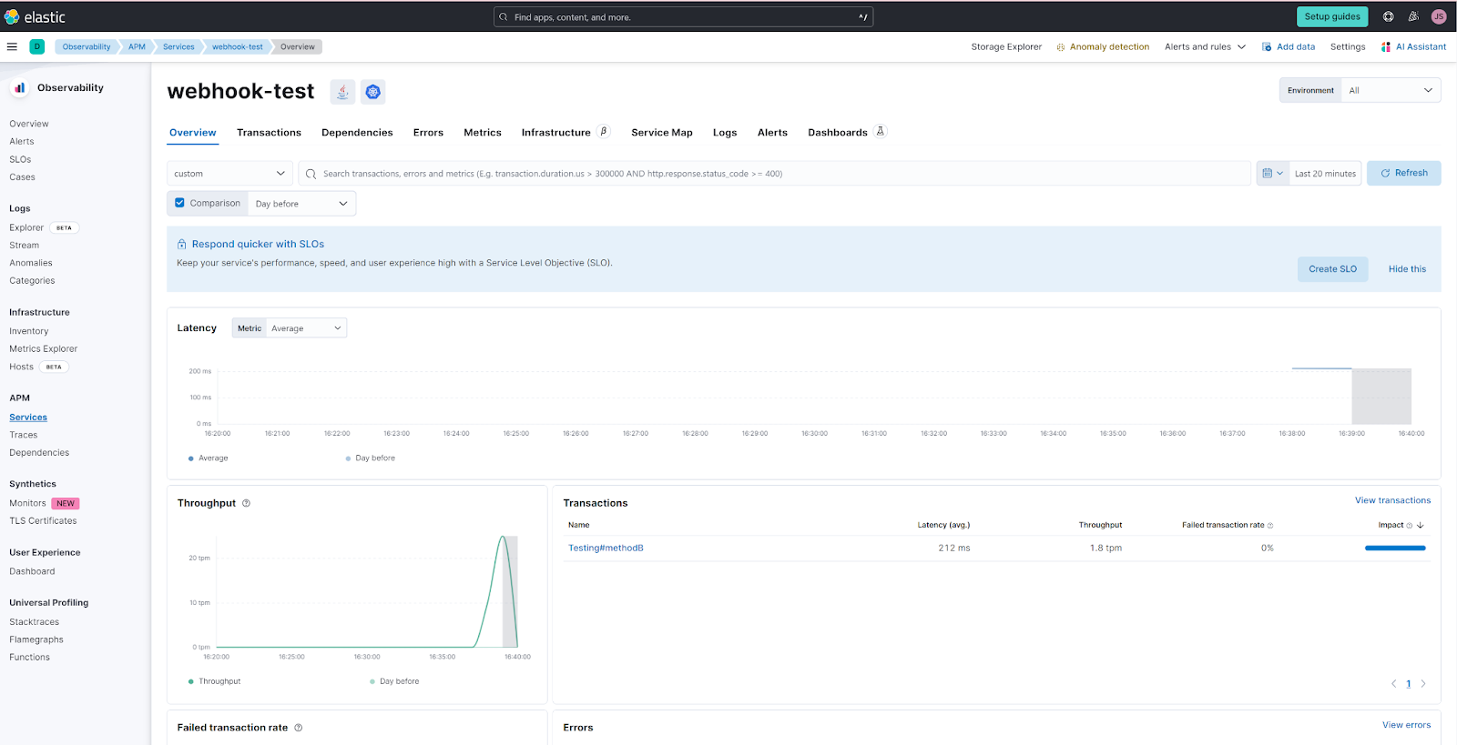

And since the agent is now feeding data to our APM server, we can now see it in the UI:
Note that the agent identifies Testing.methodB method as a trace root because of the ELASTIC_APM_TRACE_METHODS environment variable set to test.Testing#methodB in the custom.yaml — this tells the agent to specifically trace that method. The time taken by that method will be available in the UI for each invocation, but we don’t see the sub-methods . . . currently. In the next section, we’ll see how easy it is to customize the Attacher, and in doing so we’ll see more detail about the method chain being executed in the application.

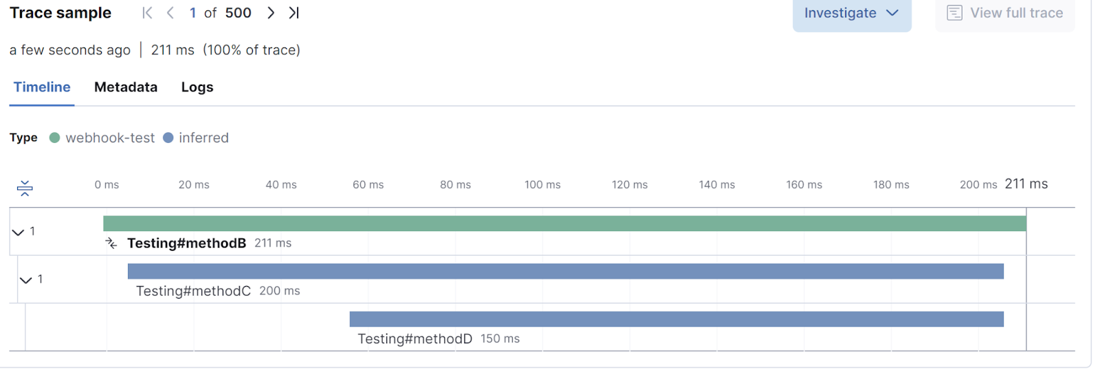

More interesting is the UI. Now that inferred spans is on, the full method chain is visible.
This gives the details for methodB (it takes 211 milliseconds because it calls methodC - 10ms - which calls methodD - 200ms). The times for methodC and methodD are inferred rather than recorded, (inferred rather than traced — if you needed accurate times you would instead add the methods to trace_methods and have them traced too).
