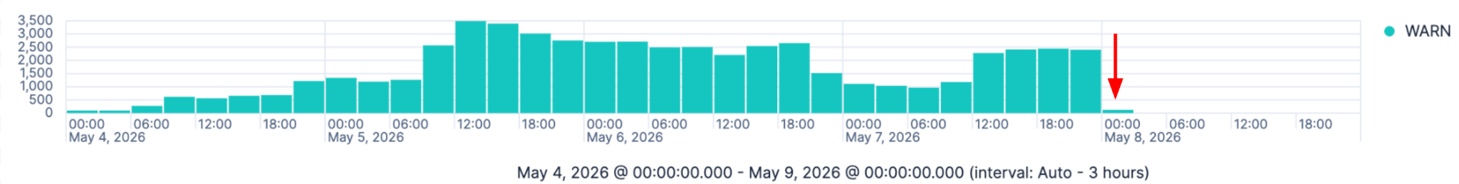

Clusters typically scale out because they're already under heavy load. Blocking shard relocations at that moment limits the cluster's ability to reduce pressure, which shows up as degraded indexing throughput and higher latency. The resource imbalance can also trigger unexpected autoscaling behavior. And even when overall topology stays the same, shard locking disrupts hotspot mitigation and workload distribution. These failures used to surface as server-side warnings: "undesired allocation due to snapshot."

After stateless snapshots shipped, the server-side "undesired allocation due to snapshot" warnings stopped. The chart below shows the before and after, with the release marked by the red arrow. Hotspot mitigation became more responsive because shard relocations no longer had to wait for backup operations.

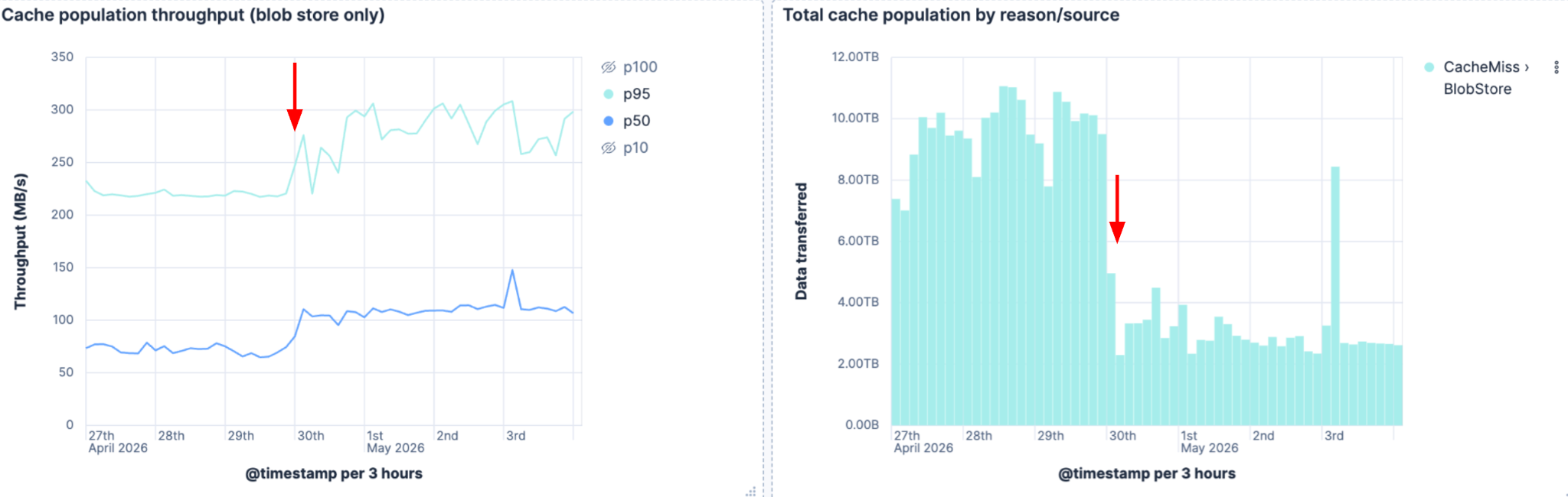

Cache use is also improved. Snapshots that bypass local shard data stop competing with indexing for cache space. After the release (also marked in the chart), we observed the following two positive changes in cache metrics:
  1. The median cache population throughput, defined as bytes per second for filling the local disk cache from the object store, increased about 50%.
  2. Cache misses, where data must be retrieved from the object store to fill local disk cache, have dropped more than 60%.
