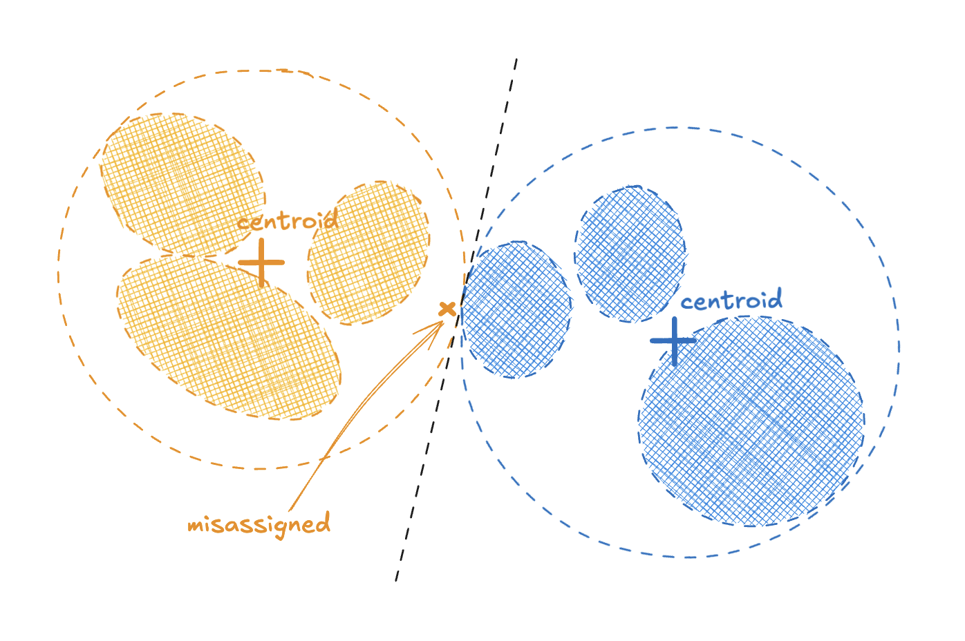

There is a small snag with hierarchical clustering. Vectors are first assigned based on coarse grained structure, which can prevent them winding up in their most appropriate fine grained cluster. This sort of problem is illustrated in the figure below.
Figure 1 - a problem case for hierarchical clustering

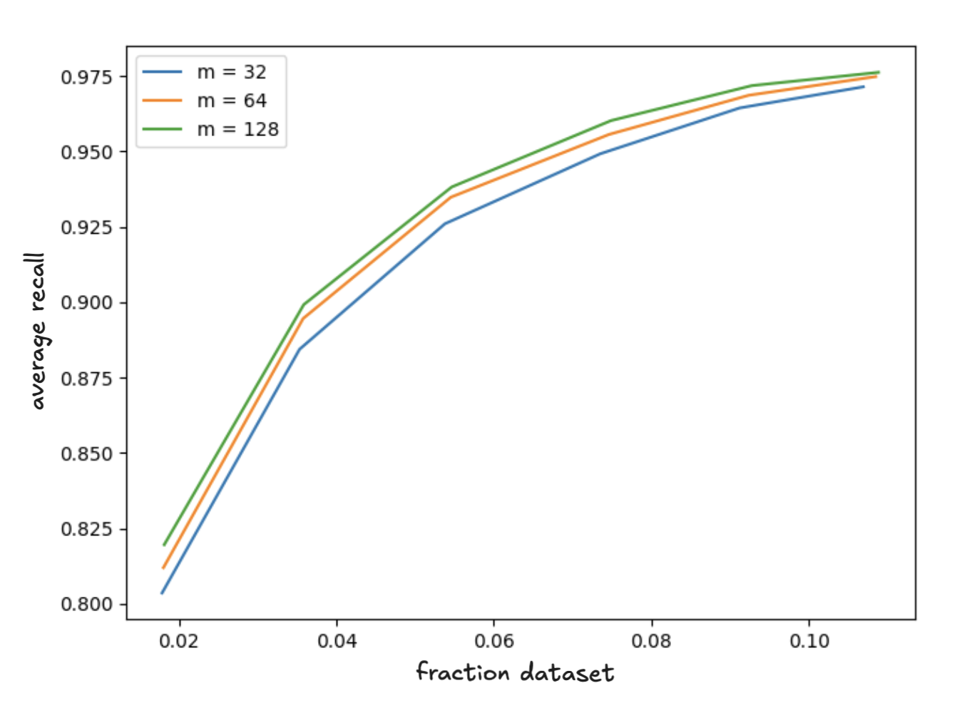

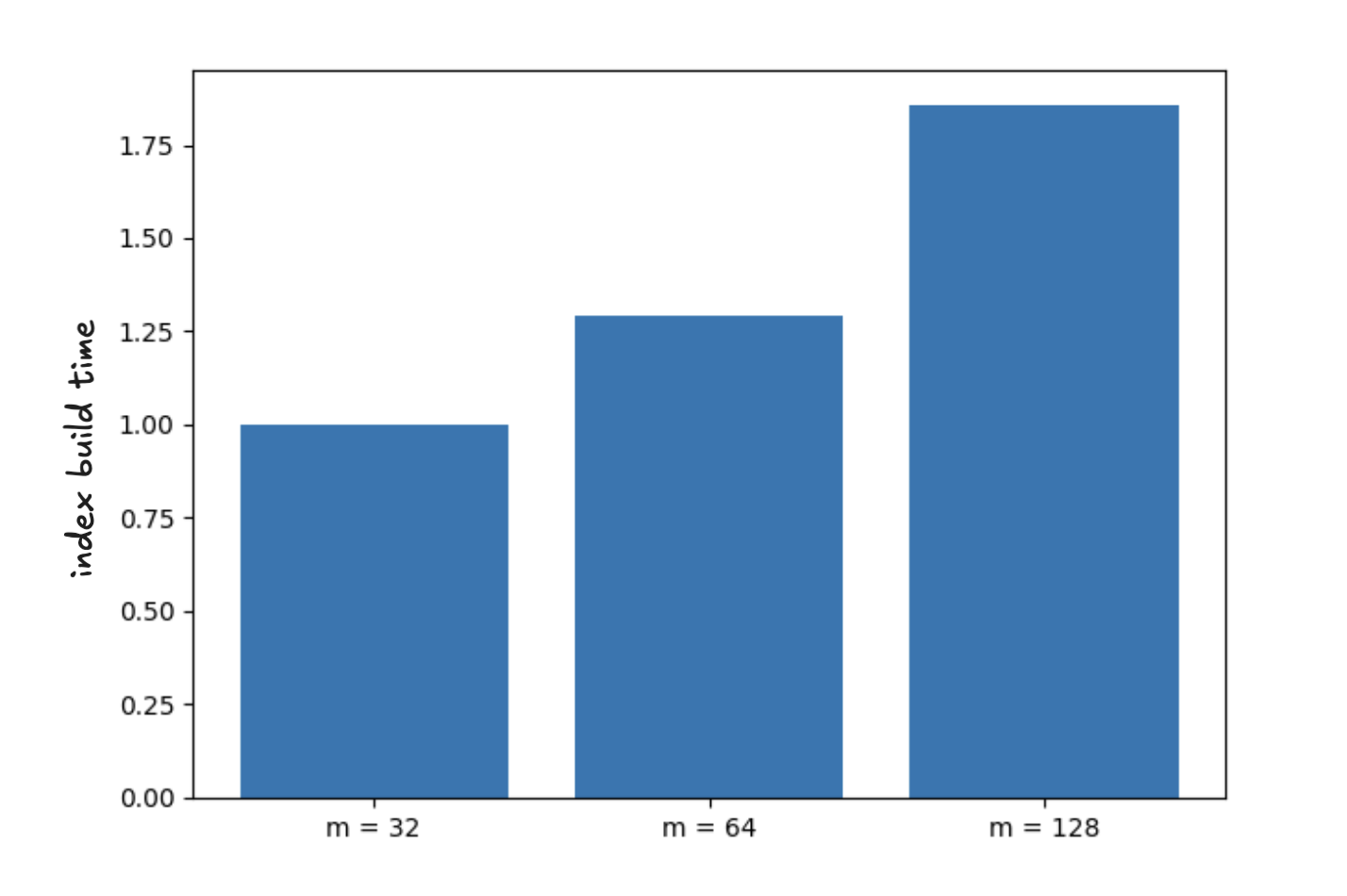

Our first observation is that of all parameters we explored the one which most consistently affects index quality in the context of SOAR is size of the neighborhood mm. If you want to spend build time to improve index quality increase this parameter; however, note it does show diminishing returns. We found the m equal to 128128 achieves nearly optimal quality while still yielding very significant runtime improvements. The overhead computing spill assignments with this choice is around 20% of the total build time. The figures below show the average recall as a function of latency and the relative time to build the index for m∈{32,64,128}m \in \{32,64,128\}.
Figure 2 - average recall versus latency for our test suite as a function of the neighborhood size
Figure 3 - average build time as a function of neighborhood size normalized to m=32

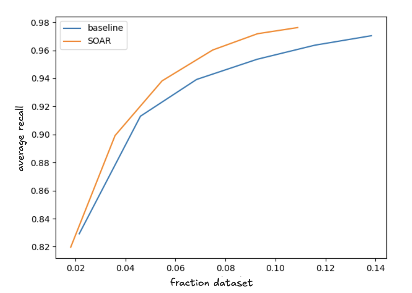

The figure below shows the average recall versus the number of vector comparisons. We normalize the comparison counts on the X-axis, expressing it as the fraction of the dataset the query is compared to, and average over all ten datasets. Since SOAR nearly doubles cluster sizes we compared to the baseline by retrieving roughly half the number of clusters. In fact, we don’t expect the latency to double because:
  1. We can cache vector comparisons so don’t pay extra cost for any vector that is duplicated in the clusters we compare to the query vector.
  2. We can use fast quantized vector comparisons to extract a subset of candidates to rescore. Rescoring requires relatively expensive floating point vector load and comparison operations that we don’t expect to double with SOAR.
In any case, the graph clearly shows that just measuring latency in terms of vector comparisons SOAR Pareto dominates the baseline achieving better recall at all latencies.
Figure 4 - comparing accelerated SOAR with clustering only

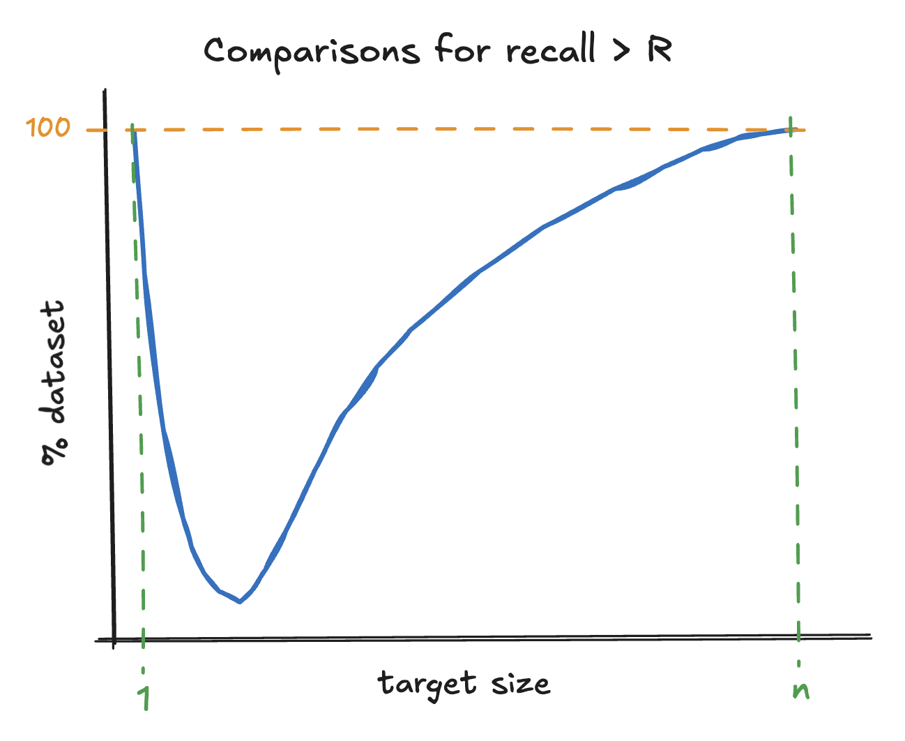

Finally, we discuss how to choose an appropriate value for the target cluster size. For IVF the goal is not to describe the true clusters present in the data, rather to minimize the number of vector comparisons needed to find the nearest neighbors of a query. There is a tradeoff at play: how many centroids you need to compare to find a candidate set of clusters versus how large the candidate set needs to be to achieve a desired recall. In the limit there is one vector per cluster then finding the closest centroid requires you to check every vector in the index, but the recall is always one. In the limit there is one cluster you have to check every vector in the index to resolve the nearest neighbors from that cluster, again the recall is always one. Assuming brute force centroid search, as one increases the target cluster size tt the number of centroids to check is n/tn/t, while to achieve acceptable recall RR the number of clusters you need to check is some monotonic increasing function mR(t)m_R(t). Therefore, the total number of comparisons is cR(t)=n/t+mR(t)tc_R(t)=n/t+m_R(t)t. Schematically, this will look something like the following.
Figure 5 - illustration of IVF index quality as a function of target cluster size (a smaller percentage to achieve recall R is better)
The exact form of mR(t)m_R(t) depends on the data characteristics and the required recall. The overall query latency will also depend on the centroid search procedure. However, this is only part of the story. Another critical consideration is that cluster size impacts disk friendliness: smaller clusters increase random I/O. Ultimately, optimal query latency will also depend on the memory constraints one operates under.

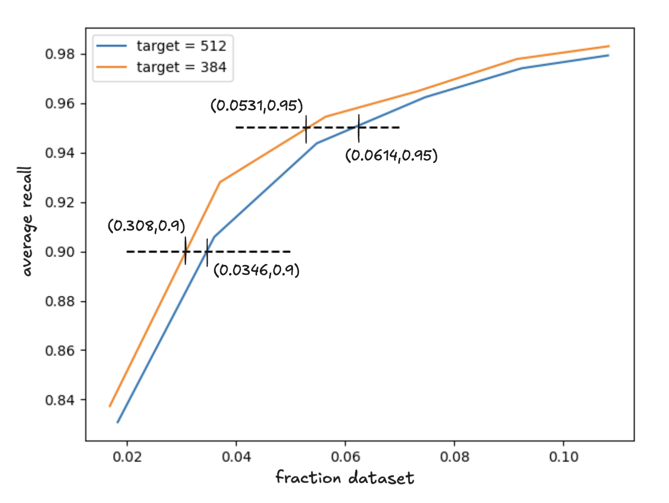

Since our methods are efficient even for high cluster counts we can explore lower values of target size. In order to maintain acceptable disk friendliness, our expectation is that the optimal cluster sizes will be in the low hundreds and smaller for higher recalls.
In a non-memory constrained setting, we evaluated t∈{384,512}t \in \{384,512\}. The recall curves are shown below.
Figure 6 - average recall as a function latency for target cluster sizes 384 and 512
As expected the recall curve for t=384t=384 dominates t=512t=512 given the candidate set; however, we know that this does not necessarily translate to a net performance improvement because of the cost of finding this set.
For recall R=0.9R=0.9, 384×m0.9(384)/n=0.0308384 \times m_{0.9}(384) / n=0.0308 and 512×m0.9(512)/n=0.0346512 \times m_{0.9}(512) / n=0.0346 so
c0.9(384)c0.9(512)×100%=(1/384+0.0308)n(1/512+0.0346)n×100%=94%\frac{c_{0.9}(384)}{c_{0.9}(512)} \times 100 \%=\frac{(1/384+0.0308)n}{(1/512+0.0346)n} \times 100 \%=94\%
For recall R=0.95R=0.95, 384×m0.95(384)/n=0.0531384 \times m_{0.95}(384) / n=0.0531 and 512×m0.95(512)/n=0.0614512 \times m_{0.95}(512) / n=0.0614 so
c0.95(384)c0.95(512)×100%=(1/384+0.0531)n(1/512+0.0614)n×100%=88%\frac{c_{0.95}(384)}{c_{0.95}(512)} \times 100\%=\frac{(1/384+0.0531)n}{(1/512+0.0614)n} \times 100\%=88\%
In both cases t=384t=384 is a net win, by 6% and 12%, respectively. We plan to explore this further in the context of improved centroid search schemes to find a good default target cluster size in our final implementation.
