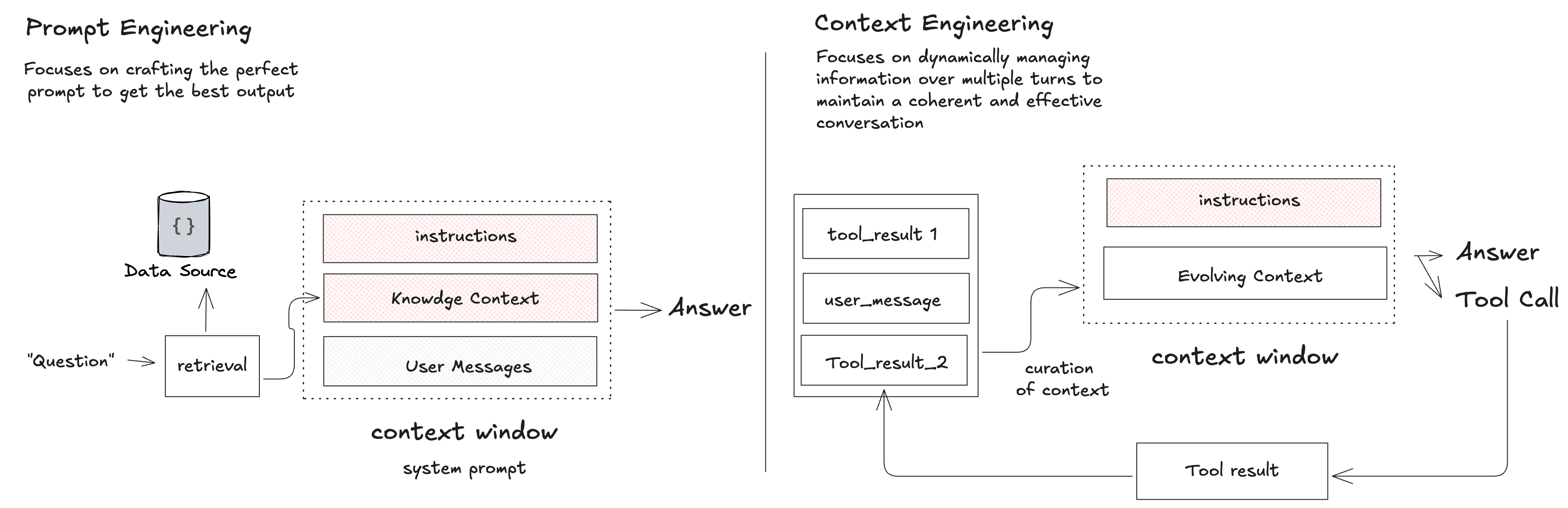

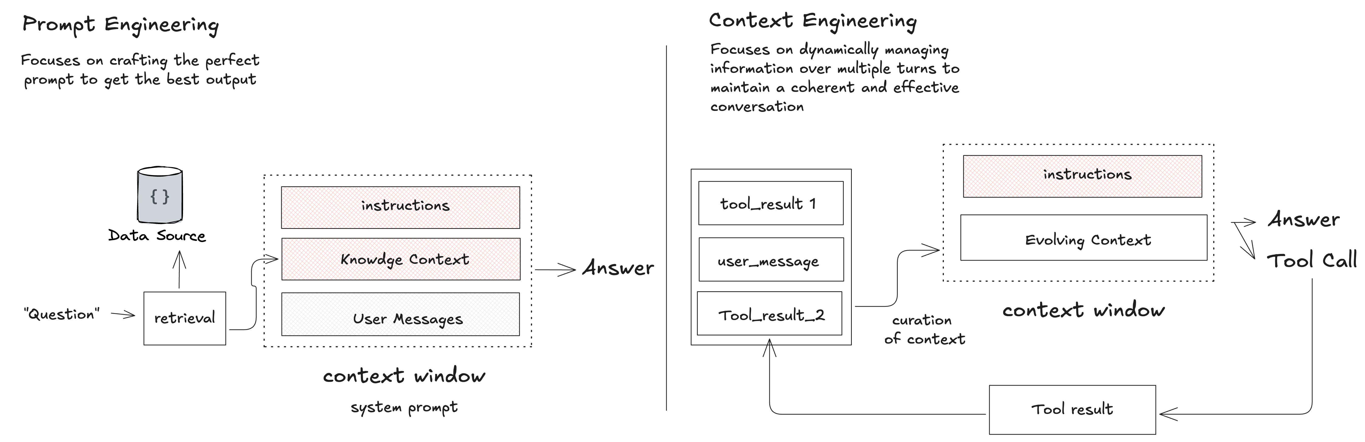

For the last few years, prompt engineering has dominated the conversation in AI. The focus was on finding the perfect words and phrasing to coax the right response from an LLM. But as we build more sophisticated AI agents designed to tackle multi-step, complex tasks, the focus is shifting, the topic moves towards challenges with managing context.
An LLM's context is like a human's short-term memory. Trying to stuff it with every potentially relevant piece of information is challenging. It leads to context rot, a concept where the model's 'attention budget' gets exhausted, causing it to lose focus and derail its own reasoning. For example, one recent "needle in a haystack" (NIAH) benchmark in NOLIMA: Long-Context Evaluation Beyond Literal Matching noted that performance "degrades significantly as context length increases," observing that at 32K tokens, "11 models drop below 50% of their strong short-length baselines." Inefficiency within the context window directly affects the agent's reliability.
The solution isn't just better prompts, but an emerging discipline: context engineering. It’s the art of managing the model's limited attention.
Beyond RAG: the shift to "just-in-time" context for AI agents
Previously, the standard approach was RAG, which involved a form of retrieval before inference, where all potentially relevant data was processed and fed into the system prompt upfront for it to reason over.
As reasoning models become more intelligent, cheaper, and better at handling long contexts, the trend is shifting toward agents that use tools for 'just-in-time' retrieval. This allows the agent to iteratively probe sources, breaking down and reformulating queries to adapt its search as it learns. Engineering focus shifts from exhaustive data pre-processing to equipping the agent with the right tools and honing its ability to discover and steer towards the most relevant context on its own.
Context engineering isn't just about the instructions we give an agent; it's about curating and managing the context window to the model at any given moment. When an agent runs in a loop, it generates a constantly evolving universe of information - user messages, tool outputs, and its own internal thoughts. Context engineering is the art and science of deciding what from that universe makes it into the agent's limited "working memory."

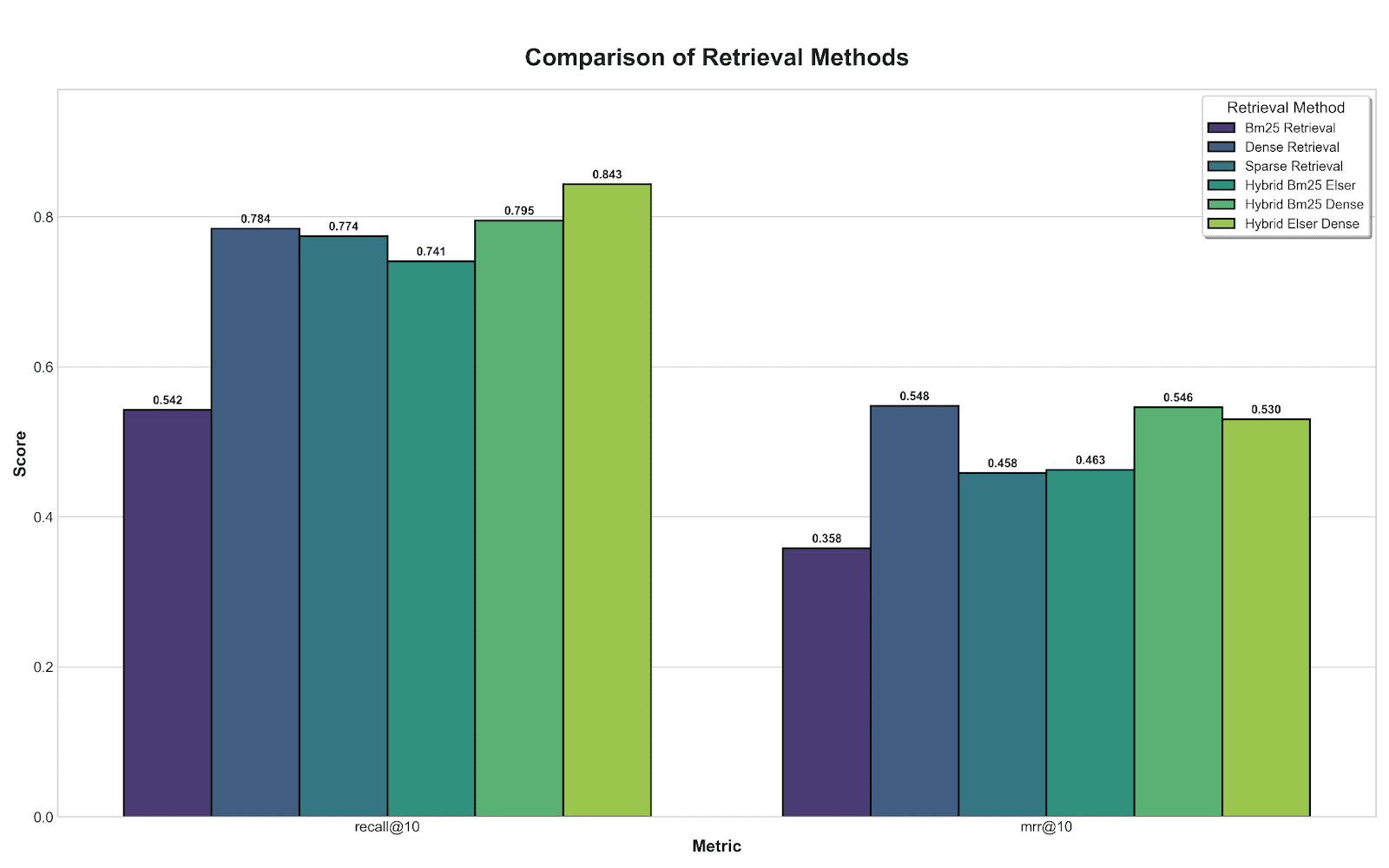

Comparison of different strategies using the recall@10 and mrr@10 metrics
In an internal benchmark of retrieval strategies we found that hybrid approaches often offer the best balance between IR metrics like Recall (Completeness) and MRR (Ranking). The chart demonstrates that a hybrid approach, combining sparse ELSER with dense vector search, successfully located 84.3% of all relevant documents within the top 10 results (Recall@10 of 0.843). Furthermore, the MRR of 0.53 indicates that the single most important document was, on average, found within the top 2 positions.

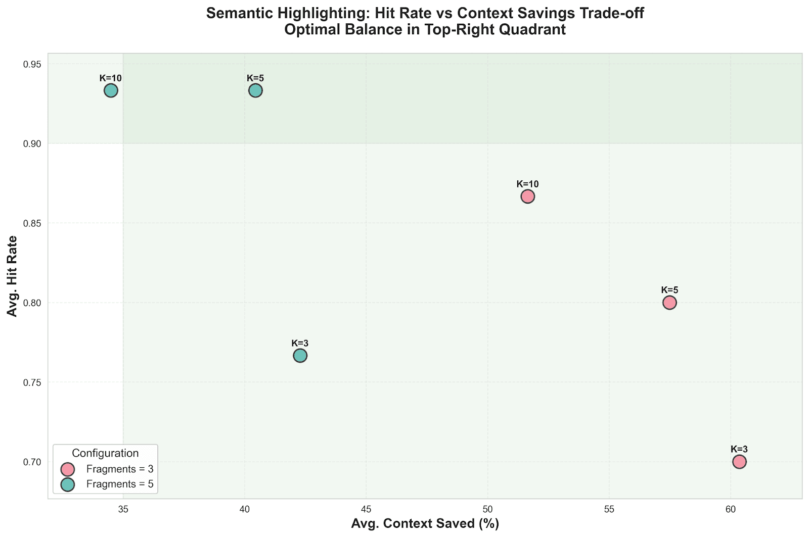

In another internal benchmark focused on long-context RAG, we evaluated how effective semantic highlighting is at retrieving the most relevant chunks from documents; reducing the need to pass entire documents to the agent. As shown in the chart, we experimented with different combinations of document counts and highlighted chunk counts, measuring their impact on retrieval accuracy (Hit Rate) and context efficiency. Hit Rate is a binary metric that indicates whether the agent received all the information necessary to complete its task.
For our dataset, the sweet spot was retrieving five semantic fragments from the top five documents (K=5). This setup allowed the agent to access all required information in 93.3% of cases, while reducing context size by over 40% significantly cutting down the agent’s processing load.

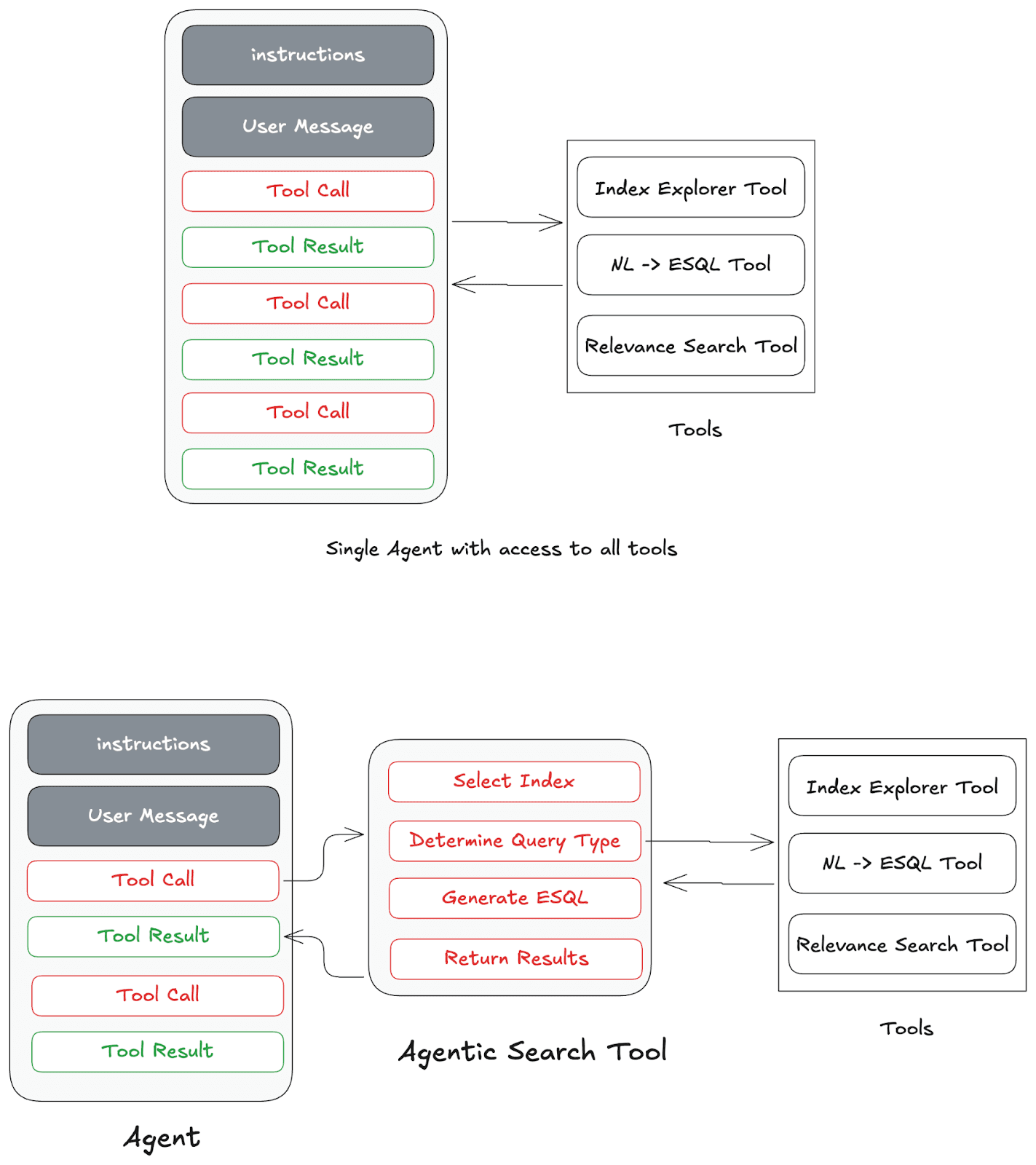

For more complex questions that require extensive exploration, a simple relevance search is insufficient. Answering these queries demands a deeper level of understanding that can only be achieved through a process of discovery and filtering. Traditional retrieval tools, often constrained by rigid query templates, lack the intelligence for this dynamic source selection and exploration. Instead, the agent needs to reason about the information it finds, filter out noise, and pursue new paths as insights emerge in an iterative loop.
To achieve this, we can leverage agent-based retrieval tools that operate outside the main agent's context window. This can be conceptualized as a specialized "sub-agent" architecture, as described in some multi-agent systems. This sub-agent is tasked with the intensive work of exploration. A core function is its ability to rewrite the main agent's high-level natural language request into a precise, structured query tailored for the selected data source. For example, it can translate a user's question into a specific ES|QL query to retrieve relevant content from an Elasticsearch index or datastream. The entire back-and-forth of discovery, reasoning, and filtering occurs within this sub-agent's separate context. It then returns the results or aggregations, keeping the main agent's "working memory" clean and allowing it to focus on the high-level plan.
This strategy is adaptable across different types of agents:
  • A coding agent tasked with a complex search can use a search sub-agent to explore a large codebase. This sub-agent would spend its cycles grepping through folders, searching code chunk embeddings, and tracing dependencies to find a particular file or function. Instead of returning thousands of lines of raw code, it delivers a concise summary of the relevant file paths and code snippets.
  • A knowledge agent researching a topic can use a sub-agent to sift through a vast document store. It would autonomously explore the data, disregard documents that aren't useful, and synthesize the key findings from multiple sources. The main agent then receives a curated summary of highlights, rather than the full text of every retrieved document.

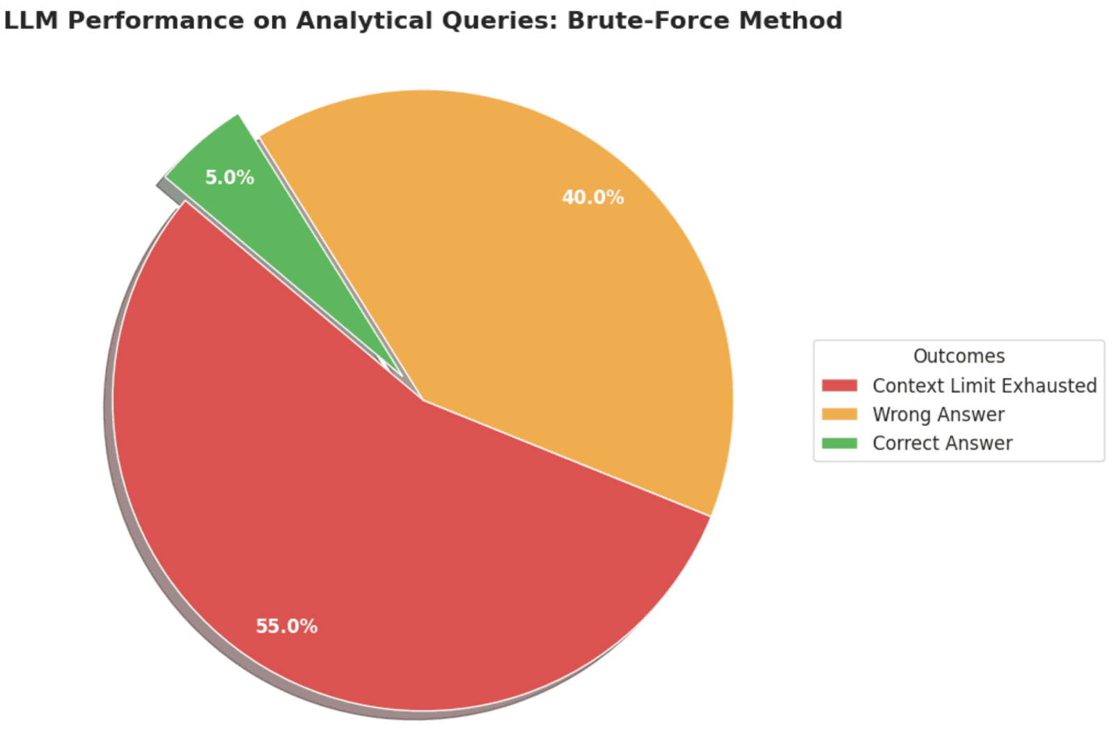

In an internal experiment, we compared two approaches for answering analytical questions like, “Today is Jul 8 2025. How many support tickets were created in the last 365 days and how many of those are still open”. To answer this question, the LLM had to filter a small index of 360 records and 12 fields (including text, date, and integer types) by the date column and then count the number of tickets by their status to provide the necessary information.
1. The Brute-Force Method: This involved feeding the entire CSV directly into a state-of-the-art LLM's context window.
2. The Agentic Method: This approach provided an agent with a tool capable of translating natural language into a precise ES|QL query which was then run against an index containing the CSV. The findings, illustrated in the chart above, highlight that LLMs, when given the entire index as context, experienced catastrophic failure in most cases. In contrast, the agent, equipped with the ES|QL tool, achieved a 100% success rate.
