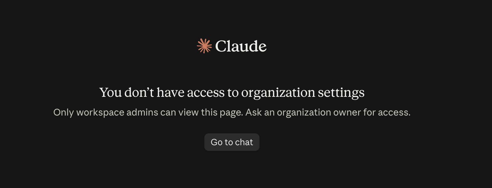

We went through the above and made sure that we addressed everything on the checklist. But when I tried to submit the plugin at https://claude.ai/directory/manage, I got the following message:

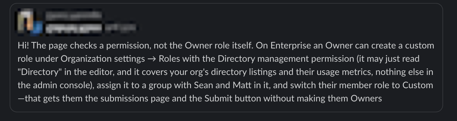

I’m an engineer. An individual contributor. I have no business being an “owner” of an account for a software tool used by most Elastic employees. But the IT team that owns it wouldn’t be maintaining and supporting this external-facing plugin.
This was our first bit of friction, but it also led to our first lesson, namely, if you have a contact at Anthropic, make use of them. Elastic had already established a partnership with Anthropic, so when we hit this issue, we simply messaged our point of contact, who quickly got back to us:

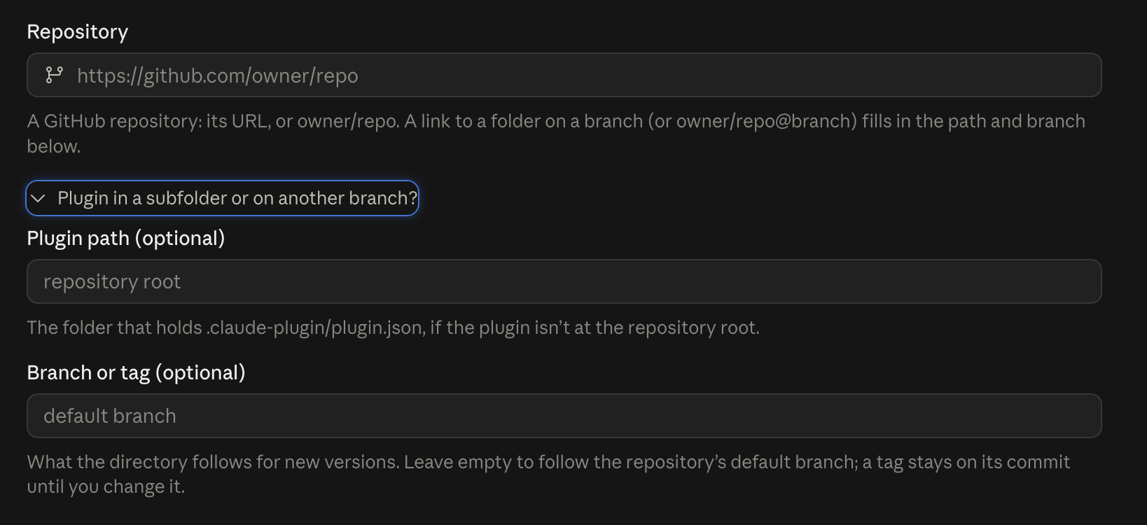

Once we had the right permissions, it was relatively straightforward to fill out the submission form:
Despite the simplicity, this is where we made our first two mistakes.
Choosing your plugin path: Why not the repository root
As the screenshot above shows, this is the folder where Anthropic will look for your .claude-plugin/plugin.json. It’s also the root of what Anthropic’s automated systems will be scanning.
We started with the default repository root for our plugin path, but this was a mistake, because the files for our own internal development purposes were also at the repository root. They included the CLAUDE.md that our engineers could use to maintain the plugin, along with our continuous integration (CI) pipelines, tests, and package-lock.json.
Scanning those files can lead to unexpected holdups during verification:
We should note that the Anthropic team didn’t let this be a blocker and, after manual review, waived these warnings.

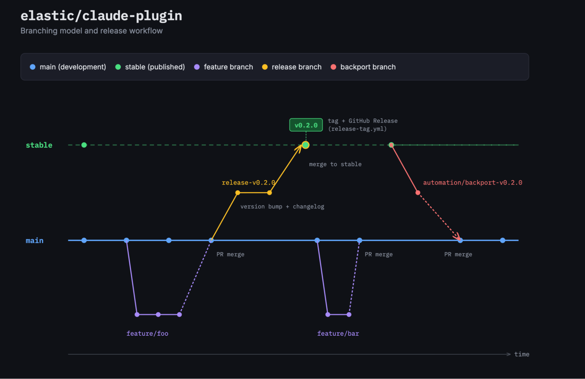

There’s no single “right” way to version or release software. But at Elastic, we often stick to the following conventions:
  • Development is done on feature branches (sometimes in forks).
  • Pull requests (PRs) target main.
  • Versioning uses SemVer (MAJOR.MINOR.PATCH).
  • Releases are cut from release branches (MAJOR.MINOR) and tagged (vMAJOR.MINOR.PATCH).

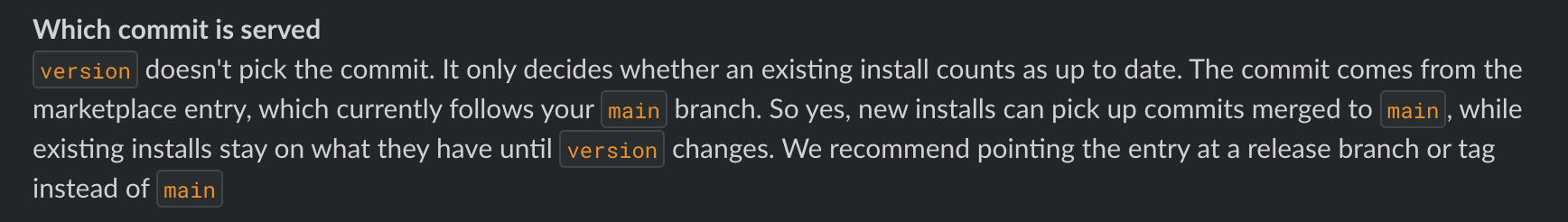

On my initial read of Claude’s plugin versioning documentation, I knew that we’d need a different system for this repo. We only have one live version at once, rather than maintaining multiple majors and minors. So we planned to just use main with a specific version in the plugin metadata. We’d merge PRs into main, as normal, and when ready to release, we’d bump that version and create a Git tag. Easy.

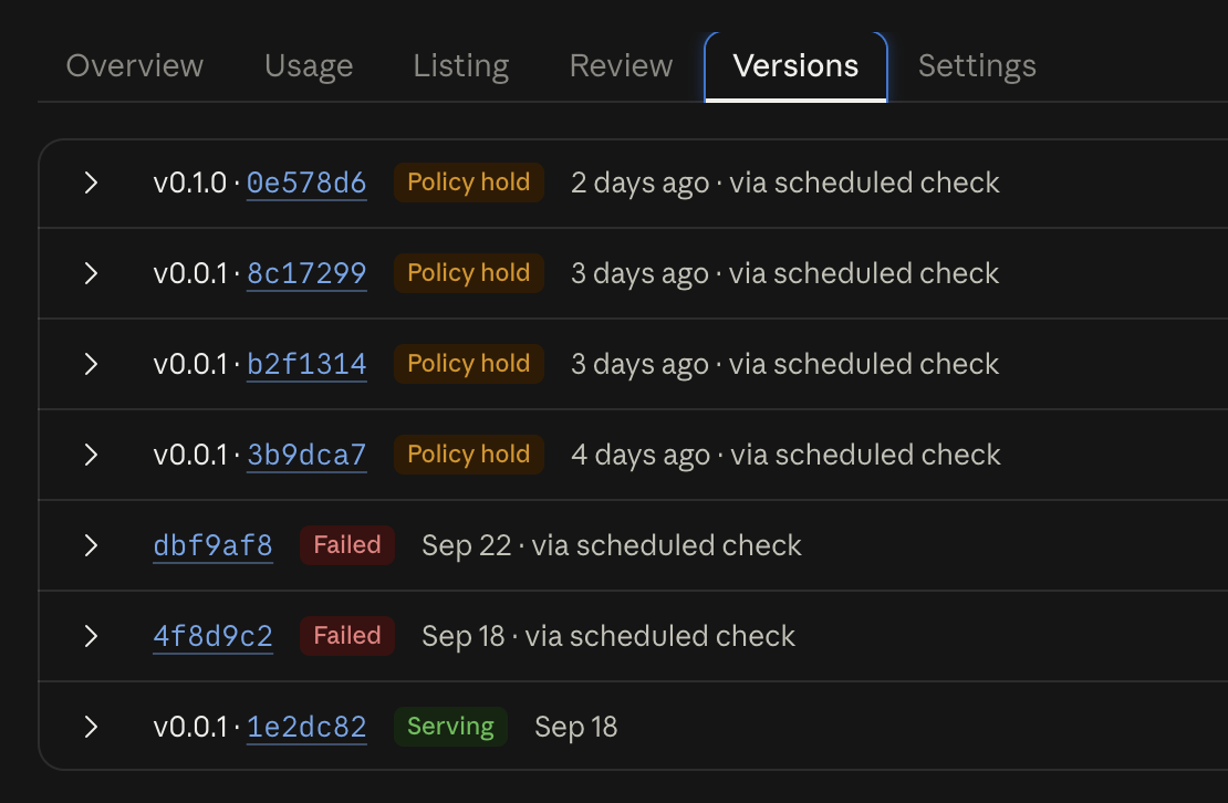

But that’s not how it works:
That initial approach actually led to many v0.0.1 “versions” of the plugin, one for each merge commit.
With help from our Anthropic contacts (the astute reader will notice that this is a theme), we got the following clarification:
After realizing this, we changed our plugin to point at a dedicated stable branch. Now we can merge to main as normal but only merge main into stable when we’re ready to release a batch of changes and update our version number. This results in our flow looking like:

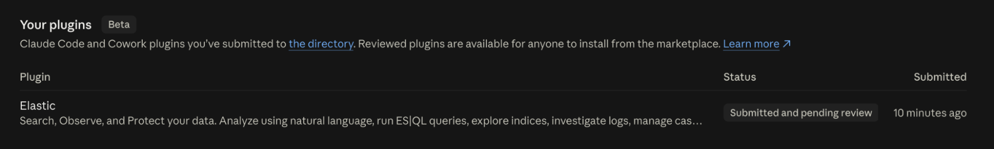

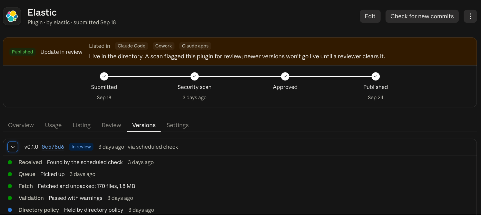

When we first submitted, we saw only the following:
While we were in the process of writing this blog, Anthropic made some changes to its UI, providing a bit more visibility. Now the submissions UI looks more like this:
Even so, the review of our first plugin submission took about a week, and that may have been faster than normal as a result of our direct line of contact with Anthropic solution architects and account executives (to stress again how valuable that relationship has been). We were given a rough estimate of nine days for average review time.

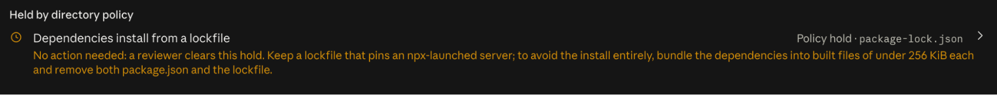

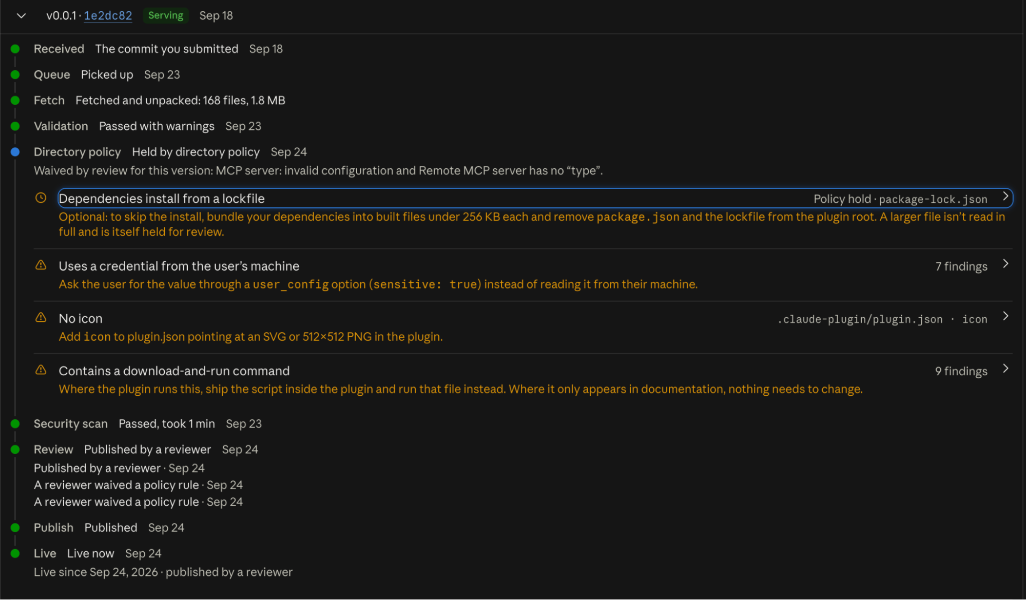

We couldn’t see it then, but we later learned that part of the holdup was that our submission raised a number of warnings to the Anthropic review team:
Policy warnings from the automated review
In retrospect, the extra visibility is nice; but, at the time, I might have ended up making a bunch of unnecessary changes. The Anthropic team ultimately waived all of these warnings. The takeaway here is to wait for a call to action from the reviewer, rather than jumping straight into trying to resolve every policy warning, even if they sound serious.
Warning
What triggered it
Resolution
Uses a credential from the user’s machine
Example curl commands with credentials templated as environment variables.
Waived after manual review. False positive.
No icon
The icon field was undocumented at submission time, and claude plugin validate --strict passed without it.
Waived. The field is now documented.
Contains a download-and-run command
Skill directives instructing an agent to call an API and interpret the response.

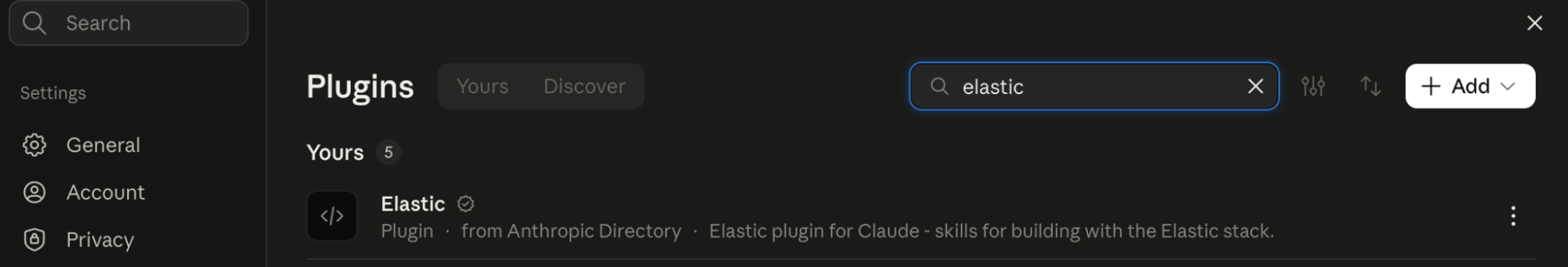

Surprise: Your Claude plugin is live
When Anthropic concluded its review, the plugin was immediately visible. This didn’t require an extra confirmation step from us, and there was no staging area. We also received no notification that it was live. This truly surprised us. Our plugin was published late on a Thursday, but I didn’t check on it on Friday. Only on the following Monday did we realize that it was live and visible. In our case, no harm done (the skills had been public for months already), but for anyone who’s not shipping something battle-hardened, be sure to do your testing before submitting.

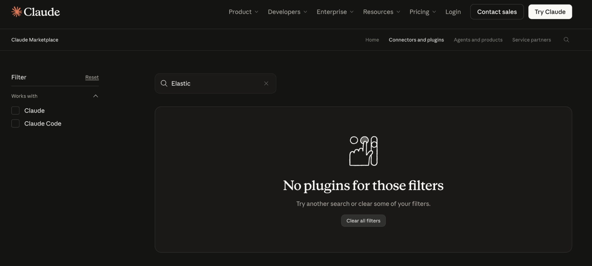

Publishing doesn’t get you into every Claude directory. There are at least four places where a developer might look for plugins:
Directory
Visible on publish?
How to get in
Claude app’s Setting > Plugins > Discover UI
Yes
Submit your plugin at https://claude.ai/directory/manage.
Claude Marketplace (https://claude.com/plugins, https://claude.com/marketplace)
No
Verification process done separately by Anthropic, after publishing.
anthropics/claude-plugins-community repo
No
Curation process done separately by Anthropic, after publishing.
anthropics/claude-plugins-official repo
No
Partner plugins can be listed through Anthropic contact.

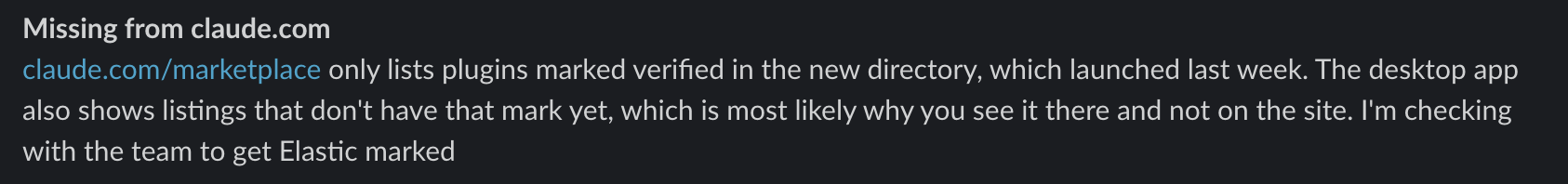

When it’s initially published, your plugin only appears in the Anthropic directory in an unverified state, labeled as “Community.” And this is only if your license or account isn’t configured to exclude unverified plugins. This caused some initial confusion internally (our IT department has Claude Enterprise set up to hide “Community” plugins); we could only see our own plugin when we weren’t logged in with our work accounts.
To get into the other directories and marketplaces, the plugin needs to go through a separate “verification” or “marking” process. Once again, DMs with Anthropic partners proved very helpful:
