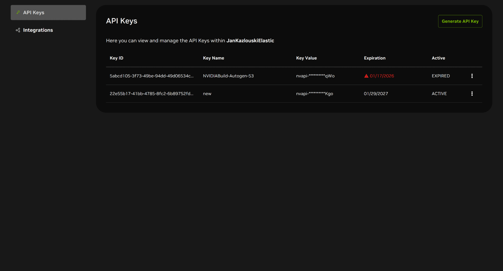

To get started quickly, you’ll first need access to NVIDIA’s model catalog and APIs. Create an account or log in at https://www.build.nvidia.com/ to explore available models, evaluate their capabilities, and compare which ones best fit your use case before proceeding toward full-scale deployment. This site provides a web-based interface for testing models, which is useful during evaluation and experimentation. For production-level requirements, you can use NVIDIA NIM to deploy endpoints on your own infrastructure.
To access NVIDIA models, you need to generate an API key. This key will serve as the authorization mechanism when making calls to NVIDIA's endpoints. You can create, access, and manage your API keys at API keys. To create a new key, click the Generate API Key link in the top right, and then specify a name and expiration period for the key. After generating the API key, select the appropriate model for your task and set up the corresponding Elasticsearch inference endpoint.

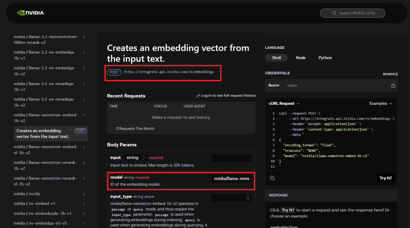

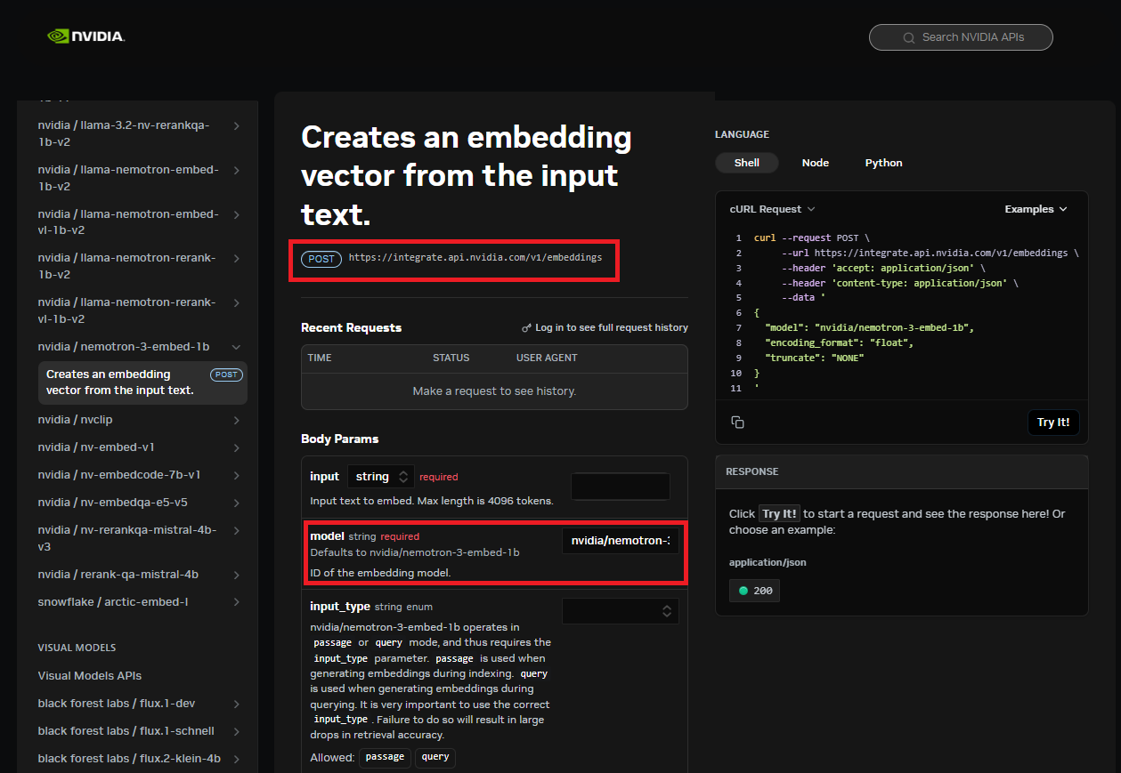

To create a text embedding inference endpoint, you first select an appropriate model that can perform embedding operations. NVIDIA lists its models in the NVIDIA Build model catalog. You can select the Text-to-Embedding or Retrieval Augmented Generation use case on the left to filter the appropriate models. You can also find NVIDIA’s text embedding models in the NVIDIA documentation. NVIDIA’s retrieval APIs include text embedding and reranking models. When choosing a model, make sure it explicitly supports text embedding inference. Text embedding models typically include an API description, such as "Creates an embedding vector from the input text."
A good example of an embedding model is the nvidia/nemotron-3-embed-1b model. You can access the deployment page for this model, which allows you to deploy this model on-premises.
Once you have selected a suitable model, open its API reference page, where you’ll find the parameters required to create an Elasticsearch inference endpoint.
Two parameters are relevant:
  • model_id (required): Specifies the NVIDIA model to be used for embedding inference. This parameter is named model on the NVIDIA side.
  • url (optional): The endpoint URL used to send requests to the NVIDIA model (either deployed on-premises or in a serverless environment). It must be accessible from your Elasticsearch instance.
For most text embedding models, the URL is static and NVIDIA differentiates models solely via the model parameter. If the url parameter isn’t provided during endpoint creation, the default text embedding task specific value https://integrate.api.nvidia.com/v1/embeddings will be used.

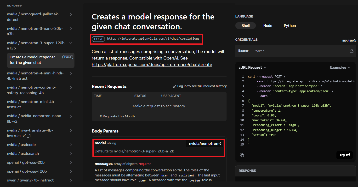

To create a completion inference endpoint, you first select an appropriate model.
NVIDIA lists its models in the NVIDIA Build model catalog. You can search for the model there, but you can also find NVIDIA’s completion models in the left-hand navigation of this large language model (LLM) API documentation.Each entry in the list links to a general description of the model. From there, you can navigate to a nested link that opens the API reference specific to the selected model. A good example of a completion model is the nvidia/nemotron-3-super-120b-a12b model. You can access the deployment page for this model, which allows you to deploy this model on-premises.
Once you have selected a suitable model, open its API reference page, where you’ll find the parameters required to successfully create an Elasticsearch inference endpoint.
  • model_id (required): Specifies the NVIDIA model to be used for completion inference. This parameter is named model on the NVIDIA side.
For most completion models, the URL is static, and NVIDIA differentiates between models using only the model parameter. If the url parameter isn’t specified during endpoint creation, the default value of https://integrate.api.nvidia.com/v1/chat/completions will be used.

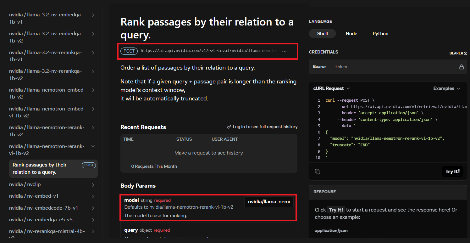

To create a rerank inference endpoint, you first select an appropriate model that can perform reranking operations. NVIDIA lists its models in the NVIDIA Build model catalog. You can use the reranking label to select the appropriate models. You can also find NVIDIA’s reranking models in the left-hand navigation of this retrieval APIs documentation. NVIDIA includes reranking and text embedding models in the Retrieval APIs section in its API documentation. When selecting a model, ensure that it explicitly supports rerank inference requests. Rerank models typically include an API description, such as “Ranks passages by their relation to a query.” This wording indicates that the model supports the rerank task type.
A good example of a reranking model is the nvidia/llama-nemotron-rerank-vl-1b-v2. You can access the deployment page for this model, which allows you to deploy this model on-premises.
Once you have selected a suitable model, open its API reference page, where you’ll find the parameters required to create an Elasticsearch inference endpoint. Two parameters are relevant:
  • model_id (required): Specifies the NVIDIA model to be used for rerank inference.
  • url (optional): The endpoint URL used by the inference endpoint to send requests to the NVIDIA service.
For most models, the URL is static and NVIDIA differentiates between models using only the model parameter. If the url parameter isn’t specified during endpoint creation, the default value
https://ai.api.nvidia.com/v1/retrieval/nvidia/reranking will be used. The nvidia/llama-nemotron-rerank-vl-1b-v2 model requires a custom URL to be specified, and it will be used in the example below.
